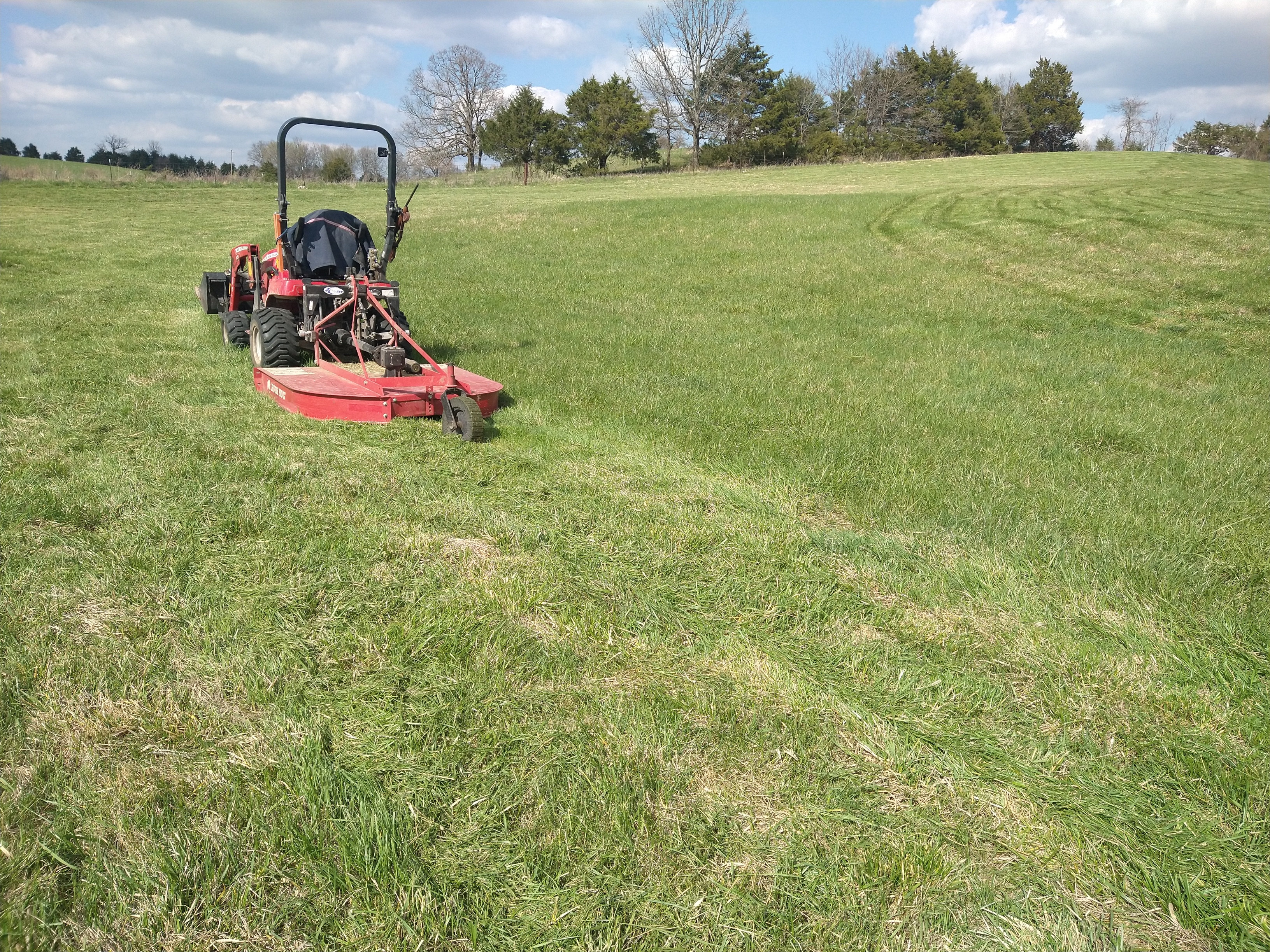

I once used a 6' Bush Hog Squealer behind a Kubota L3200 (31 or so HP, less at the PTO) and found that at times, it would struggle in heavy vegetation. Not saplings but thick, tall grass. By struggling, I mean that on some occasions, I had to make a half cut rather than a full cut or the tractor would bog down and cut off. I eventually sold the Bush Hog to a neighbor who has a 47 HP Kubota and sold the tractor to fund a newer tractor.
Now, I am using a 5' John Deere rotary cutter behind a Kubota L3302 and have no difficulty in the same vegetation. I don't think there is significant difference in the horsepower of the L3200 and the L3302, rather, I think the rotary cutter is more appropriately sized for a tractor with horsepower in the low 30's range.
I would suggest that if you wish to use a 6' rotary cutter, I would look for a tractor in the upper 30 HP range at a minimum or even better, a tractor in the low to mid 40 HP range.
