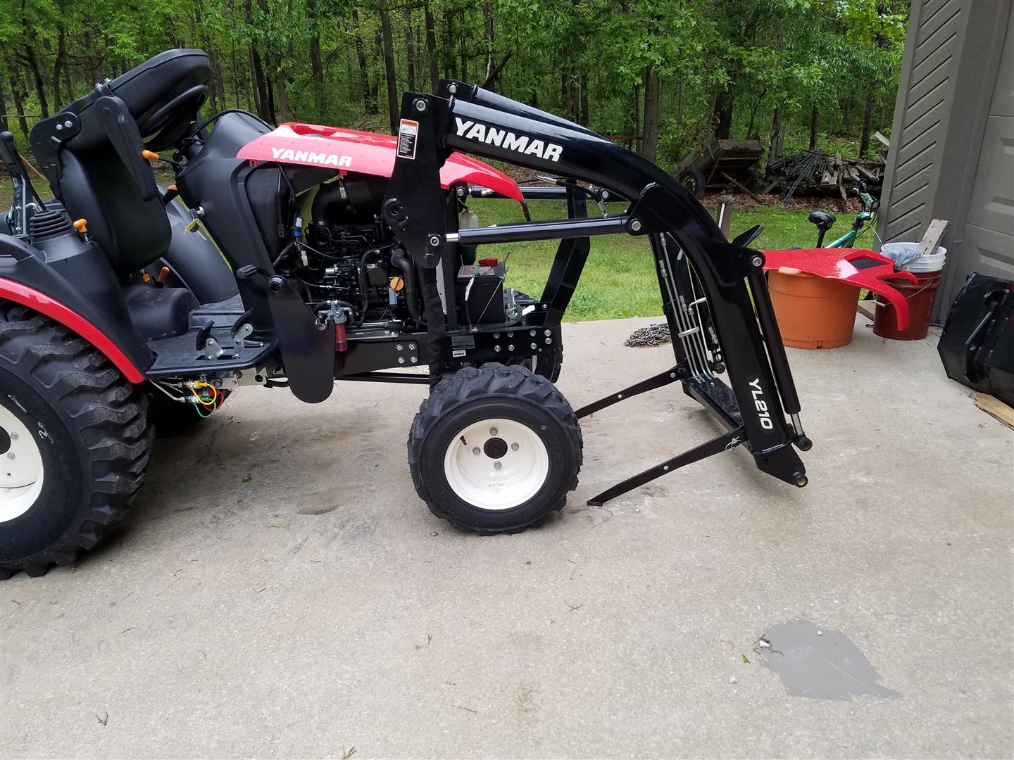

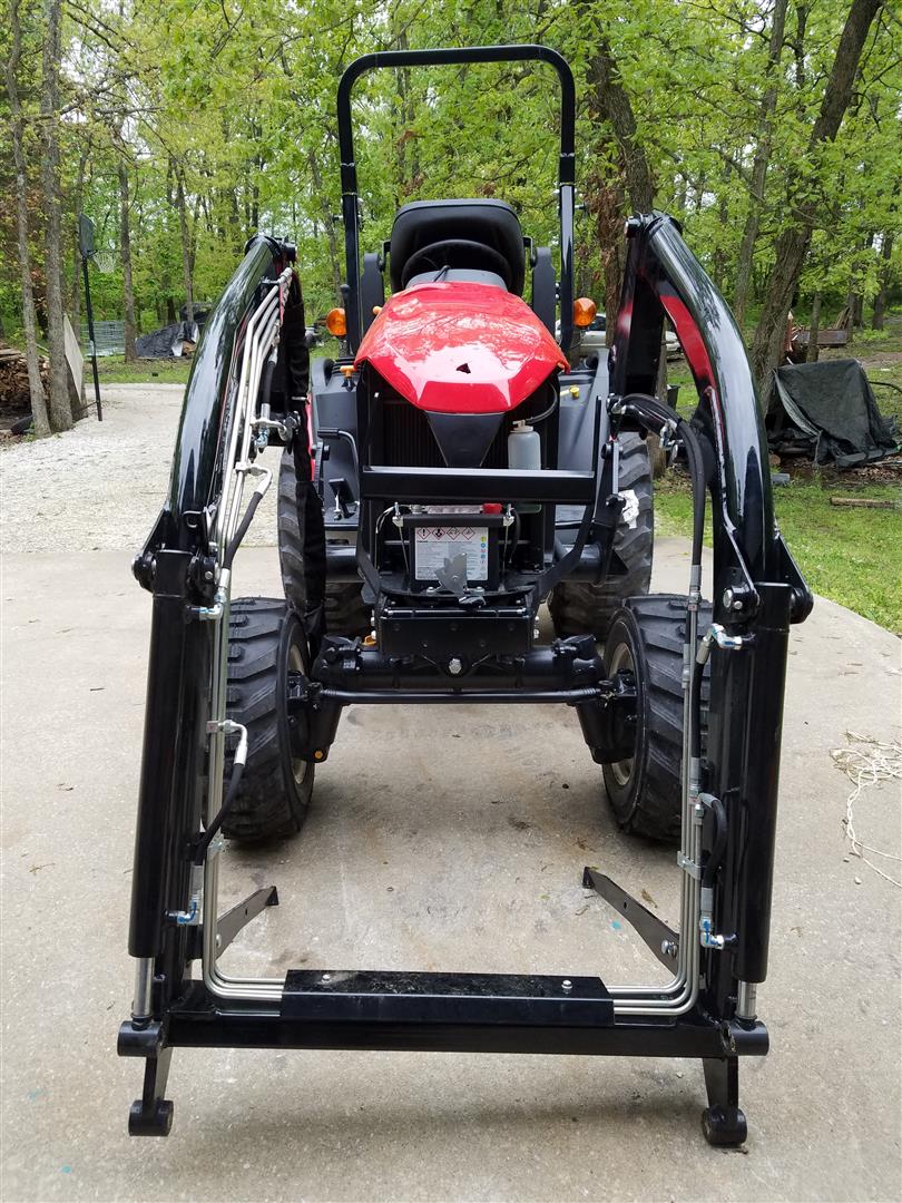

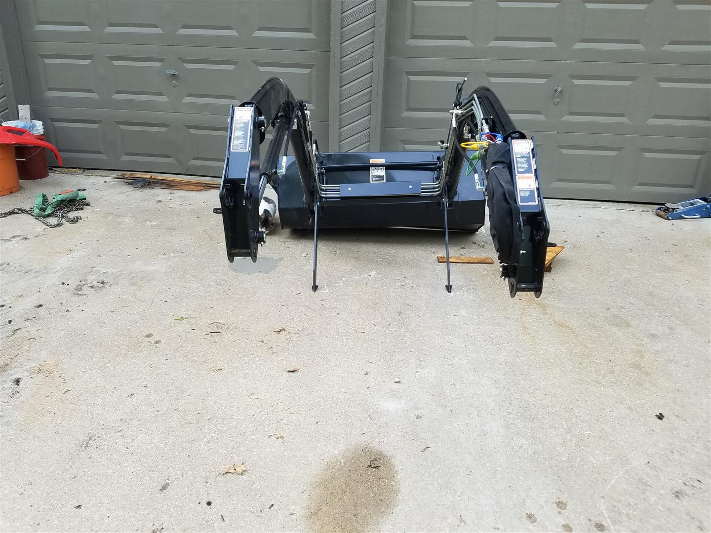

I bought this tractor from an insurance auction and the last thing I need to do to make this tractor 'perfect' is straighten the boom. A car veered off the road and hit the bucket which in turn twisted the boom. Any suggestions on trying to twist this loader boom back? Thanks!

I would chain the high side to a stump and raise the loader. Maybe the hydraulics will be strong enough to twist it. You may have to chain a long piece of heavy steel or a log crossways and chain to the stump some distance to the side of the loader frame.
If you want to get tricky you could reverse the hoses on the lift cylinder on the high side, so it's pulling down while the other one is pushing up. That tractor looks like new. Good luck.

Check with a local body shop that has a frame rack . They can pull from all kinds of angles .

If the hydraulics were strong enough to twist it back, that would mean the metal and/or joints are so fatigued it will no longer support the rated capacity and needs a lot more work to be ready to use...
Seeing where something needs corrected is really only necessary if you can't see how it was damaged. Considering it took a hit to the bucket, perhaps chaining the bucket to an immovable object in the area of the impact and reversing the tractor to get a pull opposite of what the hit caused could pull it back out. If you can see how it was damaged, many times trying to "reverse" the damage is easier than "repairing". I would consider the bucket to be scrap. Drilling or welding on it to put an anchor to pull from the main point of impact shouldn't be an issue.

I like the reversing of one cylinder idea, and if that didnt work, a frame shop is about the only option I see to make it truly right so it works properly and doesnt eat pins or bind up.
   / Compact tractor loader needs twisted back straight #8
If the loader arms still have the same profile then a frame shop would easily be able to bend it straight again. Put the loader on a trailer and take it to a body shop for an estimate.
After looking at the pictures again I would take the bucket to a fabricating/welding shop and have them bend up a new back to the bucket and weld it in. If the old back is cut out it will be very easy to straighten out the bottom. The one side is salvageable but the other side definitely needs some work. Maybe they could weld part of a side in.
