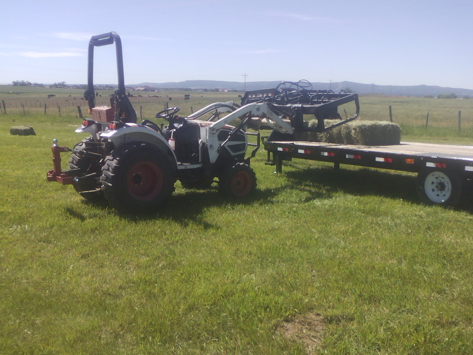

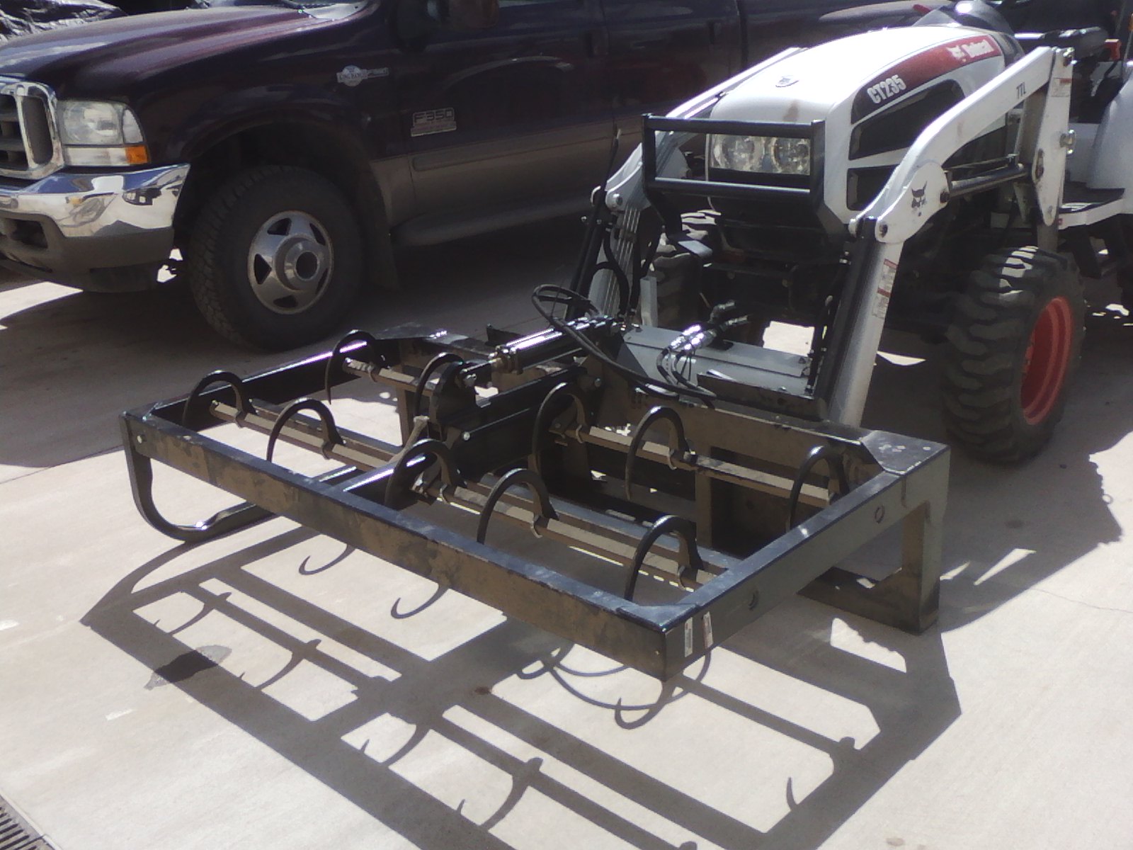

Yes he can do it as I already aim. He will need filled rear tires though. I am running a 205 Compact Bale Grabber Specialty Grabbers | Kuhns Mfg LLC | North Bloomfield, OH They make a small accumulator too ( AF4 - Square Bale Accumulator), but I can sweep and grasp 4 bales very quickly.
On edit
One thing I did was mock up the grapple and see how much room and clearance I had working in the barn. I used my pallet forks, a few pallets stacked for the grapple thickness and some cardboard to get the outer dimensions correct. My goal was to load the trailer with it and then be able to unload and stack in the barn without any hand work if possible. I also determined the center of mass and placed weight on the pallets for the grapple plus hay to see how the tractor handled. I discovered smaller was better. The grapple also enabled me to offer the service of loading folks trailers.
Someday I may get the small accumulator they offer to speed up my field work.
