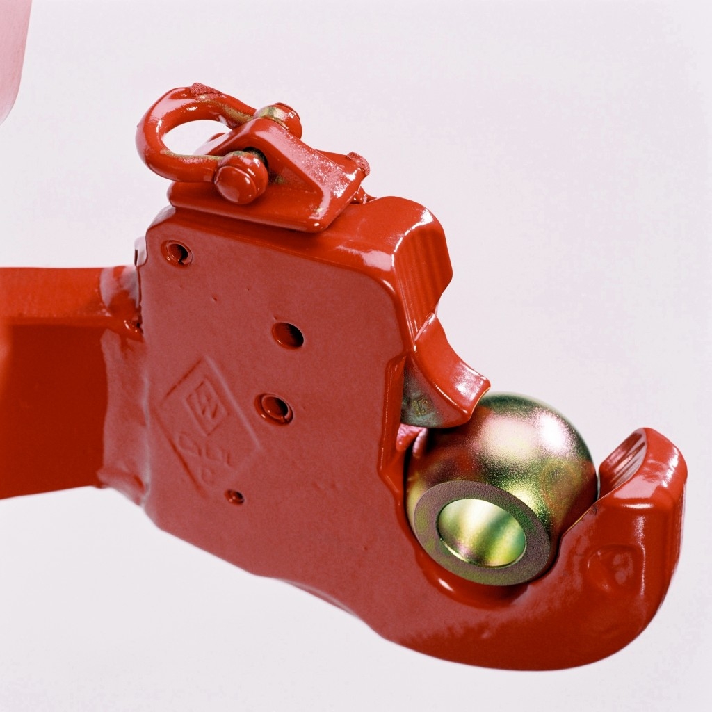

Euro hooks. One and done deal. It just works.
Once you try it, you won't want anything else.
And no, these are not the same as PATs. Not even comparable in my opinion.
