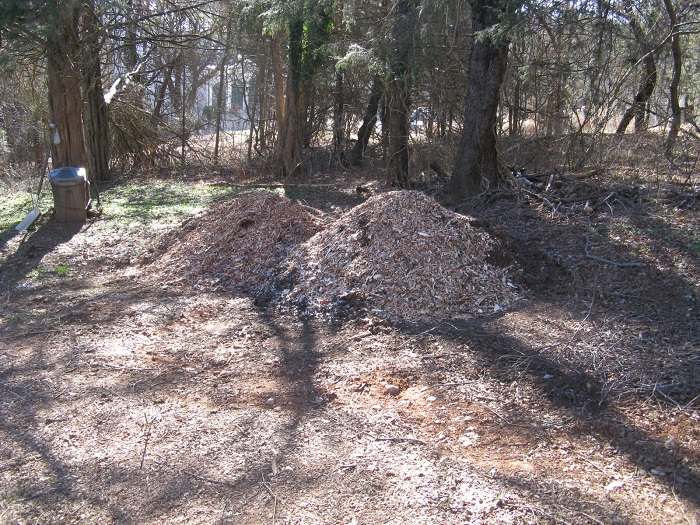

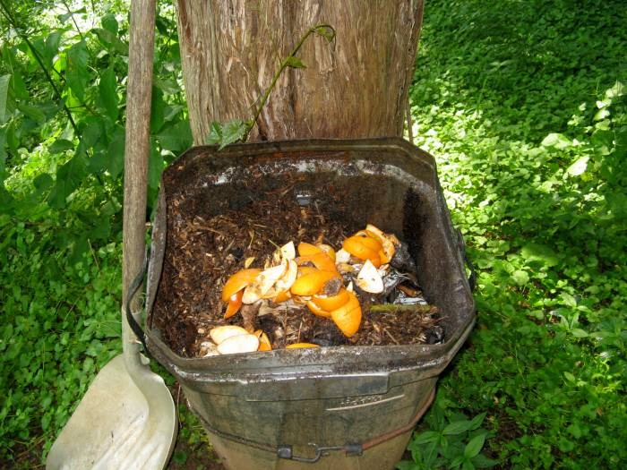

You don't need bins. Just make piles. I collect kitchen compost (any non meat) in an old garbage container from 1970 in NJ. Throw in some mulchy (brown) material from the compost/mulch pile when I get a significant amount of kitchen stuff. I flatten out one of the piles when the garbage container is full and put it in the FEL and lay it over onto the flattened pile and dump out the container. Then toss the pile with the FEL.
Attached are pictures of the piles and the kitchen compost.
