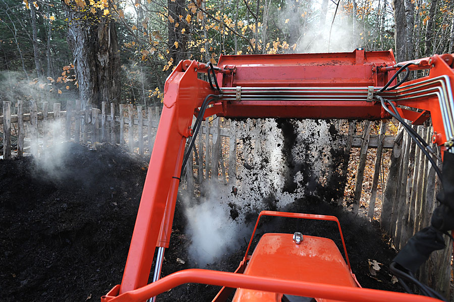

If it has a lot of dirt that also helps by adding some bacterium to the compost pile thus aiding the process. I add just about anything from old hay, horse manure from a near-by horse farm, kitchen, garden scraps and grass clippings. But as it was said before nothing heats up the pile as good as a great big shot of green grass clippings. That is the NITROGEN "BOMB" for your compost. You can also add blood meal to heat up the pile as it has high nitrogen content, but it can get expensive for that purpose.
Layer that puppy and it will work well. I love it when this is what I see.
