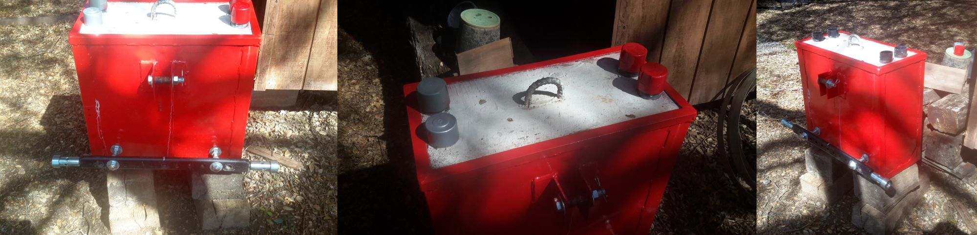

Numbers I used was 150 pounds per cubic foot, so my 2x2x1 steel box is 4 cubic ft and should be right at 600 lbs...
Handy Concrete Weight Calculator | Dumpsters.com
Spray can caps cover 2 inch ABS pipes for tool holders...
