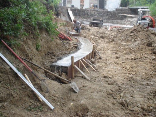

We laid out, formed up, and poured about thirty feet of footing or beam for a wall we're doing on a pond.
It took seven mixer loads, two and a third yards. When you add the two yards that's in the piers thirty feet of wall has a four plus yard concrete footing.

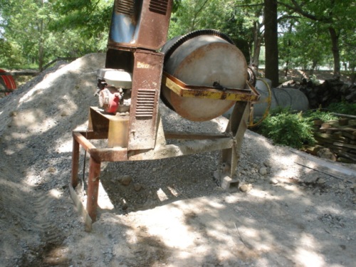

Here's a shot of the mixer before we started.

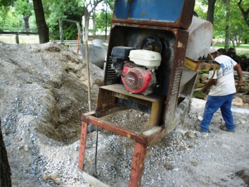

Then after we'd finished and were putting in gravel and water to wash out the barrel.

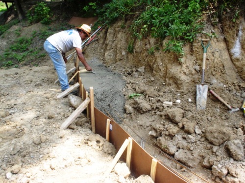

Keep in mind that again today it was at or near a hundred degrees and two of us old guys did the feeding of the mixer. He'll be fifty eight this month and I just turned fifty seven last month.
It's only work.
