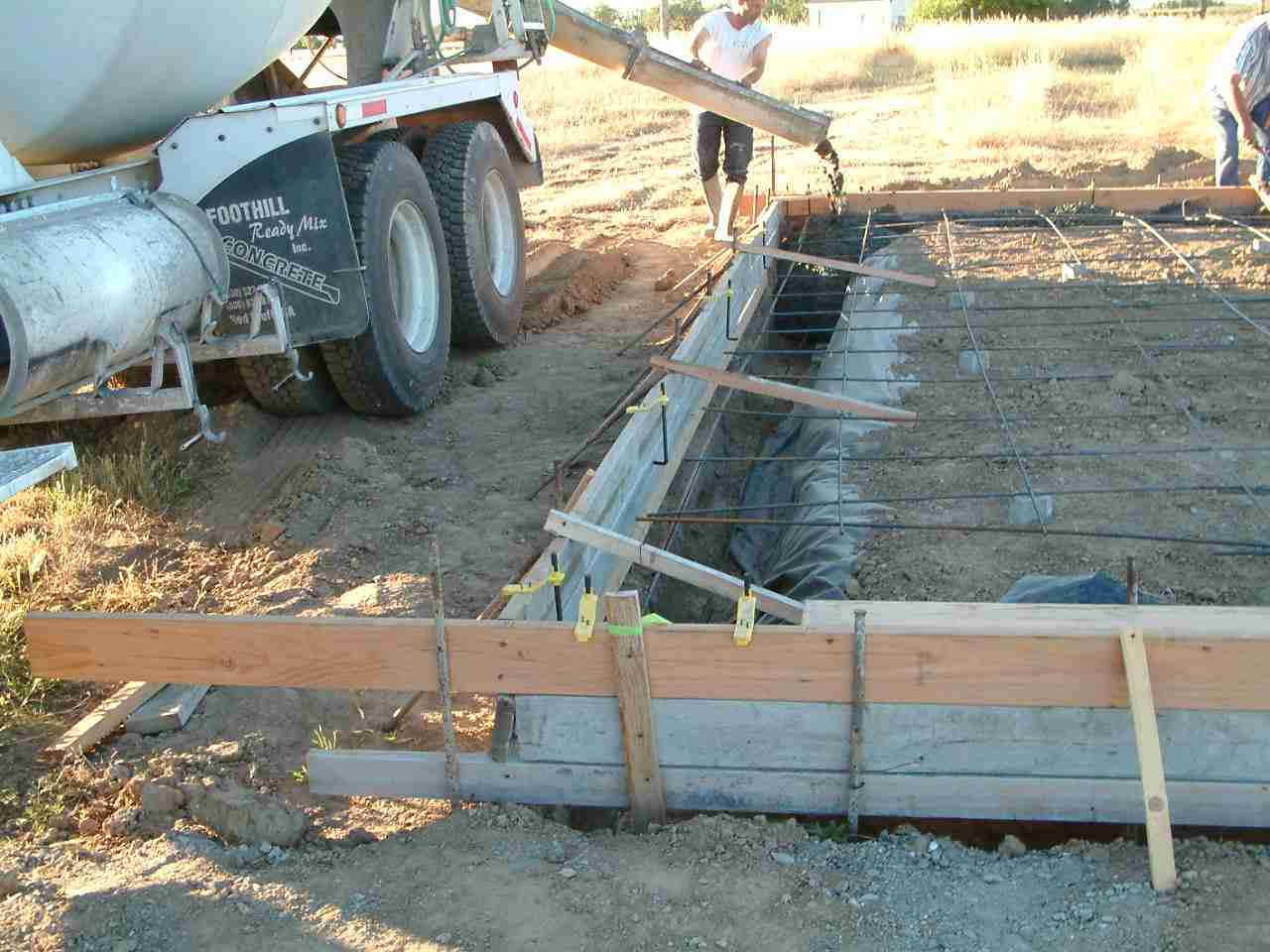

Here're the details for my garage slab (see attachment):
24'x 42'
6" thick
3000psi concrete
#5 rebar (2 rows) in the 12" x 12" footers
#4 rebar criss crossed on 24" centers in the slab
Visqueen 10-mil poly vapor barrier
Expansion joints (slab cuts) on 10' centers, both directions
5/8" anchor bolts on 6" centers and no more than 12" from corners.
Cost: $7500
A metal pole barn with 12-ft walls was erected on the slab.
