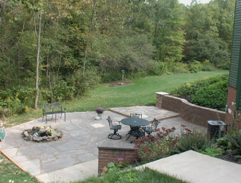

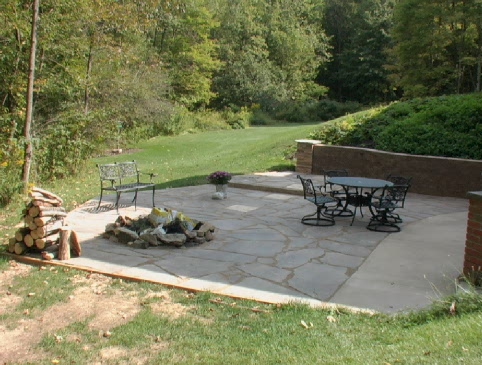

I finished my flagstone patio about two months ago. My base consisted of 2 to 3 inches of gravel under 2 to three inches of coarse sand. My flagstones are the same thickness as yours (heavy buggers aren't they?).
I filled my joints with Polymeric sand made by a company called Techniseal. You simply sweep the sand into the joints and then spray lightly with water. There are binders in the sand that turn it hard when it dries. You will still have to remvoe the material you currently have in the joints. I think I posted a photo in your other thread on the subject, but I'll post another.
So far it seems like this stuff works good, we'll see how it fares over the winter. Cost is about $25 for a 66# bag. I used four bags to cover about 500square feet with joints about the same size as yours.
I don't think you want to use concrete between the joints unless the stones are laid on top of concrete already.
