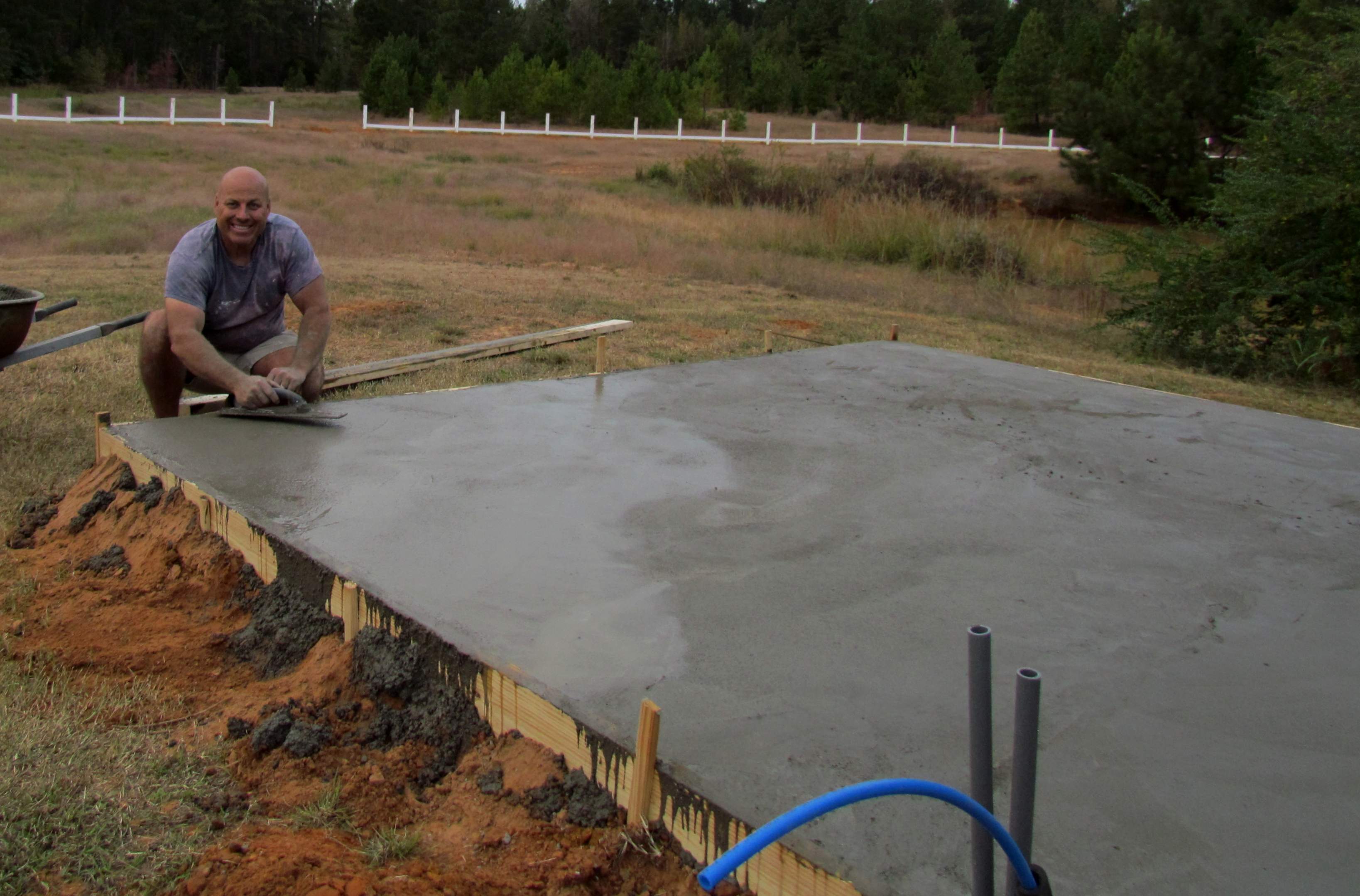

I just poured a 12x12 pad 7 inches thick with footings over a foot deep around the perimeter a couple of weeks ago. I did it on a Sunday because that's the only time I had available, which meant I had to mix it myself instead of having a truck come in with it. I would have preferred the truck, but that just wasn't possible. I made it that thick because of the slope of the ground I'm working on. I also wanted it to be a bit higher because there will be horses around it and I'm nervous about mud being next to the building for extended periods of time, which might lead to termites or other issues.
I bought two pallets of 60 pound sacks. 54 sacks on a pallet. I also used another 28 sixty pound sacks that I had stored in my shop to do this. I poured three sacks into my mixer at a time, then dumped it into my wheelbarrow and started at the farthest corner. I then worked my way closer, going from one side to the next. Every ten loads, give or take, I ran my scree board over the concrete and troweled it smooth. Temps where in the 60's, so it was a perfect day. I like to mix my concrete on the dry side, so that made it a little harder, but still doable. It was a very long day, but very doable for one person working alone.
The finish isn't what you would expect from a pro, but it's smooth enough to sweep clean. I'm not good enough to get it perfect. That takes a lot of practice, which is something I'll never put the time into doing. For bigger pours, I hire it out.
