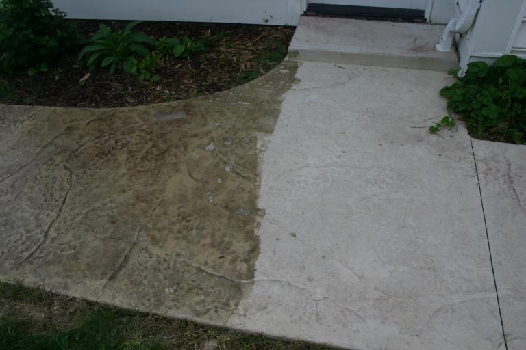

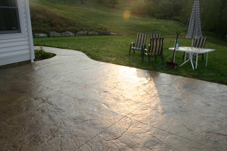

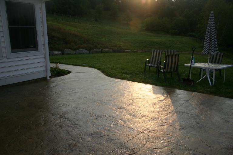

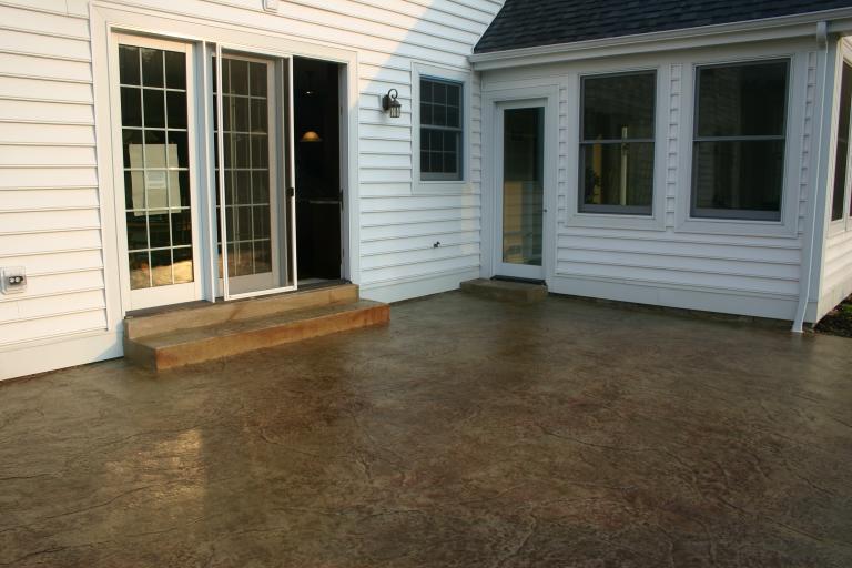

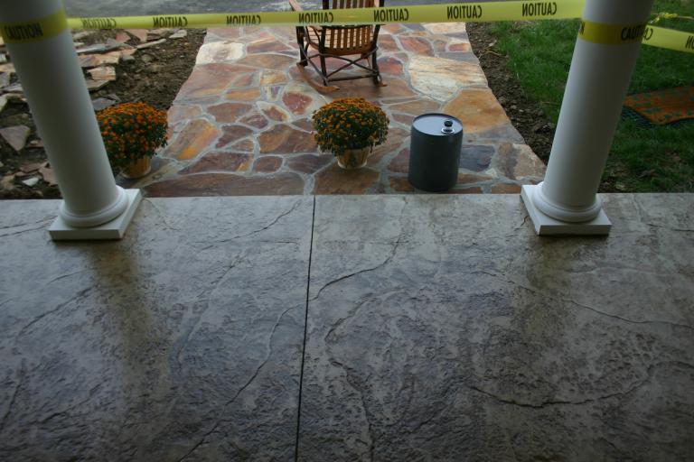

I just sealed most all of my exterior concrete with BossGloss from BonTool. I love the way it looks as much as how it works! It gave the concrete a real dark look and the water beads like crazy.
They also have an additive called something like MaxGrip if you're concerned about it being too slippery. It's definitely slippery than before but not a real problem.
