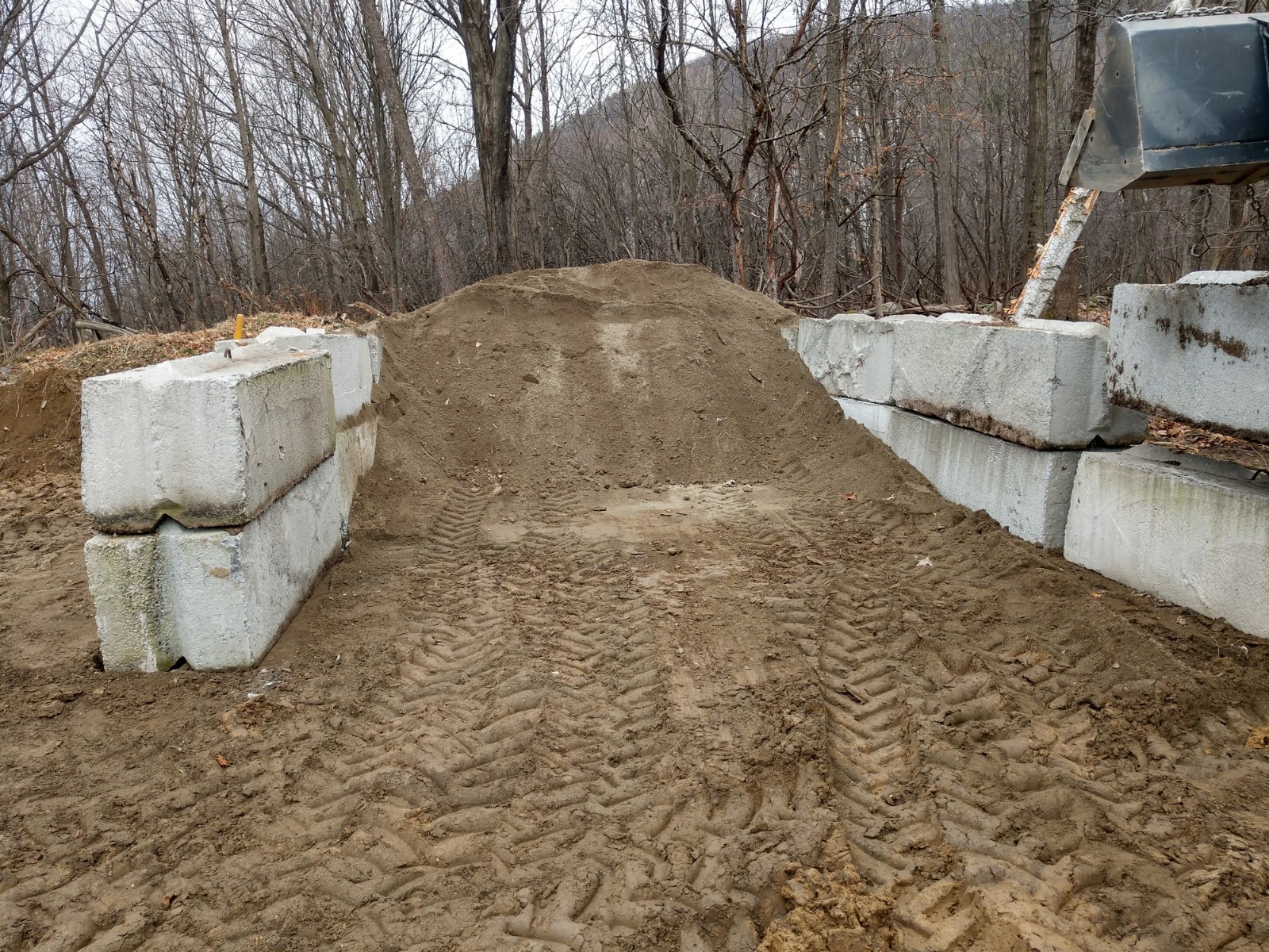

I'd be tempted to dig down a bit lay down highway fabric and a bit of gravel, then set the mafia blocks and pour inside of them.

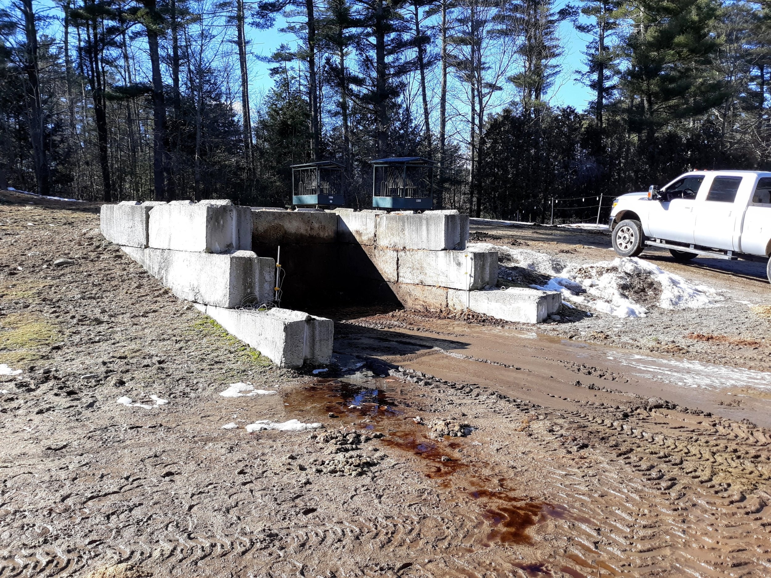

I just stacked my blocks on the ground. I hauled them myself when I had my Mack . I paid $20. each.

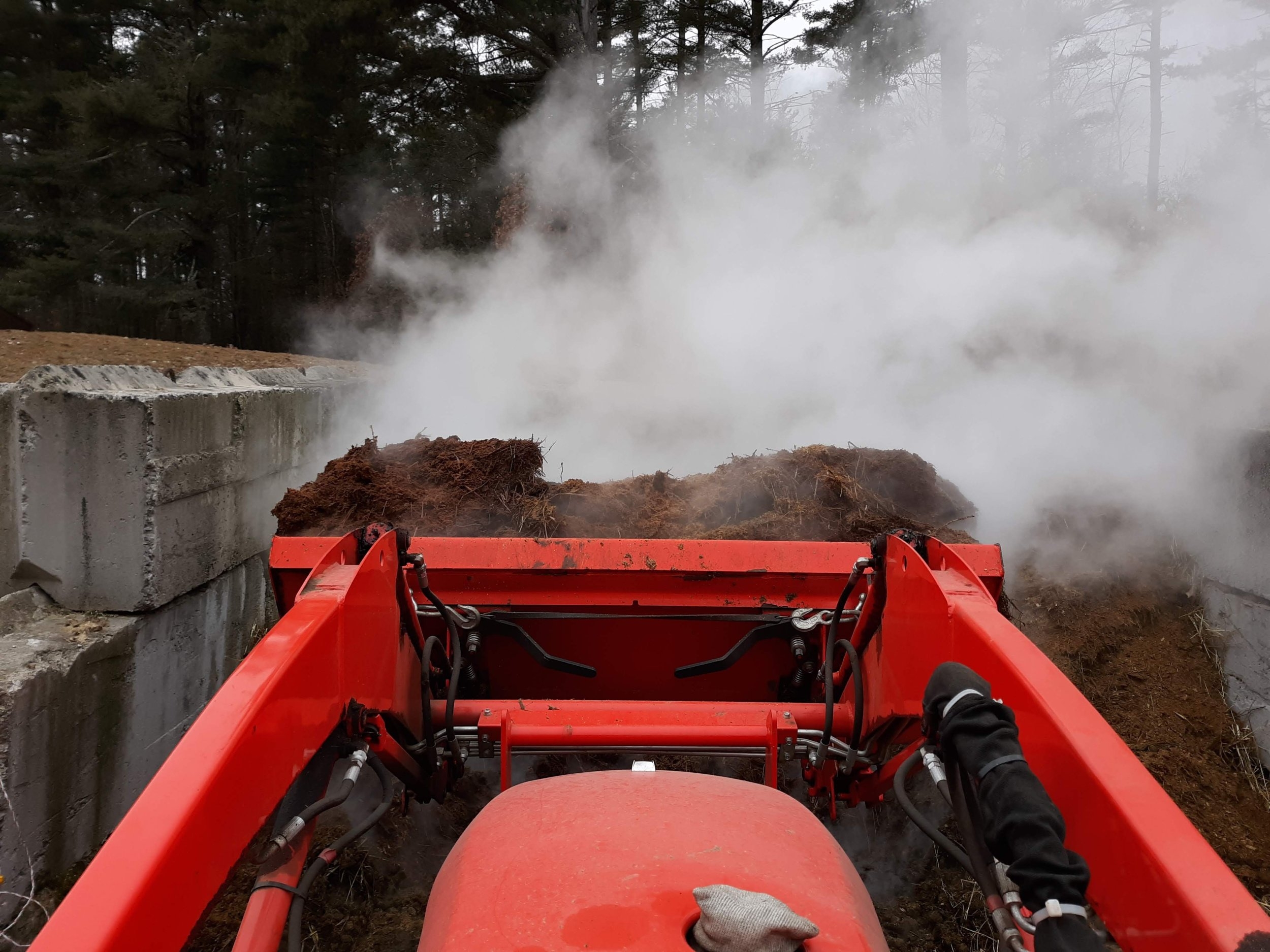

   / Concrete Slab thickness for Bin Blocks #14
Wow! They are nowhere close to $20/ea here. Lucky you.

View attachment 858552I just stacked my blocks on the ground. I hauled them myself when I had my Mack . I paid $20. each. View attachment 858551
Like the backfilling, I think I am going to try to get my first layer at least covered. Any movement or anything when scrapping up the pile? Looks solid to me.
