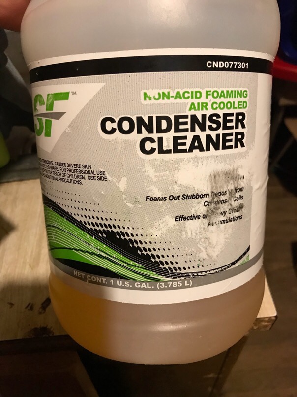

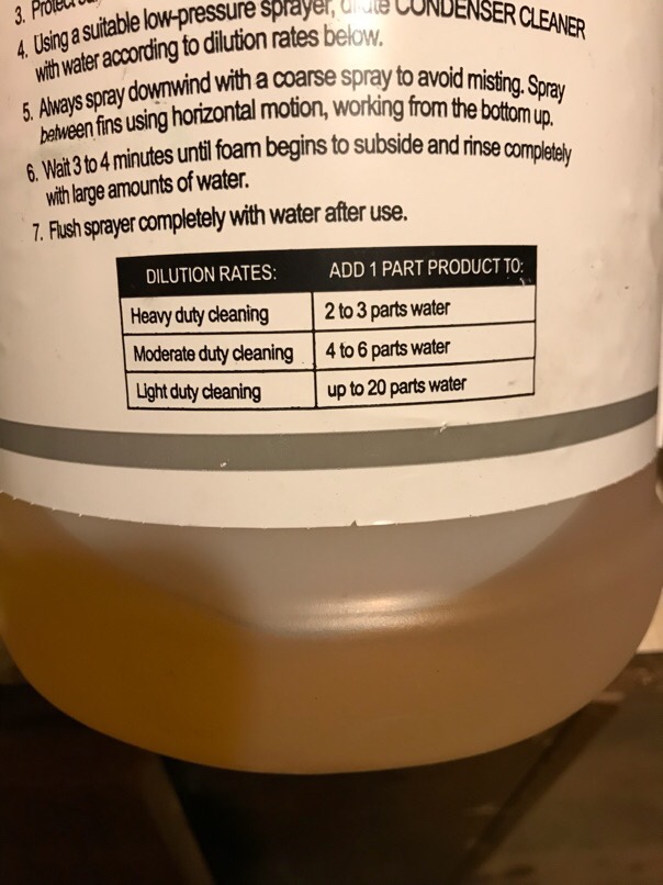

I have a friend who works for an hvac company and I ask him if I could get some coil cleaner this week. He brought this partial gallon by. It’s some good stuff. You may can take a squirt bottle with you to a hvac place and they may give you enough to do what you need to do. It’s says to mix it with water so it doesn’t take a lot.

Triple D is what I've been using the last 10 years or so.
For HVAC coils, you want a non acidic as you want to ensure you don't remove the metal that's there to get it "clean looking".
