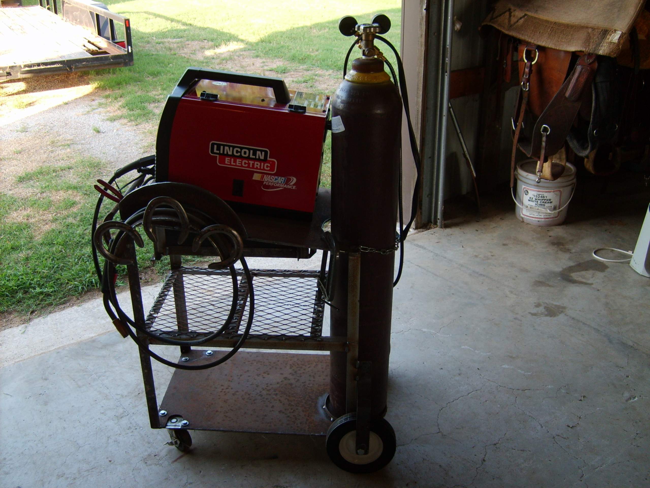

I'm with mbohuntr. I prefere .035" hard wire and C25. I'm not sure what size of bottle I rent. It's in the pic below.
   / Confused over which gas for welding... #5
c25 is 25% CO2 and 75% argon. It will work well in your welder. The higher % arogon and less CO2 is more expensive and wont penetrate quite as deep, but can give better quality welds. I thing a 90/10 mix is required to do spray transfer welding, which is a whole other topic that you shouldn't be concerned with.
The bottle in the pic loos to be the 125 cu ft. I think that would work for no more welding than you'll do. They also make 85 cu ft bottles, 24x bottles and like a 320.
