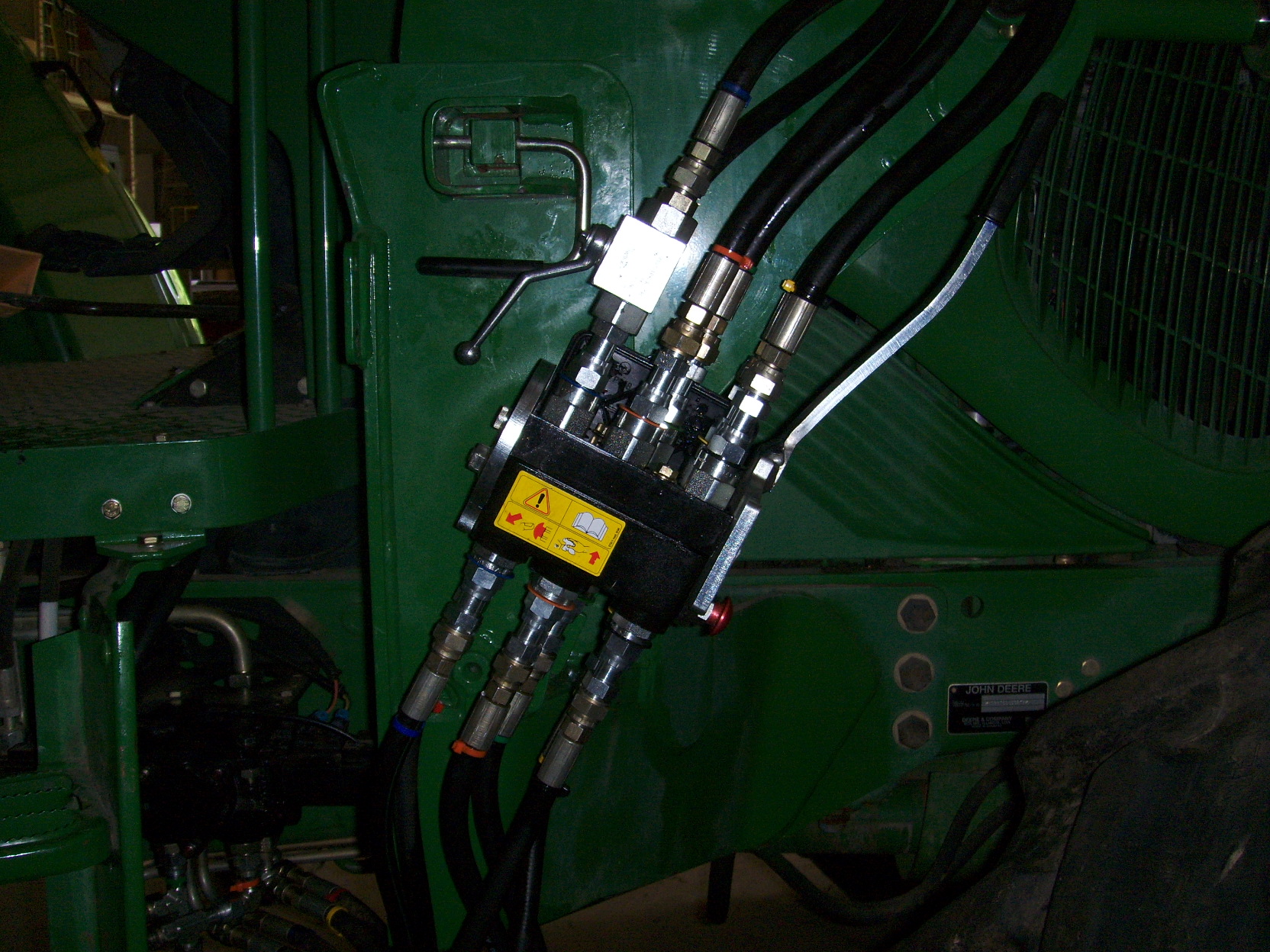

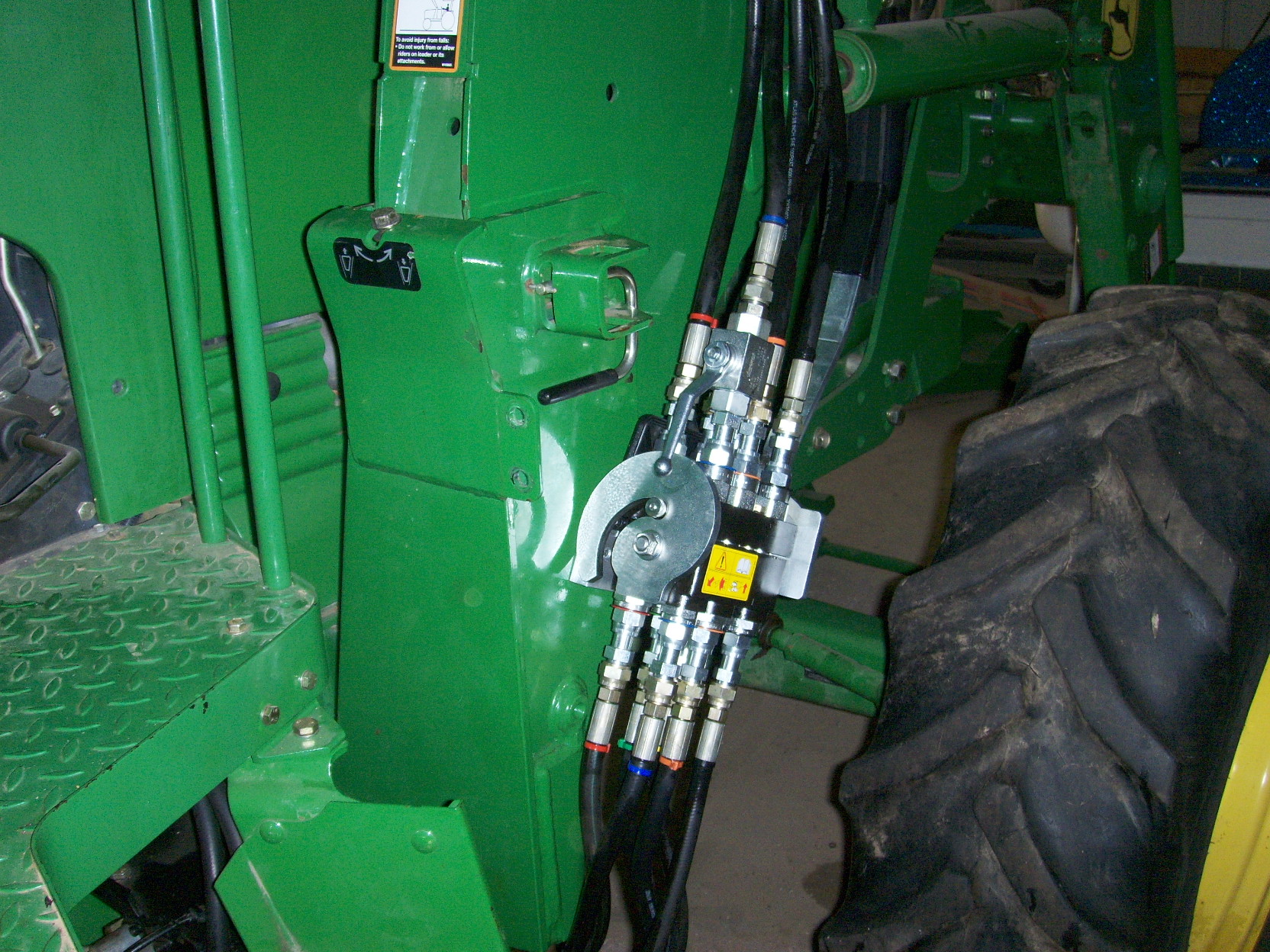

Something you might look into is a multi-coupler. Faster makes the ones used on John Deere Loaders. They have Units for four or six hoses for tractor to loader and units for two hoses for the loader to implement. The leverage to make engagement easy. I changed the six quick couplers on my JD 6415 to loader to Multi-coupler.

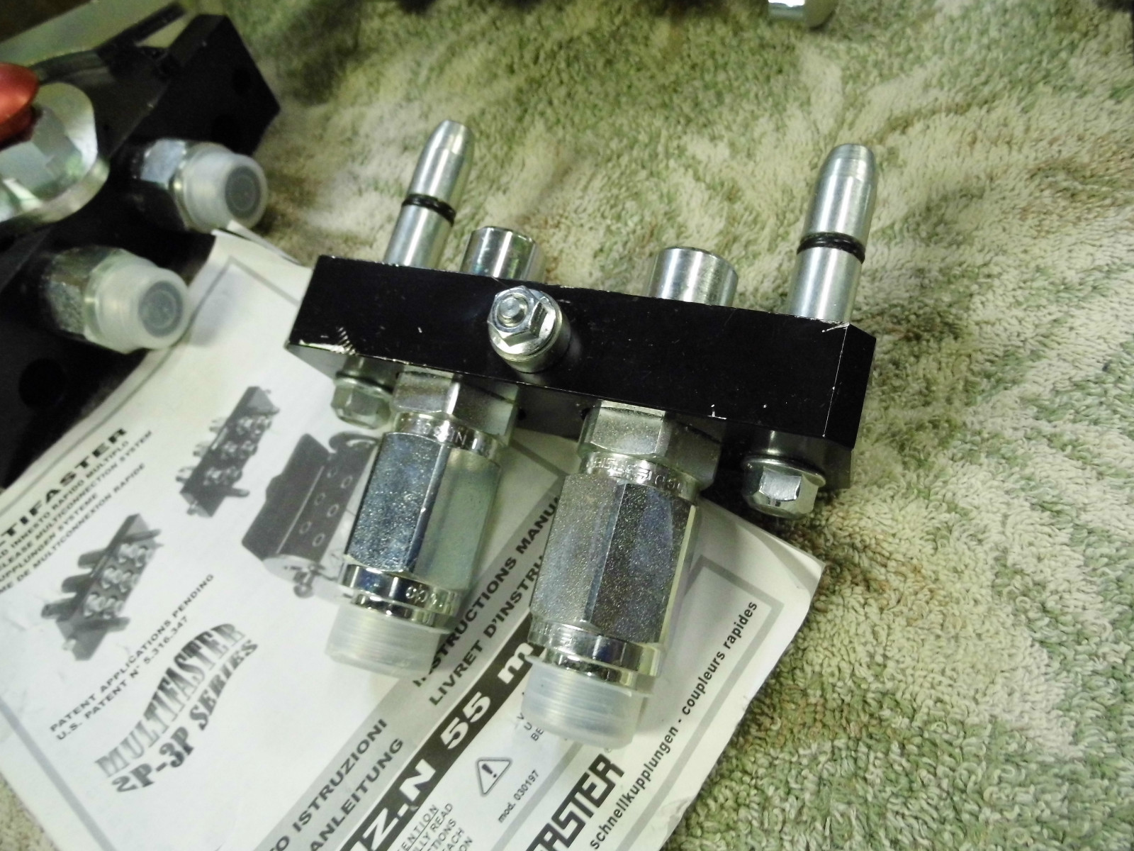

Found some pictures of the 2 hose multi-coupler. Loader half and attachment half.

The loader to implement is what I would need and it sounds like this device may use the connect under pressure couplings. Does the implement side use standard connectors? This setup would be opposite of what I have found with connect under pressure connectors and wonder how it would work to relieve pressure already built up on the implement side?
Also, what are the levers for that are in these pics? I briefly thought about adding fittings immediately before the couplings on the implement side with ball valves to cut off any pressure.

With the multi-coupler there are two halves. One fixed (mount to loader) and a mobile half (for the implement). The lever pulls the coupler together. The mobile half has pins that guide both halve together. The lever has curved groove that engages pins on the side of the mobile half. Operating the lever pulls the couplers together. A red lock button to keep everything coupled.
In post #5 the top picture is the mobile half. Two out board pins pointing up are the guide pins. In between those are the actual couplers. On the bottom are where the hoses connect. On the side you can see one of the pins that the curved groove (cam) of the lever engages. Not shown is the pin on the opposite side.
Lower picture is the fixed half. You can see the red lock button, groove is hard to see.
LMK if you need better pictures...............I'll try and find some.
