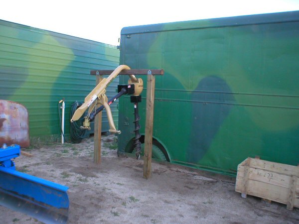

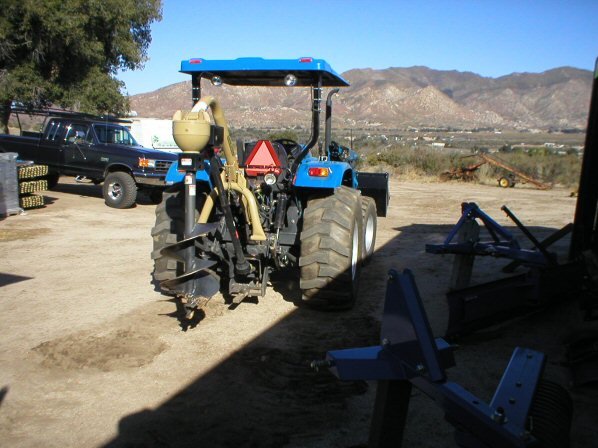

   / Connecting Woods PHD35 to Kubota B7800 #7
I hang mine between 2 - 4x4 posts with a removable 4x4 that it hangs on. See pics. Unlike some of the other people here, I find that this implement is relatively easy to mount on the tractor and I do it by myself in only a few minutes.:) After you have done it a couple of times you will see how easy that it really is.;)
