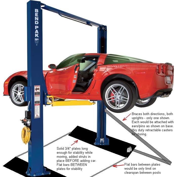

Jim, I know I'm pretty good at spending YOUR money :laughing: But here's a basic Idea of what I intend to do in my shop addition when it's done, same reasons for wanting portability but only wanting to buy ONCE (my neighbor has one of these and loves it)...Steve
