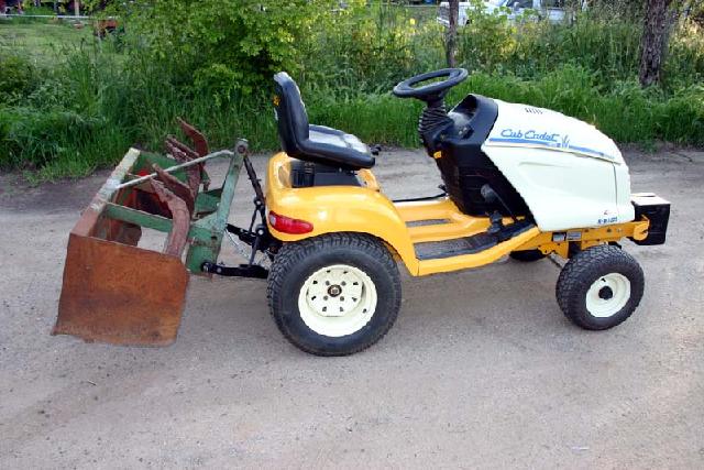

I was think more along these lines when I mentioned a Box scraper and the 3235 series ...(.its not mine, its another Cub owner cant take the credit)...you will need the differential lock feature on the 3235 series (or 3200)
Cub3000 with Box Scraper

   / Considering GT2544 - but few dealers, attachments #9
Yup;
Thats the one $182.00 and it attaches to a normal sleeve hitch .
These are not to be confused with a three point
The electric Cub sleeve hitch will lift the box blade with 2, 3 ft long railroad logs on it. I figure the combo at 400 lbs.
And the tractor pulls it well and the combo moves loose topsoil well.
Todd
