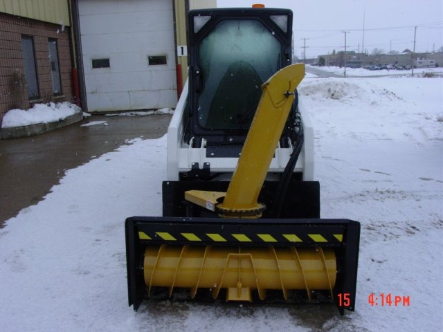

You ought to look at the Reist Series 1000 Single stage blowers from Reist Industries in Elmira, Ontario.
The Reist single stage blower was $4,000.00 Canadian loonies plus the cost of the front mounting frame and shipping.
It can be mounted on the front with the front attachment kit and attached to the mid PTO and also mounted on the rear after removing the front mounting plate kit as it comes with a three point hitch as standard equipment and it only need the front mounting plate and the under frame for the tractor.
It will benefit you purchase wise as the Canadian dollar is weak right now. You contact a Reist equipment dealer in Manitoba to see if they have one in stock.
The picture I have uploaded shows the series 1000 mounted on a bobcat as it also can be switched to be powered by a high flow hydraulic system.
