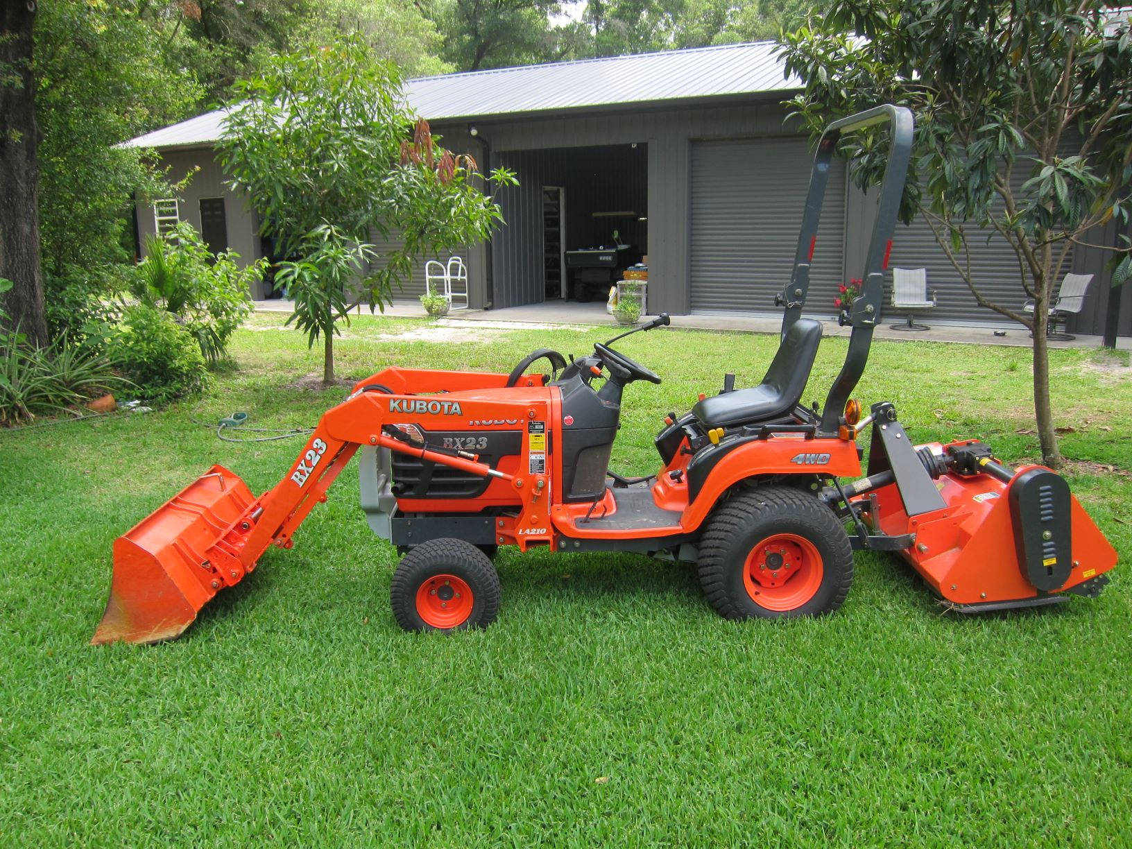

I'm late in resurrecting this thread but with the help of Kentuckyfarmer and Volfandt I did buy the 2004 BX23TLB four years ago. Immediately found I should have done more research because I soon learned the cooling fan was toast. I did get it repaired for $200 which seemed very fair. I have put over 100 hours on it and find that I go to it more and more frequently. I purchased an EA Wicked Grapple which has been very useful and is beautifully made. I also added a 4' flail mower which has been a very useful implement and has given results near a ZTR in light material and has shredded 3.5' heavy reeds/grass along a lake edge.

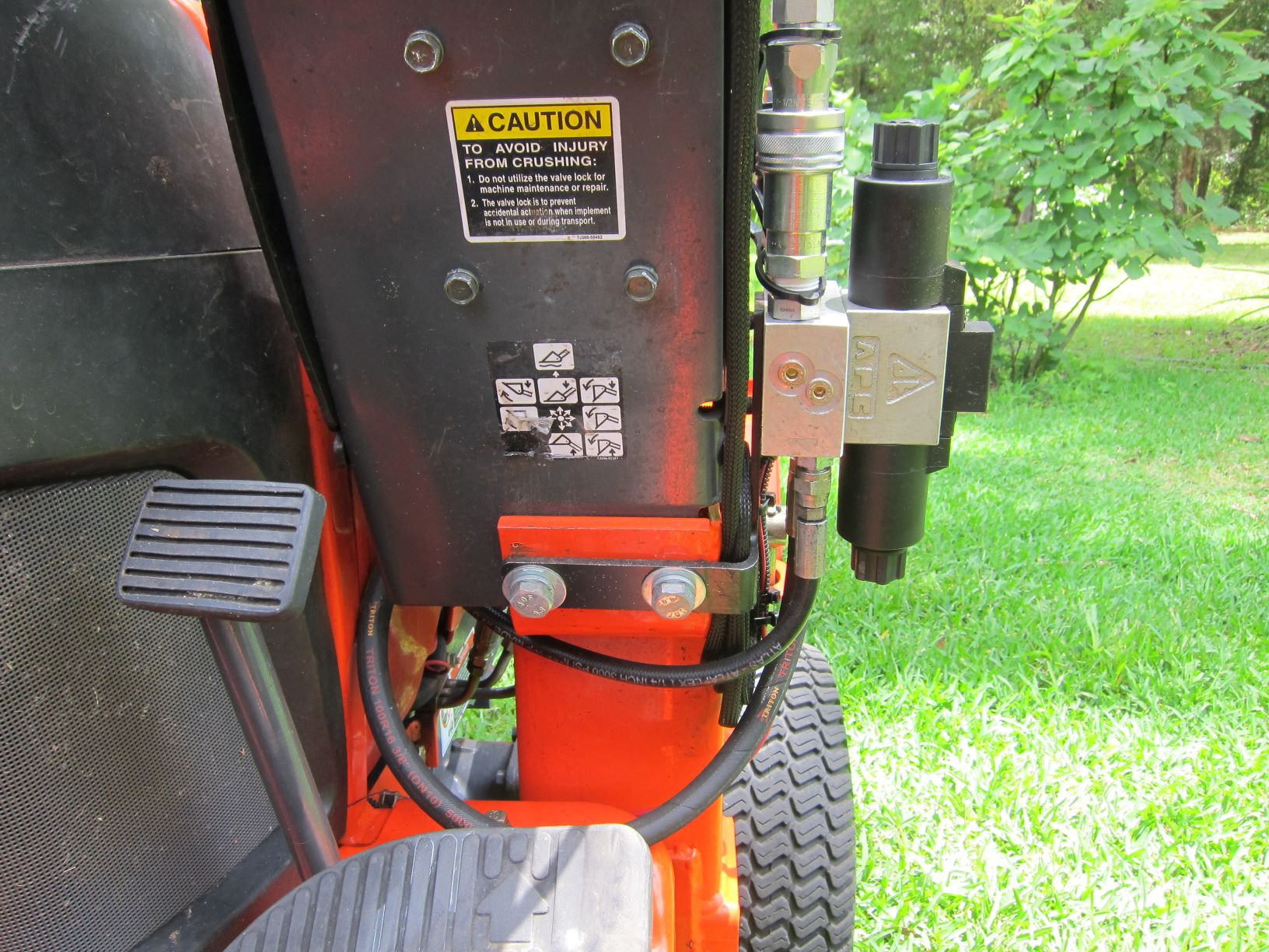

I added a WRLong 3rd function valve for the grapple and I cannot praise Nelson Long and his company sufficiently. Apparently there is considerable variability in the geometry of the FEL valve mounting on the early BX's and the standard bracket would not fit. Mr Long worked with me and designed a mounting plate for the valve body which has performed beautifully. I have dealt with a lot of companies over the years but WRLong has proven to be at the pinnacle of customer service, far and above my expectations. I cannot recommend them highly enough.
Kentuckyfarmer requested pictures so I'll try to attach some.
