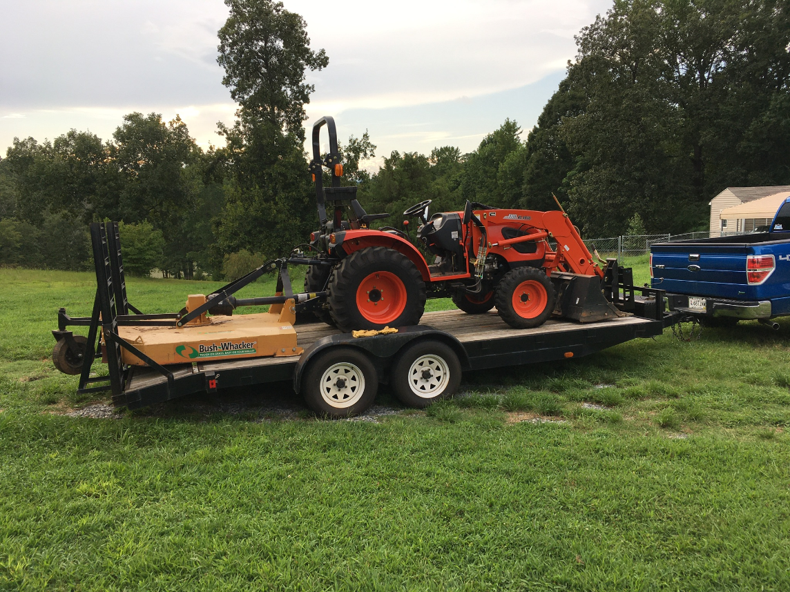

Thank you all for the input. I feel pretty confident about going with a 20' 14k trailer with 16" tires. I borrowed an 18' trailer last night to see if and how I could make it work. I would love to be able to transfer all my implements but I'm not sure I could make that work, even with a 22' trailer. I still have the area in my bed available but I'll just have to see if it's possible. I've attached a picture. Tractor on 18ft trailer.png
   / Contemplating buying a trailer to transport my tractor #8
Thank you all for the input. I feel pretty confident about going with a 20' 14k trailer with 16" tires. I borrowed an 18' trailer last night to see if and how I could make it work. I would love to be able to transfer all my implements but I'm not sure I could make that work, even with a 22' trailer. I still have the area in my bed available but I'll just have to see if it's possible. I've attached a picture.View attachment 666017
Looks good. I understand about wanting to have all the implements on the trailer, but I am not sure it will be worth the extra cost/hassle. Most of your customers will be contracting for a specific job--bush hogging or leveling and tilling an area for a garden, so you most likely will not need access to everything at a given site.

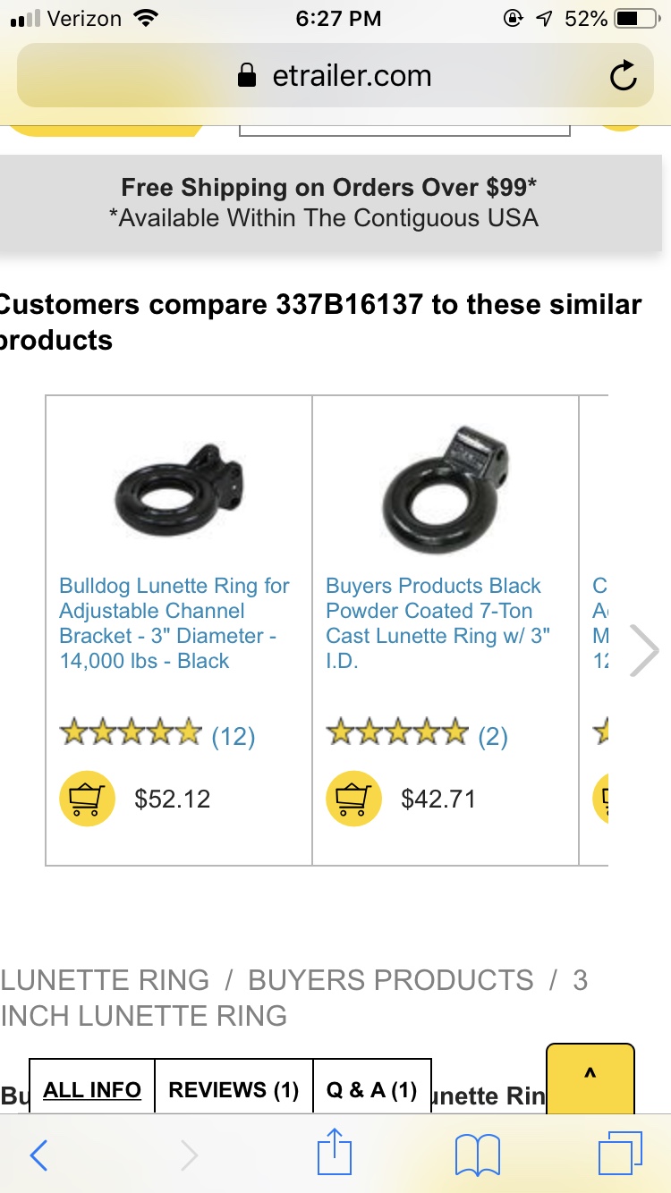

I’ve played off my pintle hook trailer as being too heavy for a pickup which it is. I’m thinking about putting one of there pintle hook rings on my 14k trailer. IMG_9004.JPG
