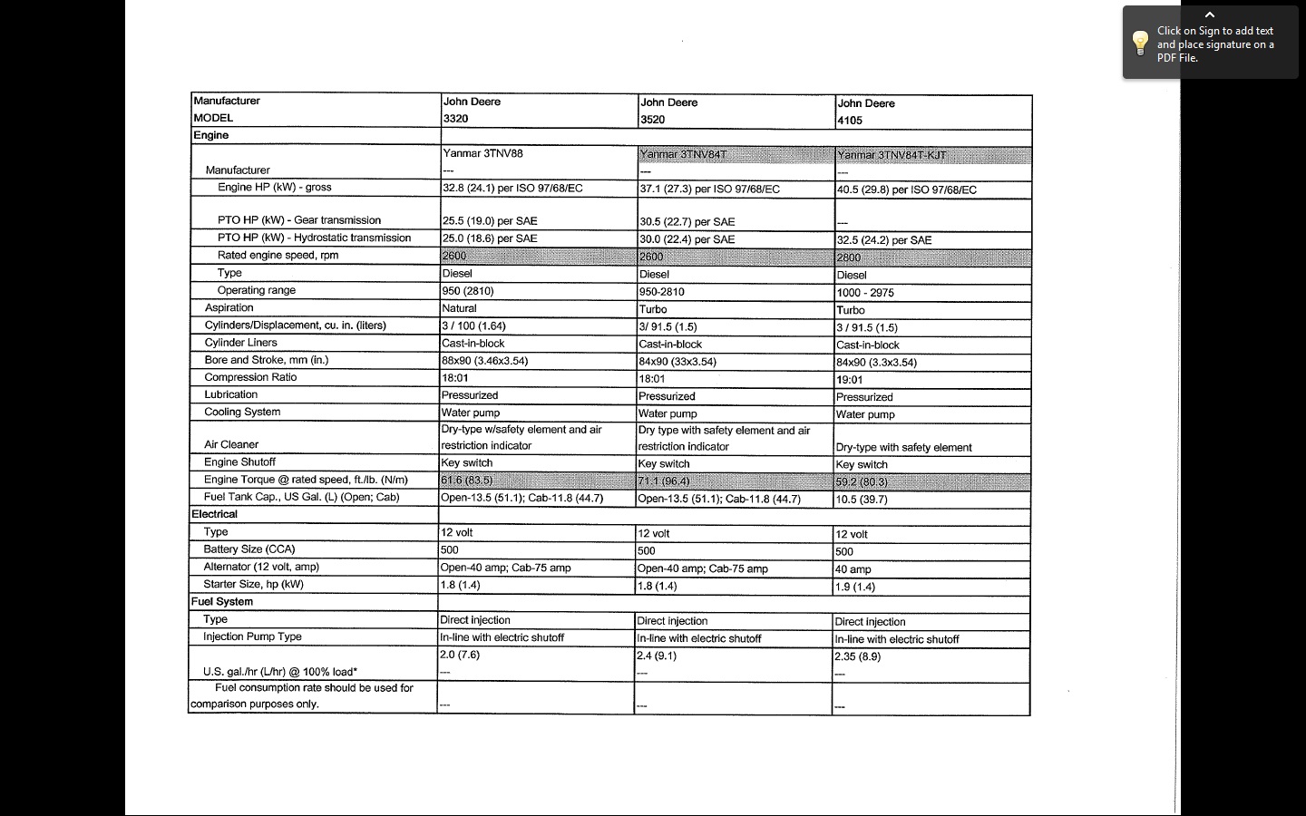

iirc the 4000 series econo tractors are actually stripped down 3000 series tractors? According to the wheel base and wheel track, weight , capacities etc.
/ Contemplating the 4105 #30
The 4105 is stripped down, however the frame is larger than the 3000 series. Same size loader though.
