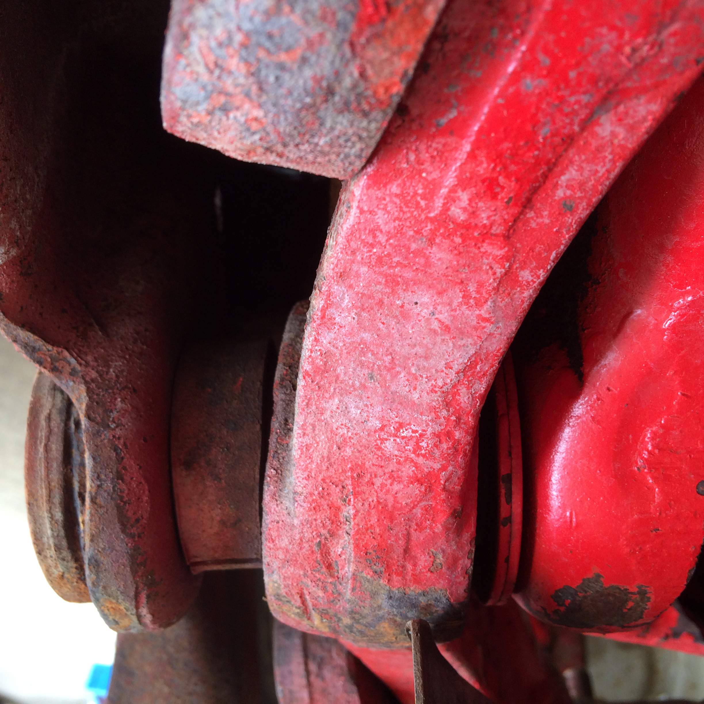

Well, got the tractor running, took off old radiator and when trying to fit new one on, I had a problem...not only did I not have clearance for the shroud, but I could see where the fan was hitting the front axle above the pin.
[URL=http://s998.photobucket.com/user/wtss1/media/IMG_0984_zpsc4ovhrgk.jpg.html][/URL]
Well I did a little sleuthing and found out that's because the Front axle support pin and bushing needed to be replaced.....so I jacked the tractor up and got the weight off the wheels and sure enough I gain some clearance.
I couldn't knock the pin out too easily so I guess I'll tackle the broken bolt as I had to take the "front axle support bracket" off (See Soundguy I'm learning).
[URL=http://s998.photobucket.com/user/wtss1/media/IMG_1001_zpspl3hskhy.jpg.html][/URL]
Here is the position of the broken stud on the front of the engine where the front axle support bolts on:
[URL=http://s998.photobucket.com/user/wtss1/media/IMG_1003_zpsmygof2mj.jpg.html][/URL]
I want to make sure this is the kind of pin that just bangs out instead of is threaded...I believe this is the non threaded pin, but wanted to make sure before I started banging.

Well I answered my own question by beating that old pin out with a giant impact socket and a BFH....5 lb hammer.....bushing was worn thru and of course the axle has been oblonged. Cheaper to buy a new axle or have a machine shop ream it out and put an insert in there? I really don't know about this stuff. The keen eye of my wife noticed that the axle had been broken and welded back together...I wonder if someone had a loader on this at some time and tried to pick up something way to heavy or just crashed it into a battle tank. help!
   / Continuing Saga of the anti-mechanic and his Jubilee Part Deux #8
It might be possible it had a loader on it and farmers did use and abuse them. Have your wife's keen eyes check out the axle carrier for cracks also the rear pin hole to see if that was also waddled out. You should be able to replace the axle with a used one that someone is parting out an NAA or later model tractor so long as the bushing isn't completely worn thru.

Yeah....I know not to doubt the Soundguy's advice. I found an 8N axle on Ebay.....looks like from my research is the same front axle as NAA...says the bushing is usable...I just sent a question to see if the hole was still round and not a round bushing in a messed up hole. That should work right?
