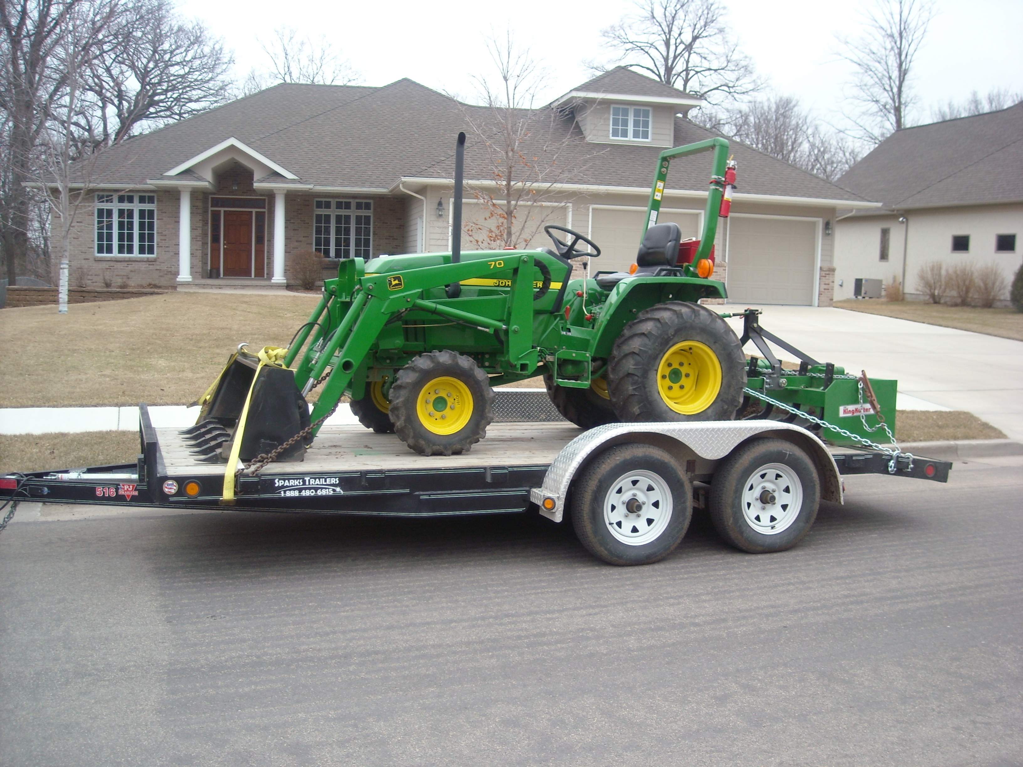

Heres a pic of my tractor loaded and ready to go up to my land....tomorrow!
