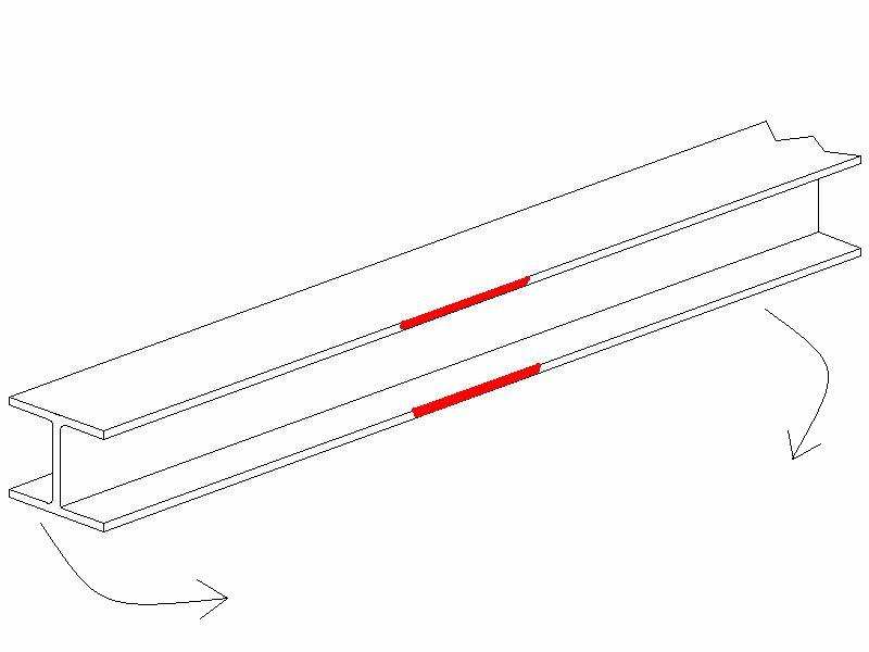

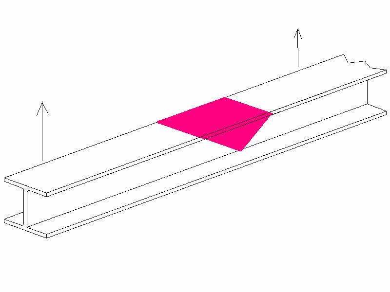

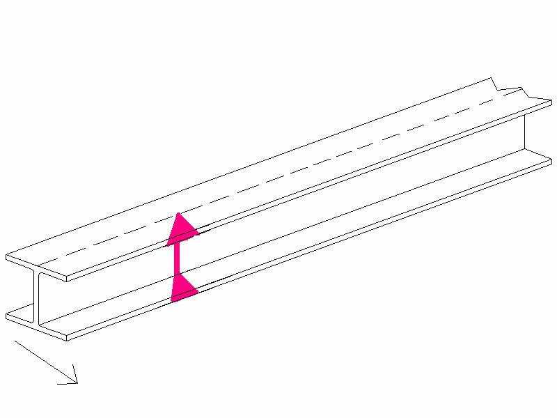

For small objects I like to use a spray bottle of water. Large beams I'll use a water hose.
