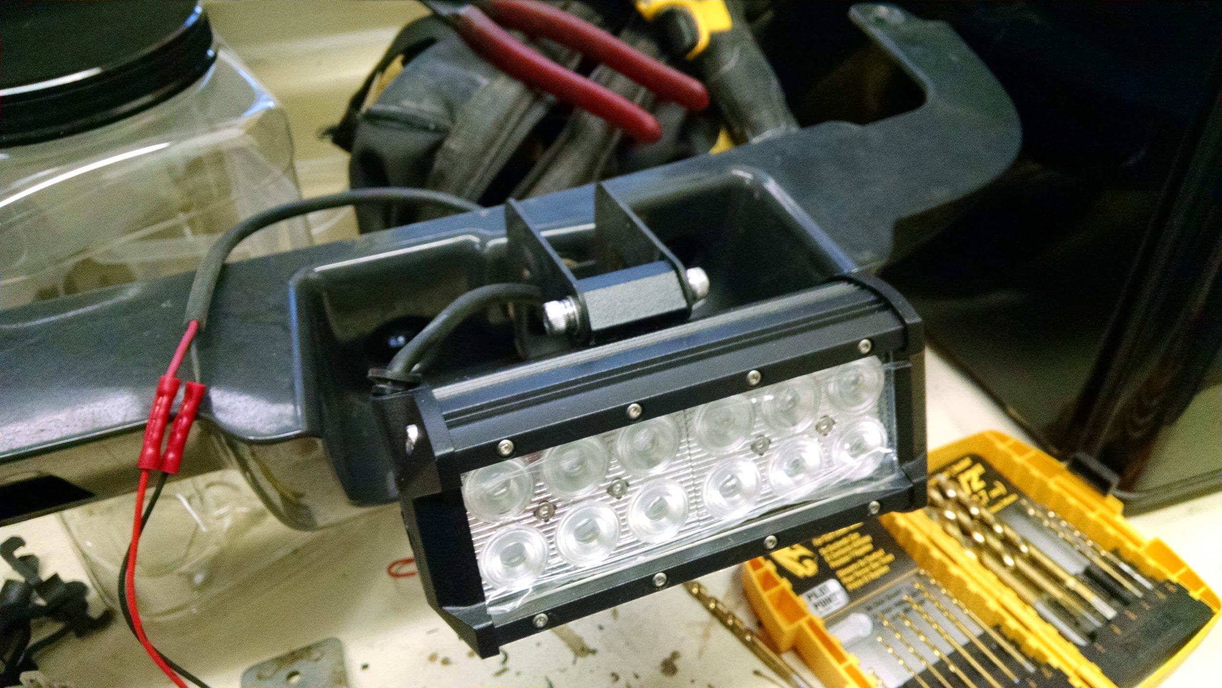

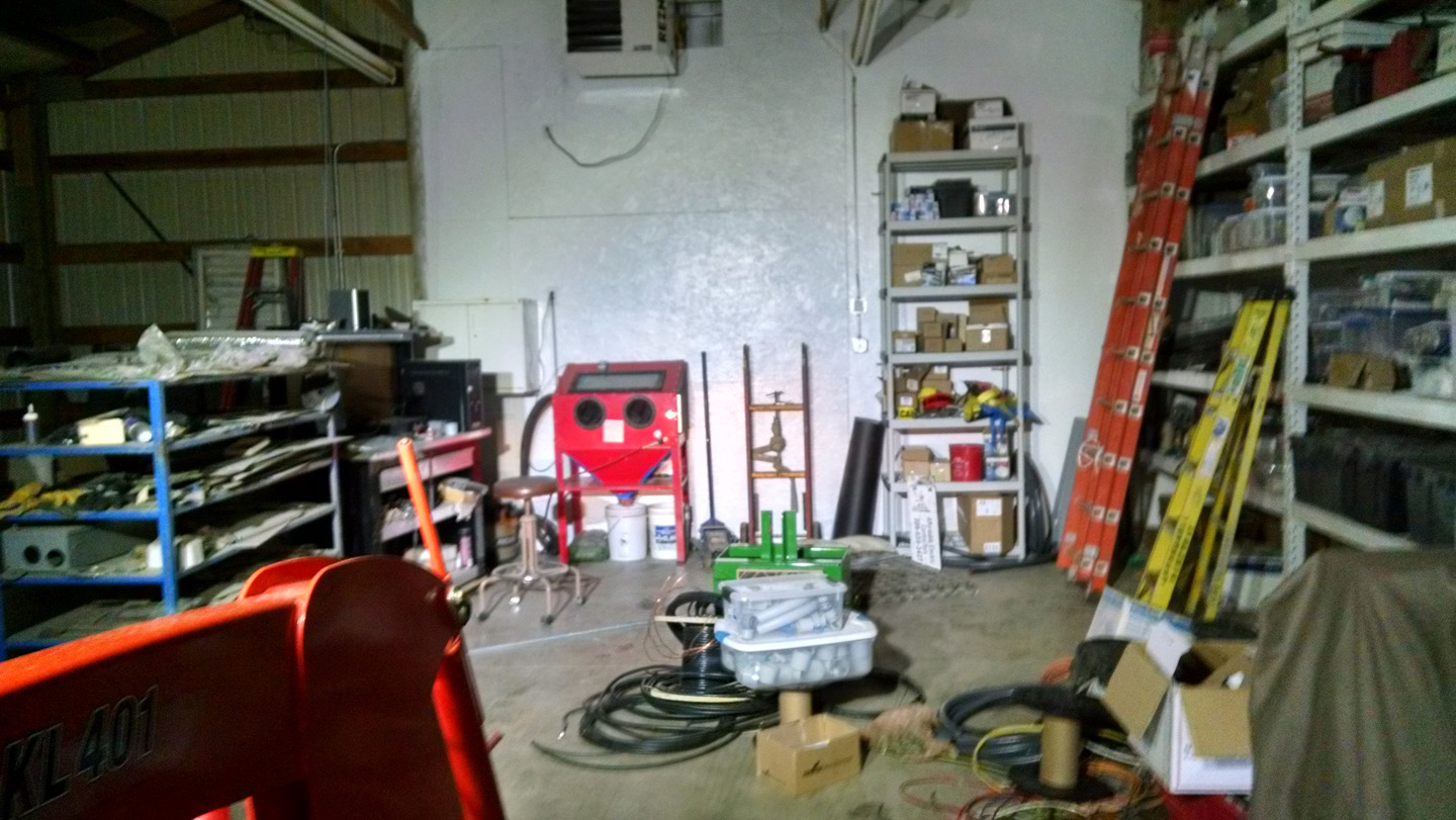

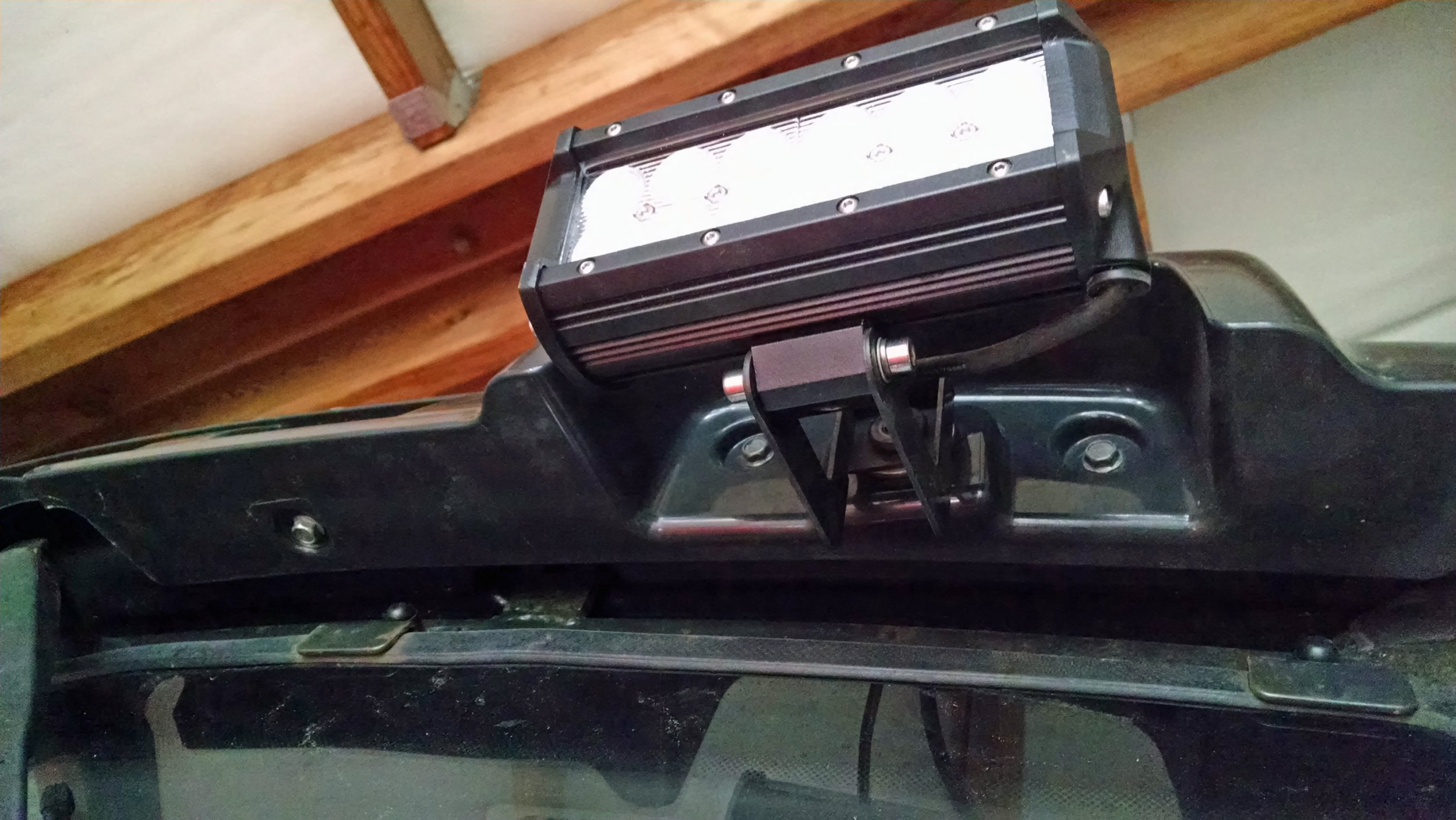

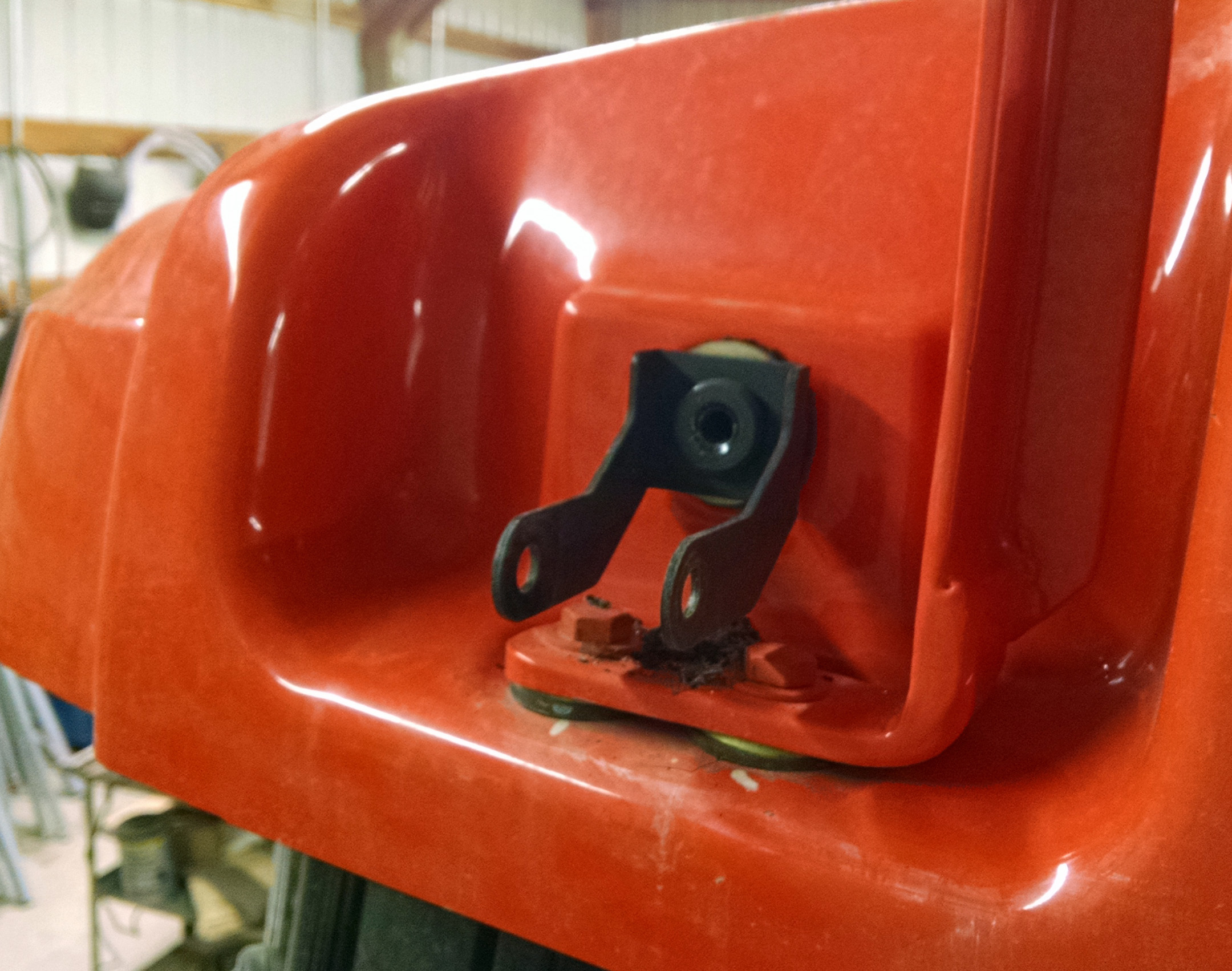

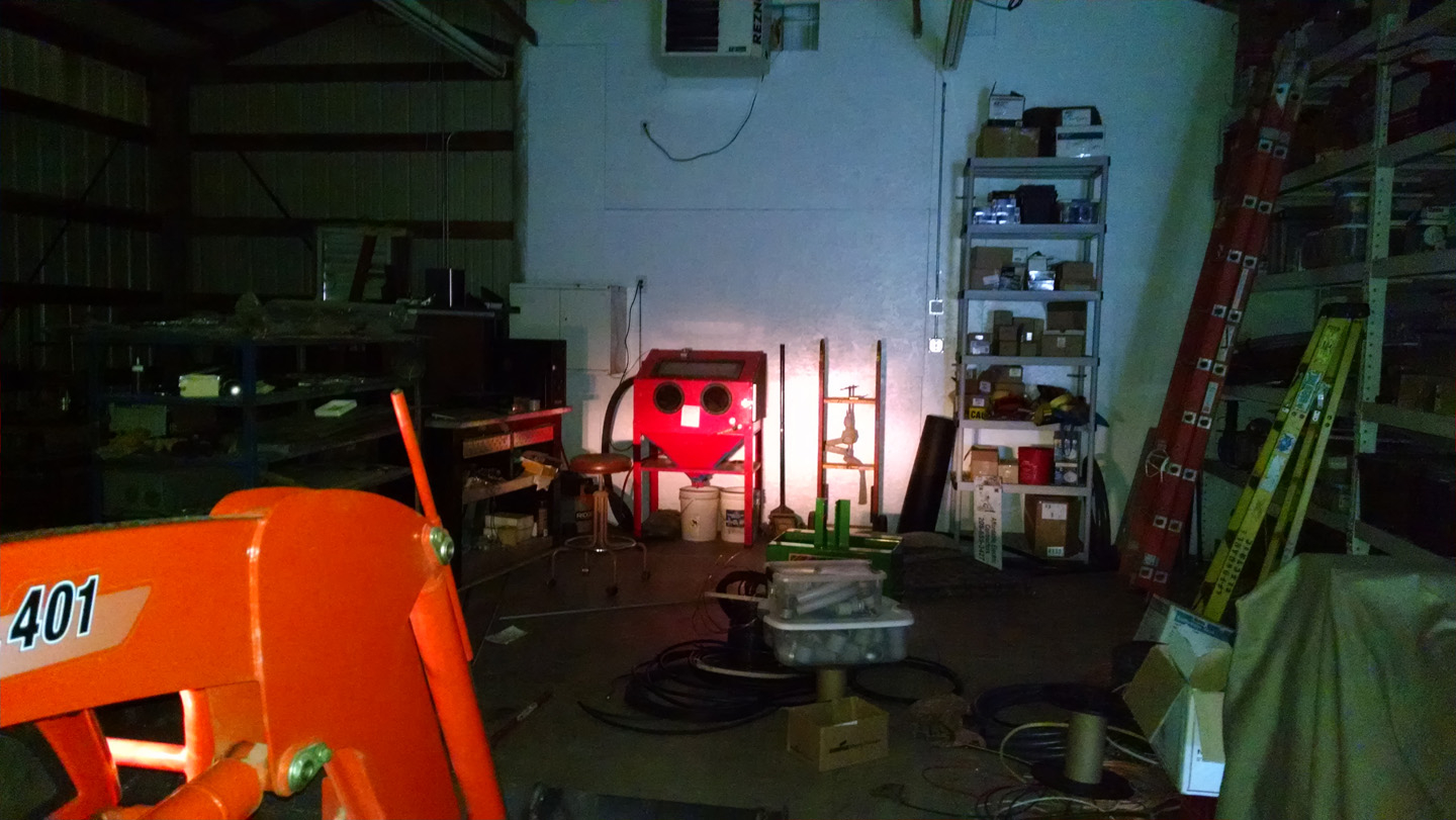

i found i could not simply change the lamp, i had to change the fixture. there super bright though. i had to lift the roof to do it. the last two pics show lights before then after. major change

i have no idea if current light fixtures were like to older (mines a 2010 era) halogen lights, but back when i switched mine out the halogen replacement led lamp wasnt much brighter than the halogen. so i went with 4 x CREE led fixtures.i installed them in 2016, no issues and there used alot all winter moving snow.

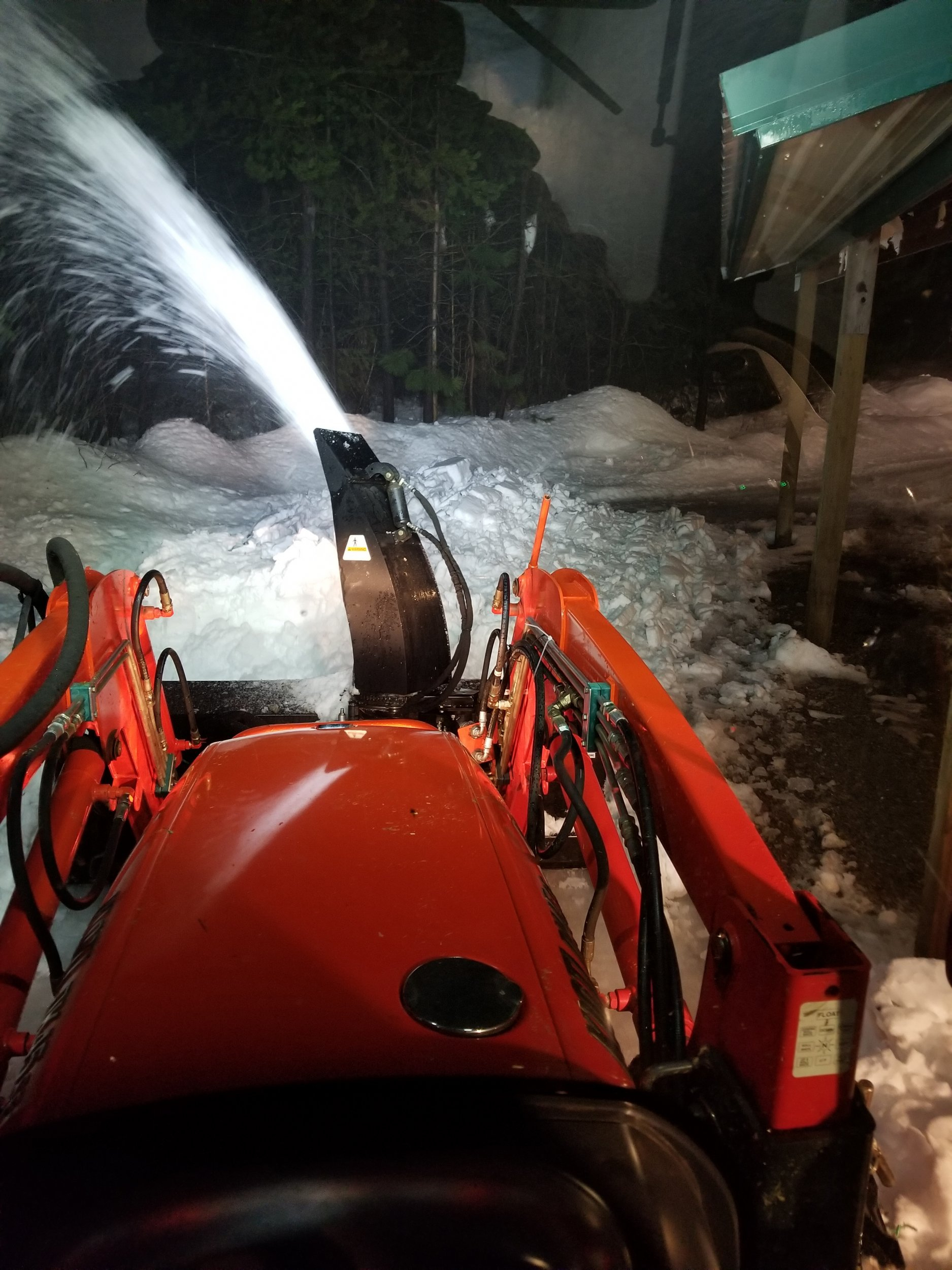

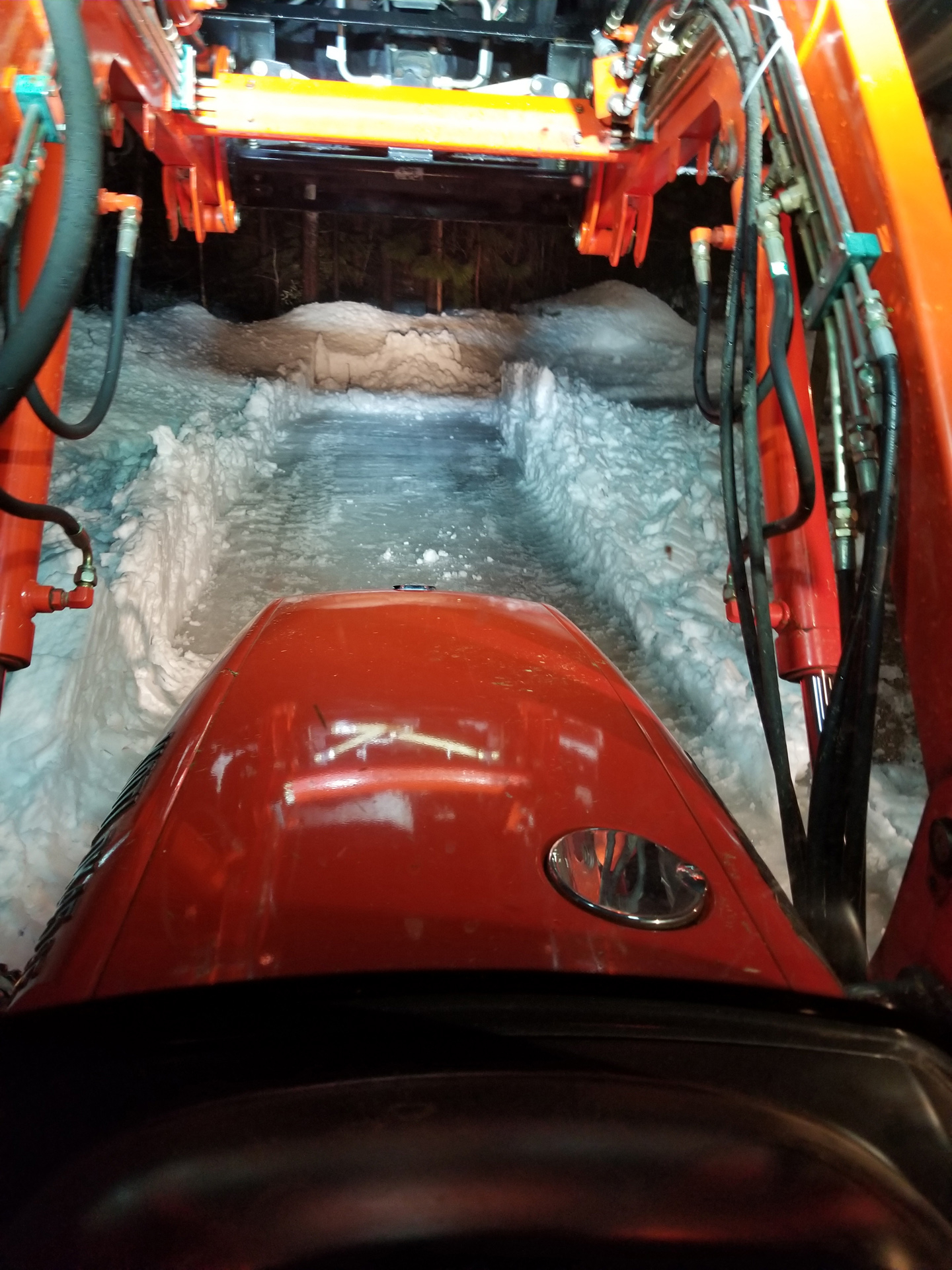

can see quite far in winter snow blowing....very bright. i have to kill upper lights if driving on road in oncomming traffic.
heres a pic from last winter blowing snow.

I replaced the halogen housings with 55w 9" combo flood / spots on the front and rear of my cab 6 years ago. They practically turn night into day. I do most of my snowplowing at o'dark thirty, and the LEDs make the job much easier. I also turn them off on the road, as they are blinding to other vehicles.

My only comment is buy new LED lamps, preferably with CRE SMD's On the Kubota in my signature picture, I have 4 forward facing LED long throw spot lamps and 2 wide angle lamps facing back and I can see at least 1/2 mile with the 4 in the front and they draw less amperage than the OEM halogens did. I got them from Superbright LEDs. and they have worked flawlessly for a couple years now. I guarantee if you turn them on and someone is coming toward you, you will roast their eyeballs. I also replaced the filament bulbs in the grill headlights with LED bulbs and every other light on the tractor as well.
