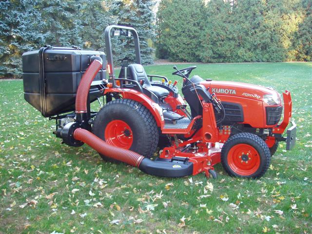

3PT Hitch is a nice way to go unless the machine is too big to lift. Why not just go take a look at a 3PT machine and copy it? Take some measurements and pictures and it should be real easy to do. No need to reinvent the wheel, make it exactly like the factory did and it will work fine. Here is a picture of the pull-type to 3PT conversion I did on my EZ-RAKE lawn vacuum.
