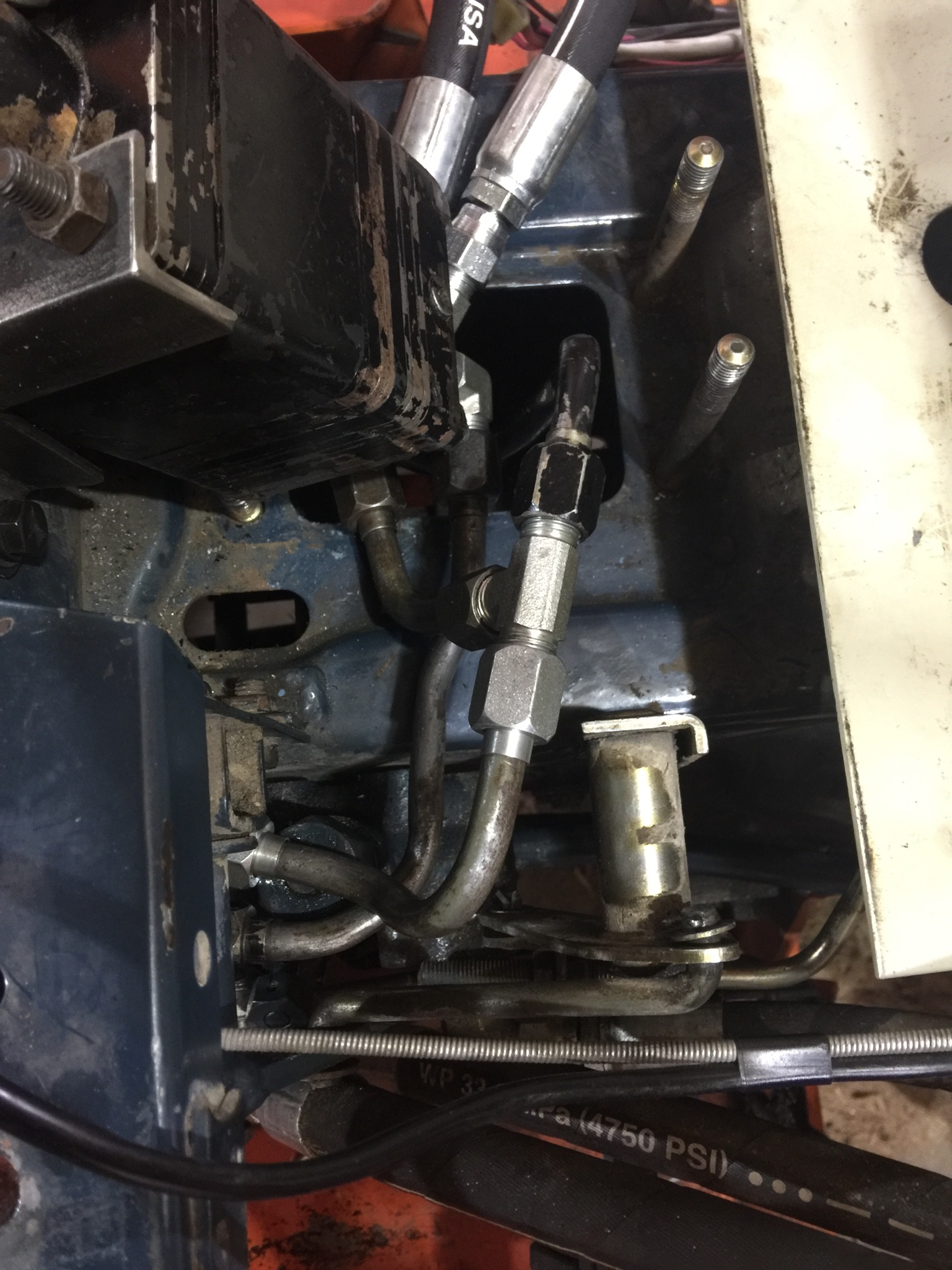

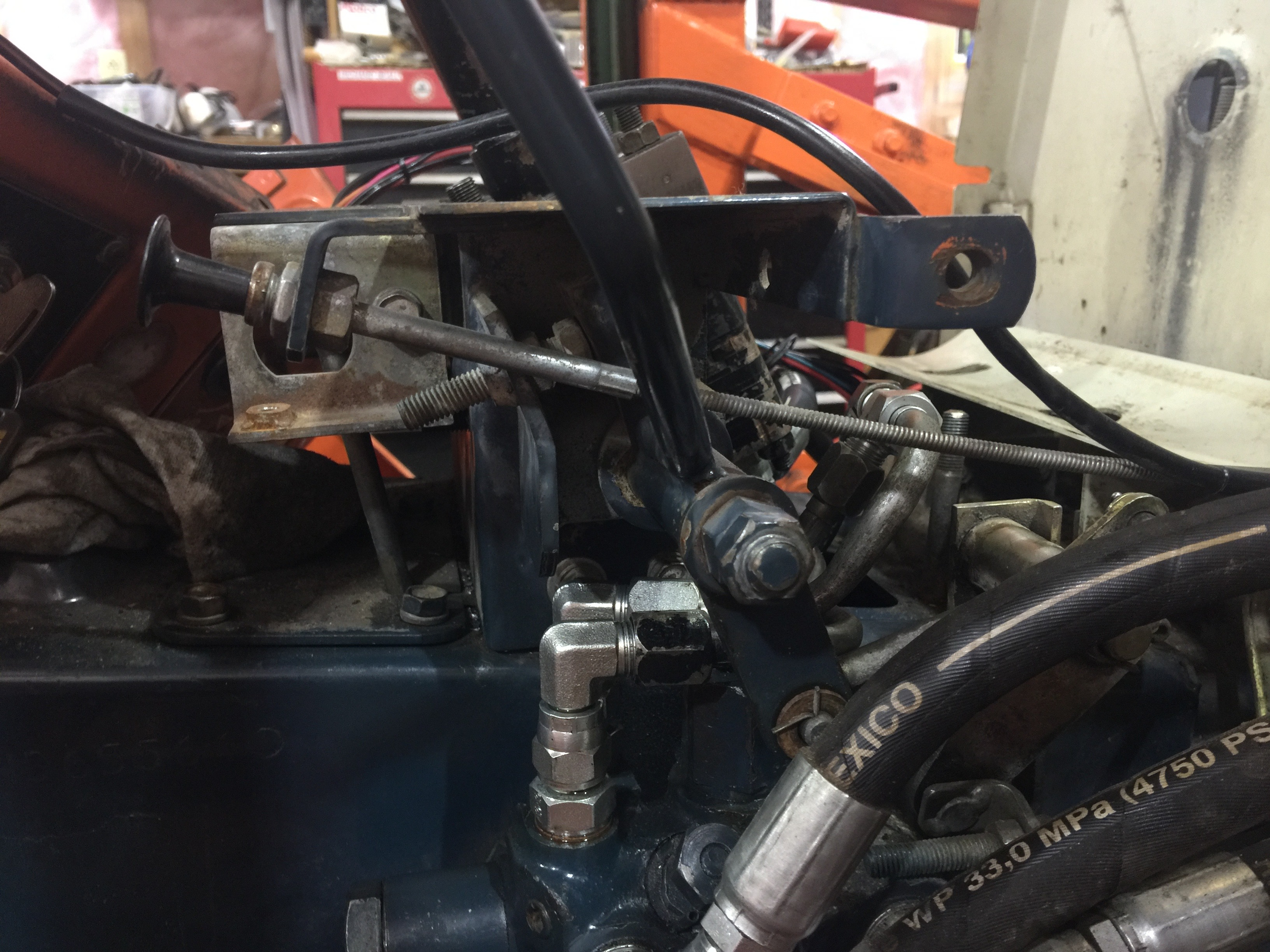

Ecoboast, when I did my conversion I found the use of steel lines much easier for overall space. I also used this company to order the proper fitting from the tractor ports that are British threads to JIC.
