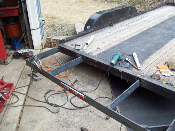

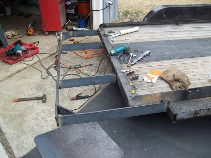

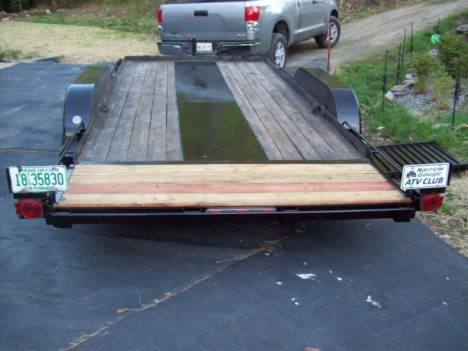

Thought id share...Couldnt quite get the 4th atv on[i load side ways,because of the fenders].Ive got it down to a science drive on use atv jack to roll to rear.With 3 in the last few years,ten minutes im loaded strapped down and rollin:) My oldest daughter now has her own.To haul 4 its either put one in the TUNDRA ,3 on trailer.Now 4 !!Thought about selling my 3 year old big tex car hauler,but id take a big hit,and steel prices are up:( So i bought some steel and added two feet,yes two feet!!Cut off the rear lights etc and added on.Trailer still has plenty of tounge weight
Now the gear and the lab can ride in the bed of the truck,and we can be comfy on our 8 hour trip north we take each summer.My tractor was fine on the 14,but now i will have to upgrade it to look good on the 16:D :D

Nice work. I have thought of doing the same thing to my 18' trailer.
