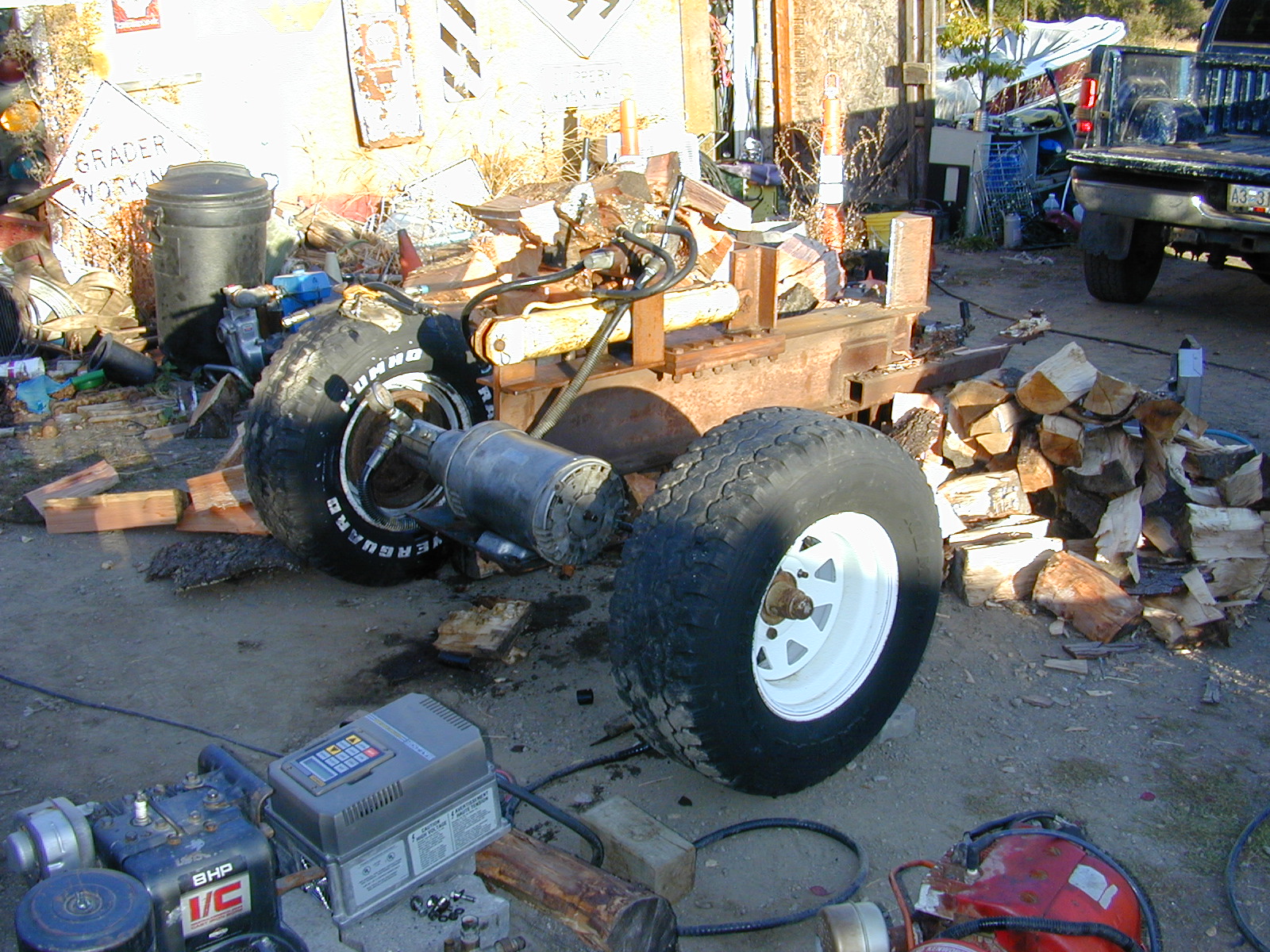

Converted my heavy duty 15 ton log splitter to electric-variable speed drive 7.5hp.

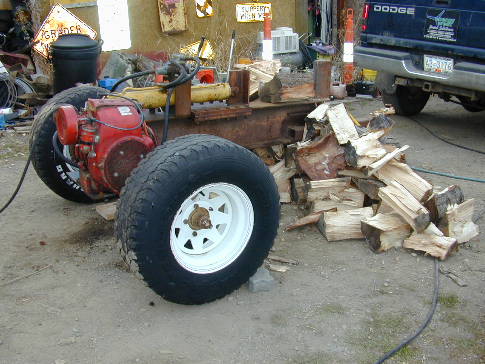

As you may remember my previous posts about this new to me splitter, with seized engine, pipe fittings etc., which I updated with a Kohler 14HP engine. Well, it split fir but couldn't do maple, so I ordered a new Speeco 16GPM 2 stage pump and wow! It didn't even split fur!! Well, turned out that after I put a pressure gauge in it, I found it was only making 1000psi. Thought it was a defective pump then thought to check the relief on the Energy kick off valve. It was set low, I guess so the previous, way too big pump wouldn't stall the engine. Cranked it in all the way and wamm! Made 5000psi. Ooops. Finally got it dialed in at 3000 and it works 100%. Splits all the big maple pieces now and all at just above idle on the Kohler. So I now know this engine is way too big for the pump, so I thought again about converting to electric, for a quiet, no maintenance, no exhaust splitter I can use in my wood shed. Here is what it looked like before I removed the Kohler. Note the new tires/wheels. Gets it up another 2" off the ground and puts everything at a nice height.

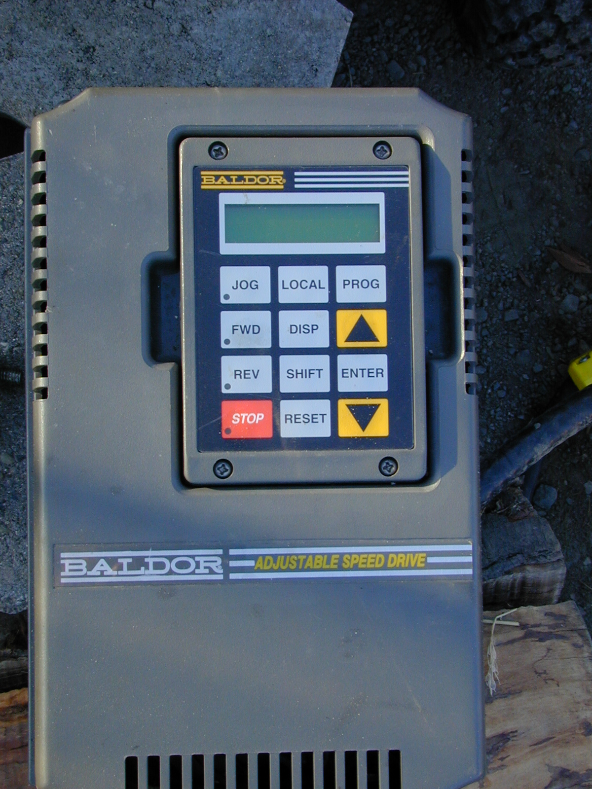

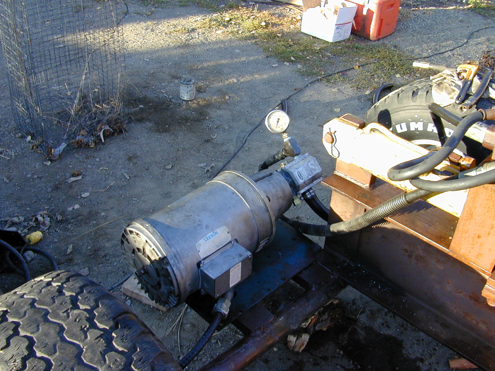

So I went to the local auction and found a nice big 7.5HP 3 phase electric motor attached to a big triplex pressure washing pump from a commercial installation, all mounted on a stainless chassis. Cool! $20 and it was all mine. I had already bought a Baldor 15H series 3 ph variable speed drive controller 2 years back, again dirt cheap at under $50, same auction place, and knew one day I would be able to use it. Well, this was it. I read the manual thoroughly and found it was a completely modern 5 year old 3 phase speed controller, as well as CONVERTER. It can convert from single phase to 3 phase. NICE! :dance1: The electric motor and pump even came with an L-099 Love Joy coupler and pump mounting bracket, which happened to fit the Speeco pump perfectly, after I drilled out 4 new holes. This was coming together nicely. I had no idea if the motor or controller worked, they may have all been burnt out or damaged, but after wiring everything together, I reprogrammed the Baldor controller for correct motor size and settings, fired it up and YES! It worked 100% first time out. Very cool. :thumbsup: It can generate any speed, varying frequency from 0 - 120Hz, which gives me 0 RPM to 3450 RPM. the name plate RPM is 1750 on the motor, and the Baldor rep said no problem doubling the speed up.
So now after 3 days of testing, and generating a big pile of split maple, I find that 89 Hz gives me 2900 RPM, is a quiet non resonant speed, and when the ram dead heads, makes 3000psi and peaks 25A on the primary input side of the controller. Otherwise, the idle current of the controller is 7A with no load or splitting easy wood. I ran an 8/3 cable out to the shed from a 40A breaker in the shop, and now have a beautiful, quiet, efficient wood splitter. Although still portable, it will probably just end up living in the wood shed. With a 3.5" cylinder on it, this is a 15 ton splitter, which seems to be plenty. I thought I would need a 25 ton plus to split this nasty maple but this does the job nicely.
Just need to buy the correct fittings to replace the pipe fittings, paint it and it's done.

I think you did a great job, at a very reasonable price. My only suggestion would be, change those fittings right away, before anything happens.

I like your electrical set up with the speed control. These speed controllers, as you probably already know,need their air to keep from running hot. We used to have to blow out the vent holes & fins at
a commercial laundry to keep them cool. Of course that was heavy use with 20 hrs daily or more. You said yours was a converter built in, that's a nice setup!!

Pretty cool. Electric spilitters are popular in Europe. Did you incorporate a switch into the hydro valve /lever assembly to enable the motor only when it's needed? With the freq drv you should be able to put in a nice ramp setting so when you push the lever, it comes right up smooth. I assume you ran 240V? Most standard drives can be fed single phase, but not all can maintain their rated load if fed this way. You should check if it has a derating when run that way. Keep us posted!
Hey, now that's a great idea. There are 15 I/O on it and I'm sure one of them would allow such a function. Good thought. I have lots of micro switches in my stock of valuable crap. Would be a great way to run it. Yes, this unit has a TON of bloody functions in it, slow ramp up/down, variable torque, slip compensation...and it goes on.....It's really way to much for a splitter, but it's what I had in stock. :laughing:
Yes, I feed it 1P 240VAC, and it's derated 40% for single phase feed. It's rated for 7.5HP in variable torque mode and I programmed it so it's only 5HP, which maxes the current at 21A. After 1/2 hour of running, everything is really cool to the touch. Nice!
