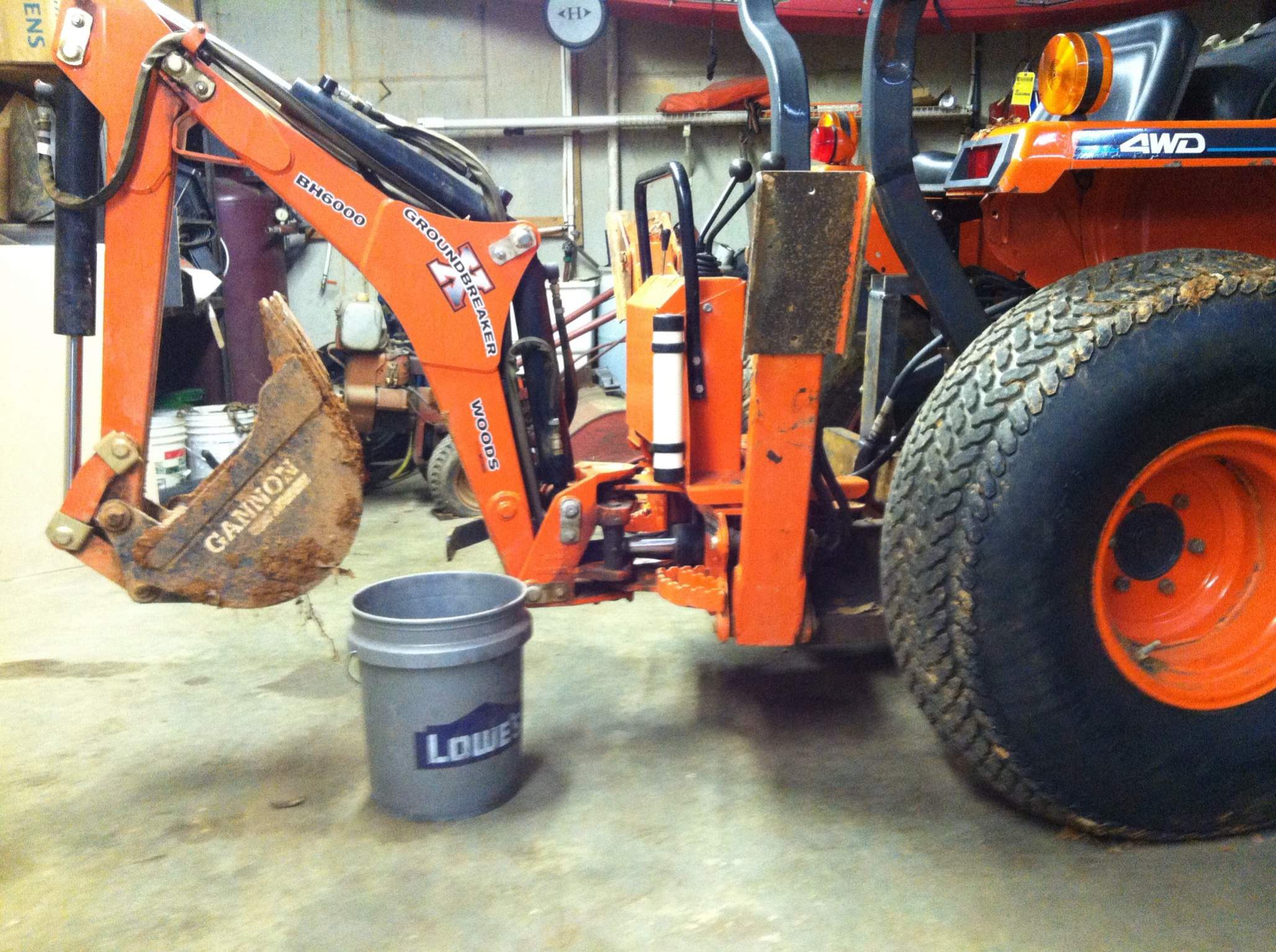

Converting 3 pt woods 6000 backhoe to subframe mount

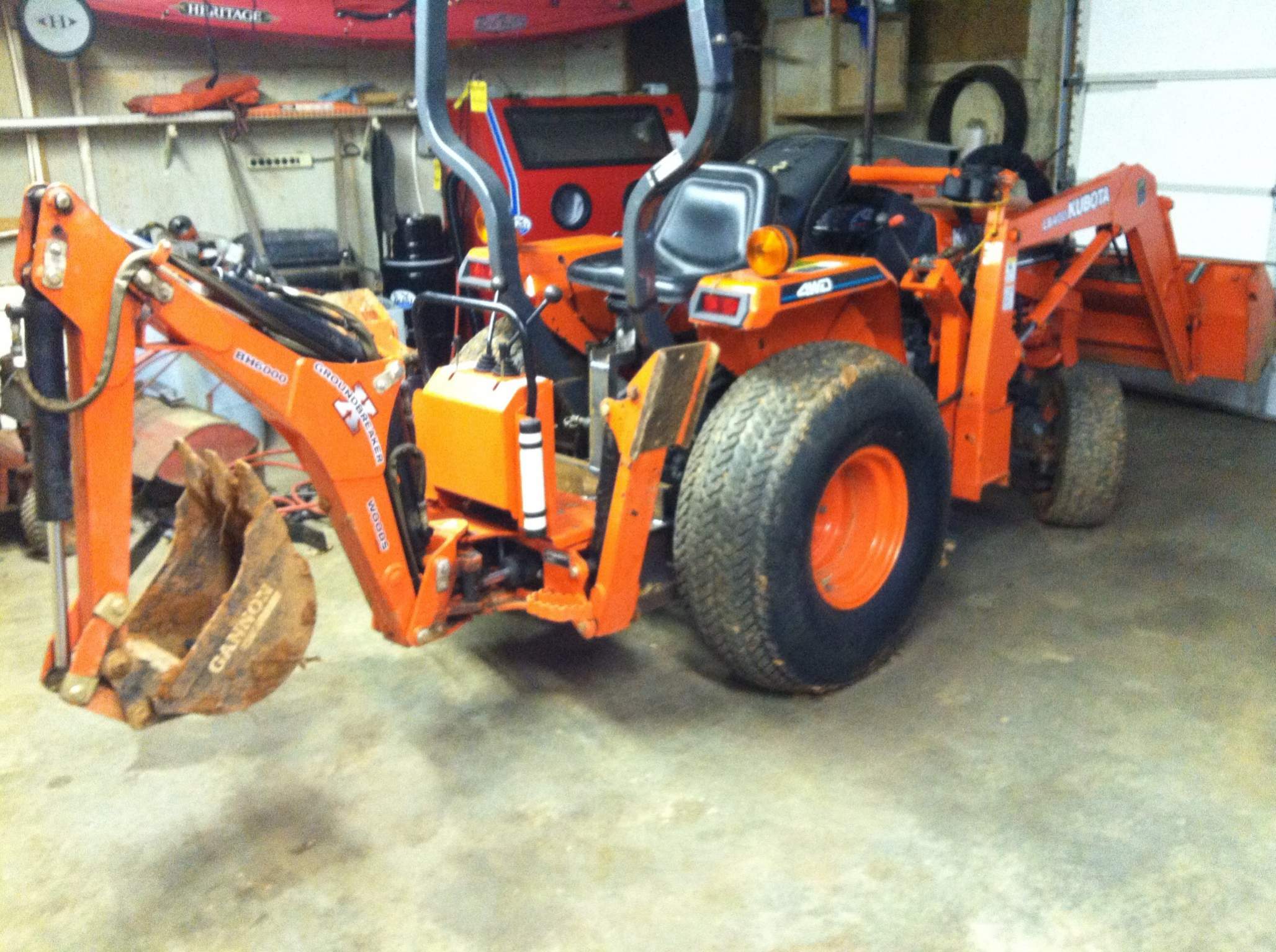

I have a kubota L2600DT and found a Woods Groundbreaker 6000 3 pt mounted backhoe in Kubota orange for a price I couldn't pass up. I've used it for the past year as purchased but knew it was limited due to the mounting arrangement and finally just grit my teeth and spent the day doing the retrofit. I spent plenty of time researching this and there are a few good threads here, dfkrug probably has the best and most documented installations, as well as mng whose design I somewhat mimicked. There are those who design and install their subframes with the desire to leave their 3 pt arms in place. I chose to remove mine for clearance and fewer obstructions. Also worth noting is that I did not want to hang the unit from the 3 pt pivot pins on the rear axle. I took the dfkrug/Bradco installation method which is to attach to the ROPS plates on the bottom of the axle and tie to the FEL subframe toward the front.

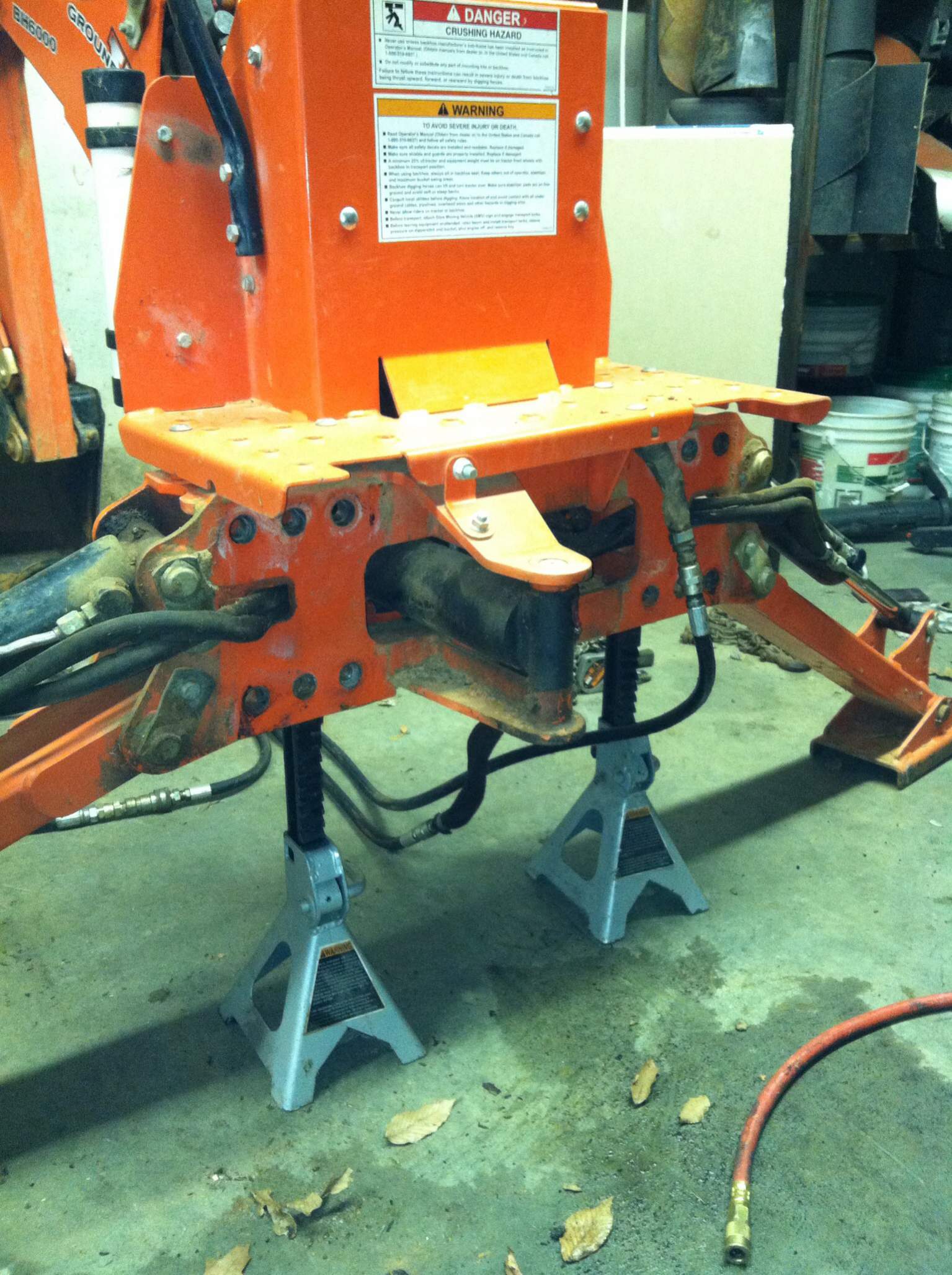

Here's the backhoe

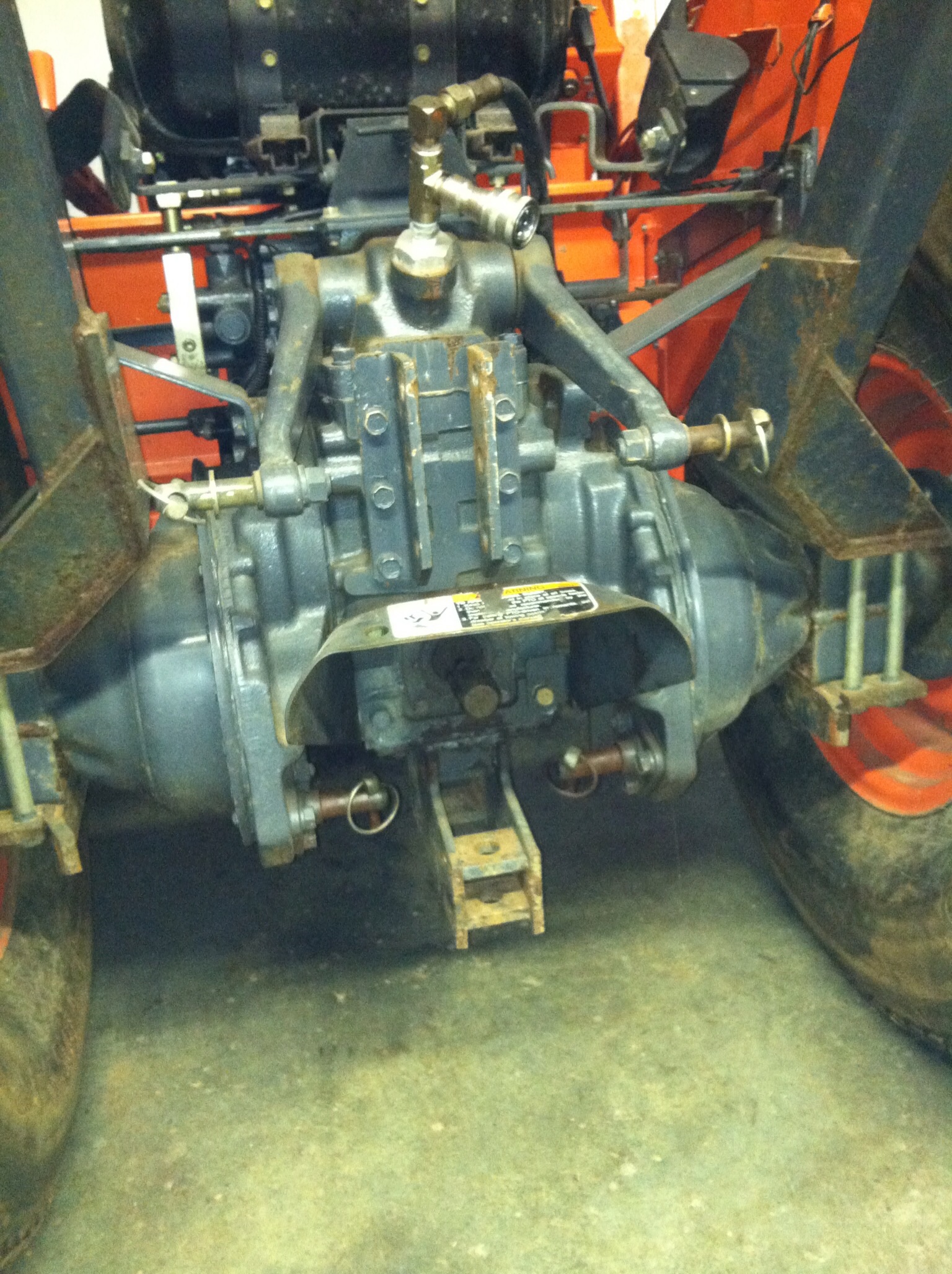

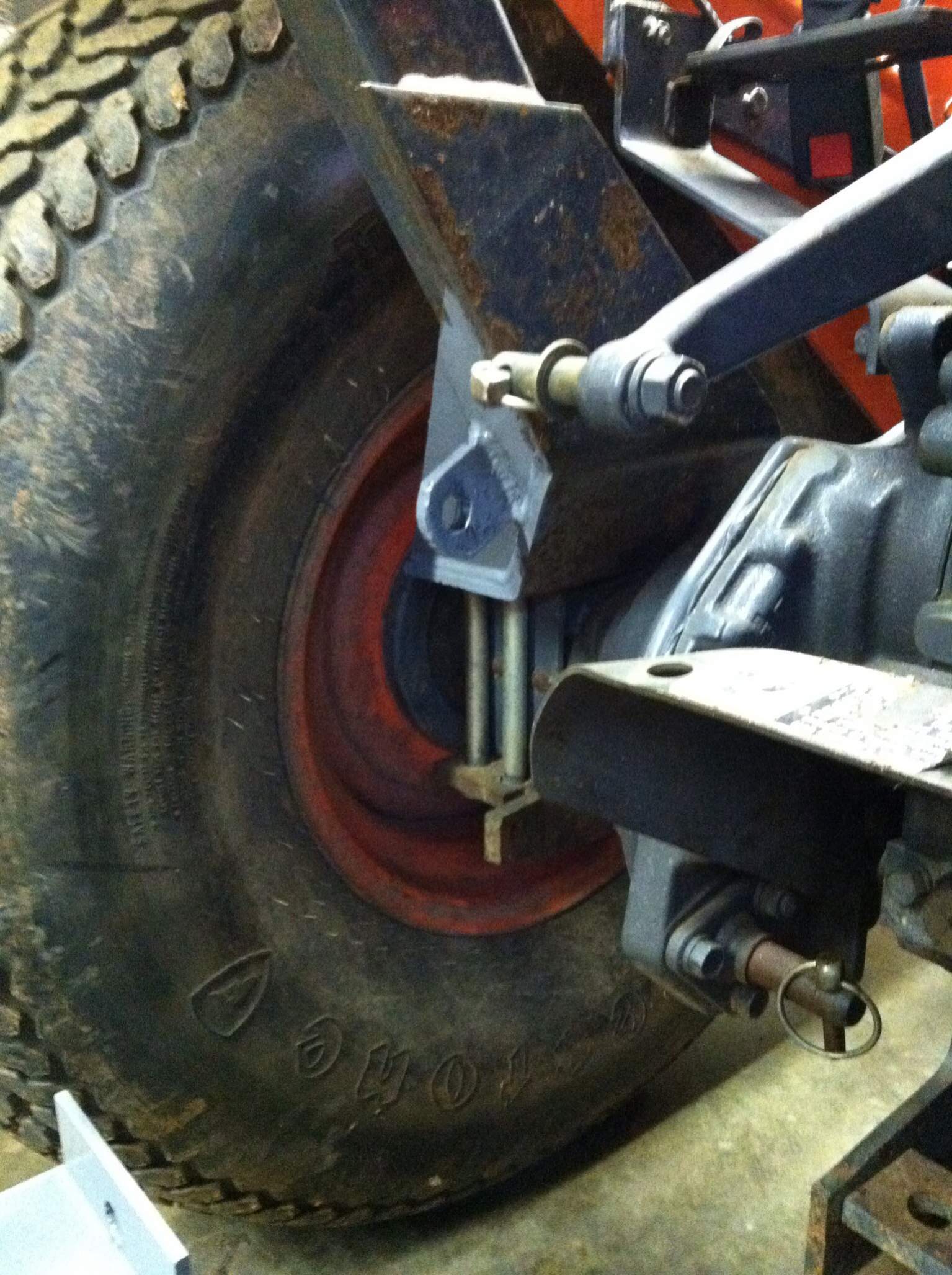

And the rear axle

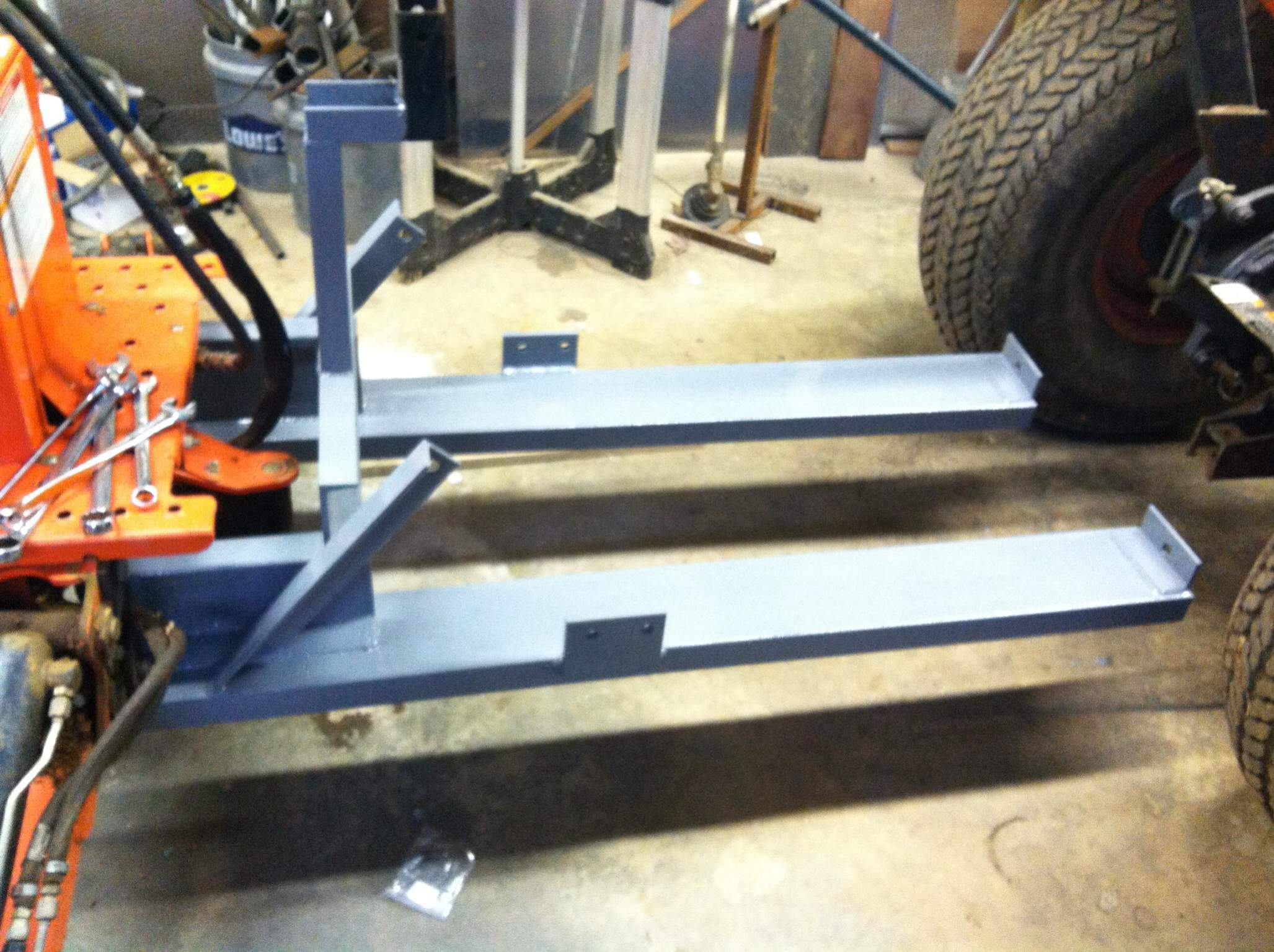

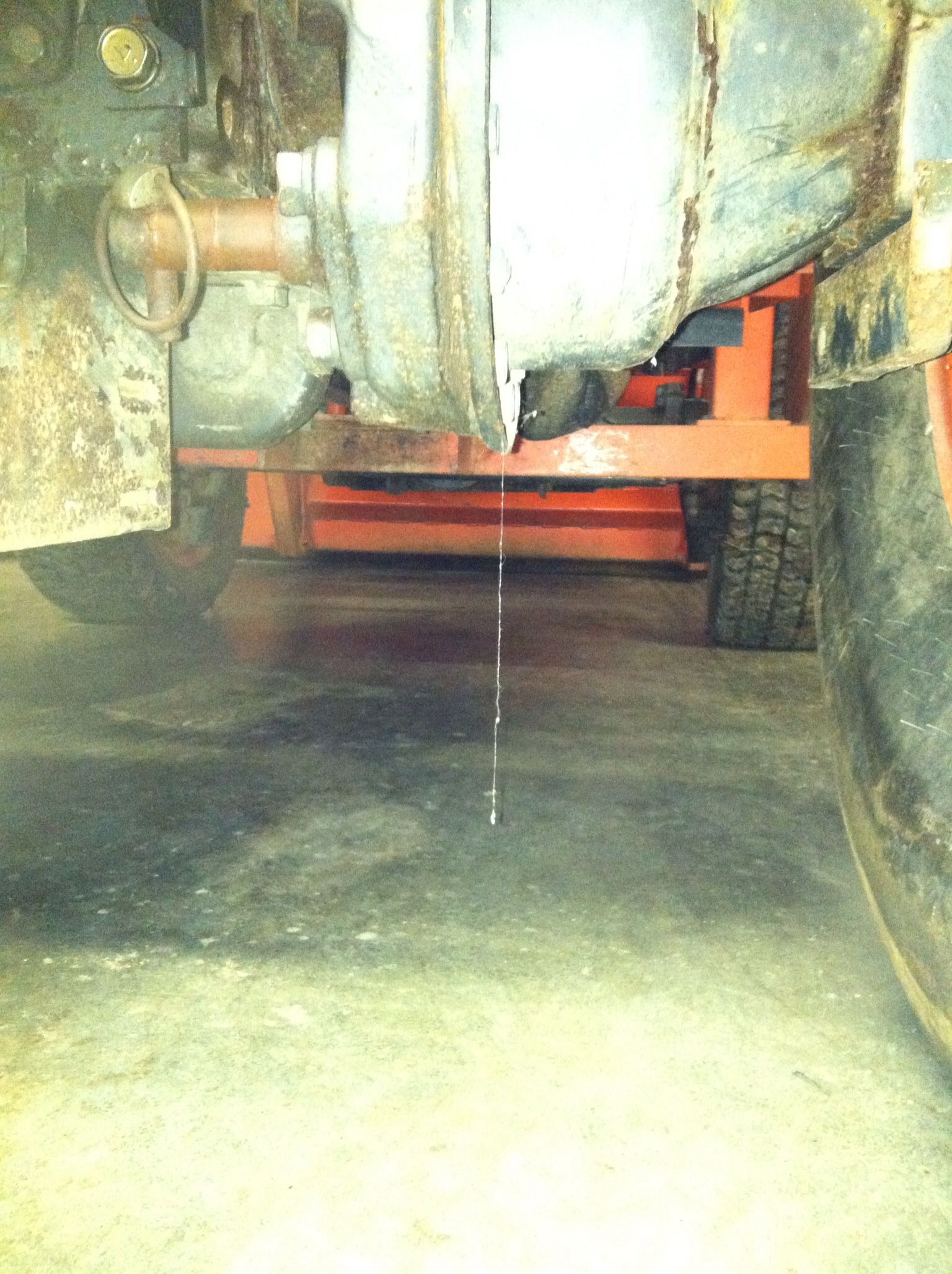

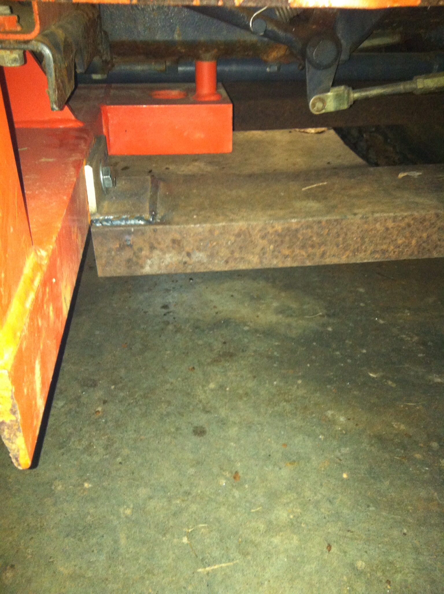

This shows the path the 6" channel will take under the tractor. Note the plate I attached to in the upper right of the picture to the orange horizontal member of the FEL subframe.

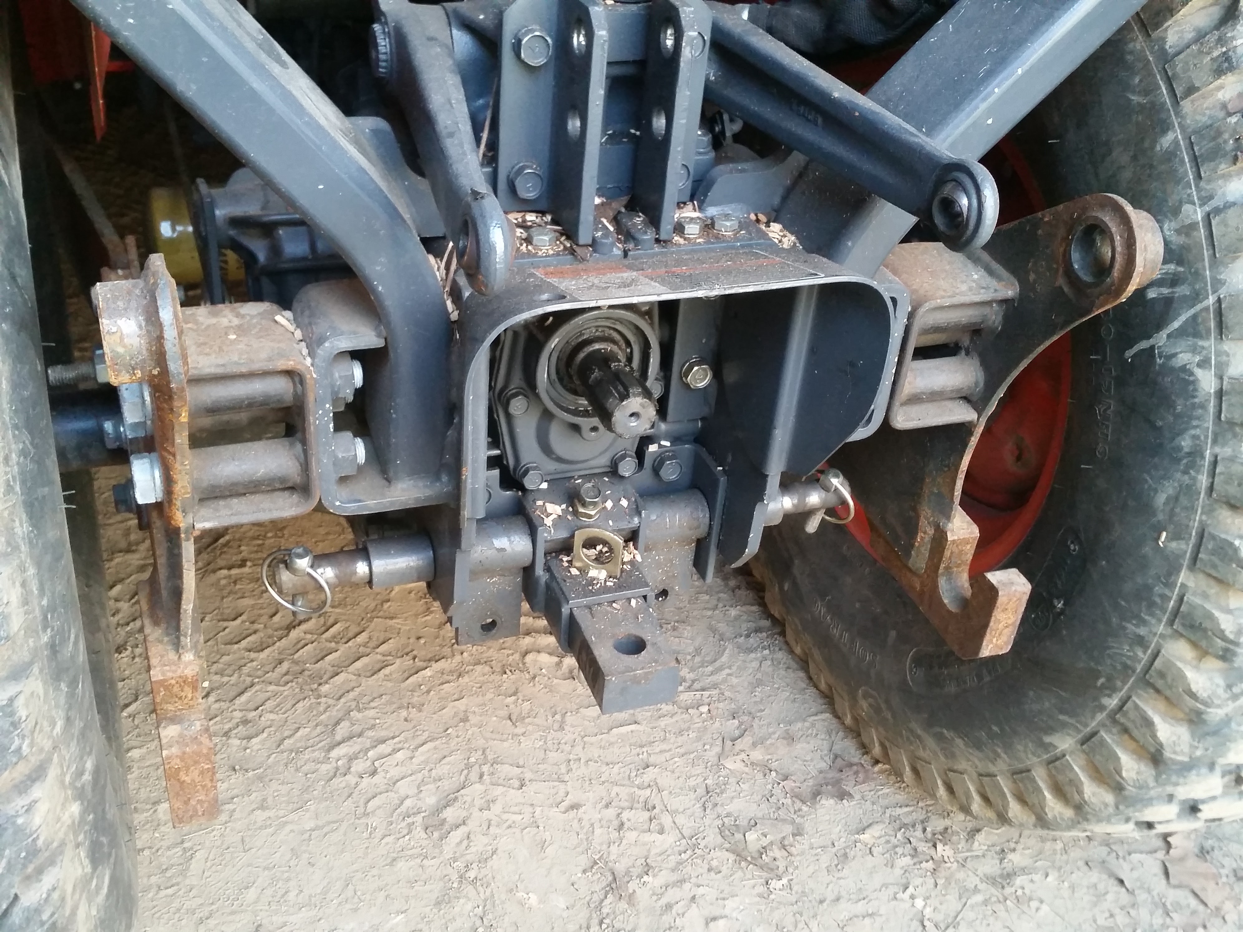

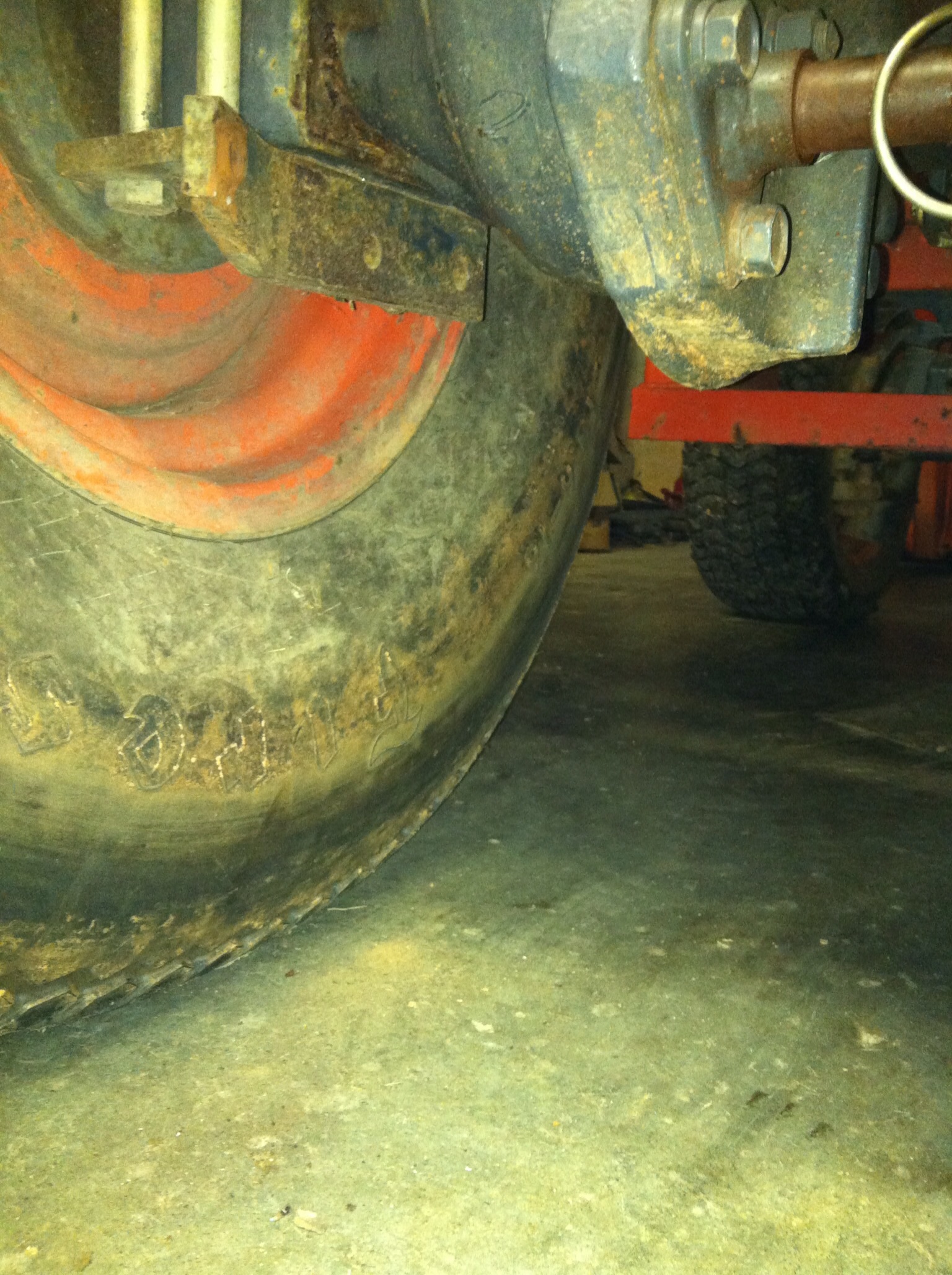

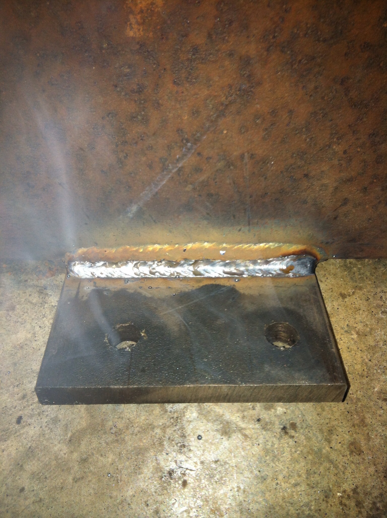

In order to attach the 6" channel to the already existing mounts on the ROPS here's what I did.
And the mandatory weld bead
Here's the front bolted connection
In reading various posts and the manual I decided to set the height of the backhoe at 12" elevation. I was also able to tuck the unit substantially closer to the rear of the tractor as recommended. Here's a look at what I finished up with. I placed a 5 gal bucket in the frame for reference.

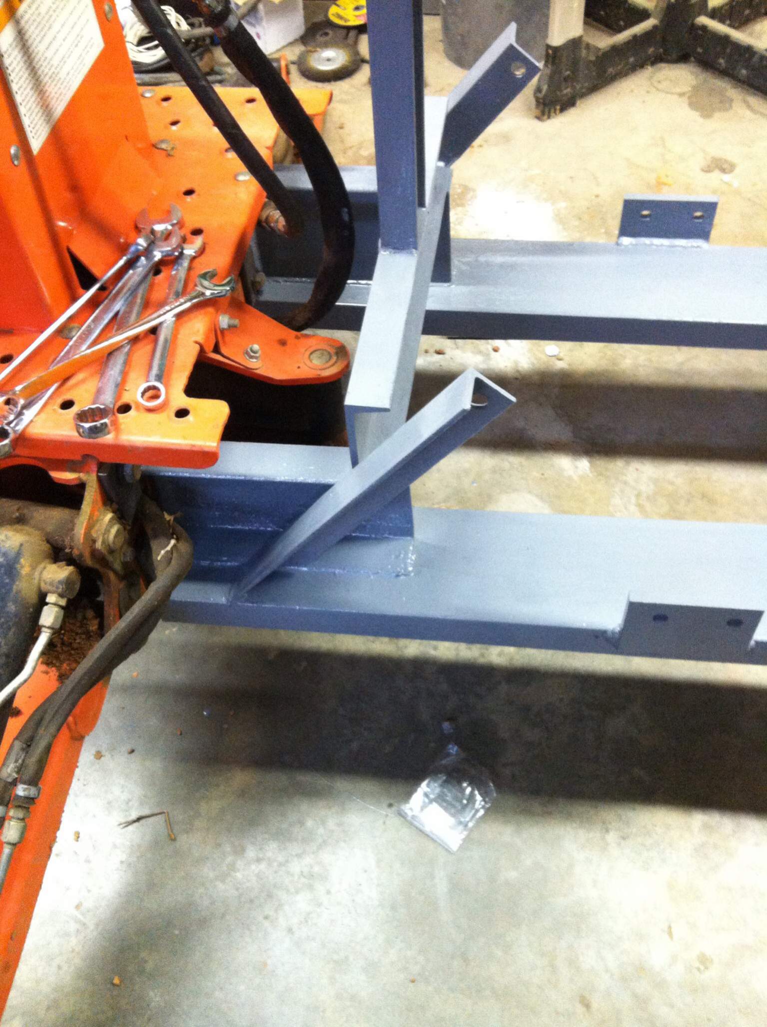

Here's a picture of it off the tractor and in paint. Note the angle braces that tie into the ROPS bar. I dug 3 stumps out with it today and you could have easily buried a cow in any of the holes and it passed with flying colors. Anyone need a 3 point adapter? Looking to sell the one I replaced. And thanks for the comments guys!

I've got nothing attached to where the top link goes. I can tell you that the tensile load while digging is transferred via the diagonal braces to the ROPS tie in's. I've also used 1/2" diameter grade 8 bolts with the thinking that these would be the weakest link and fail well before any structural damage were to occur.
I'll use it some more and report back. Keep the comments coming

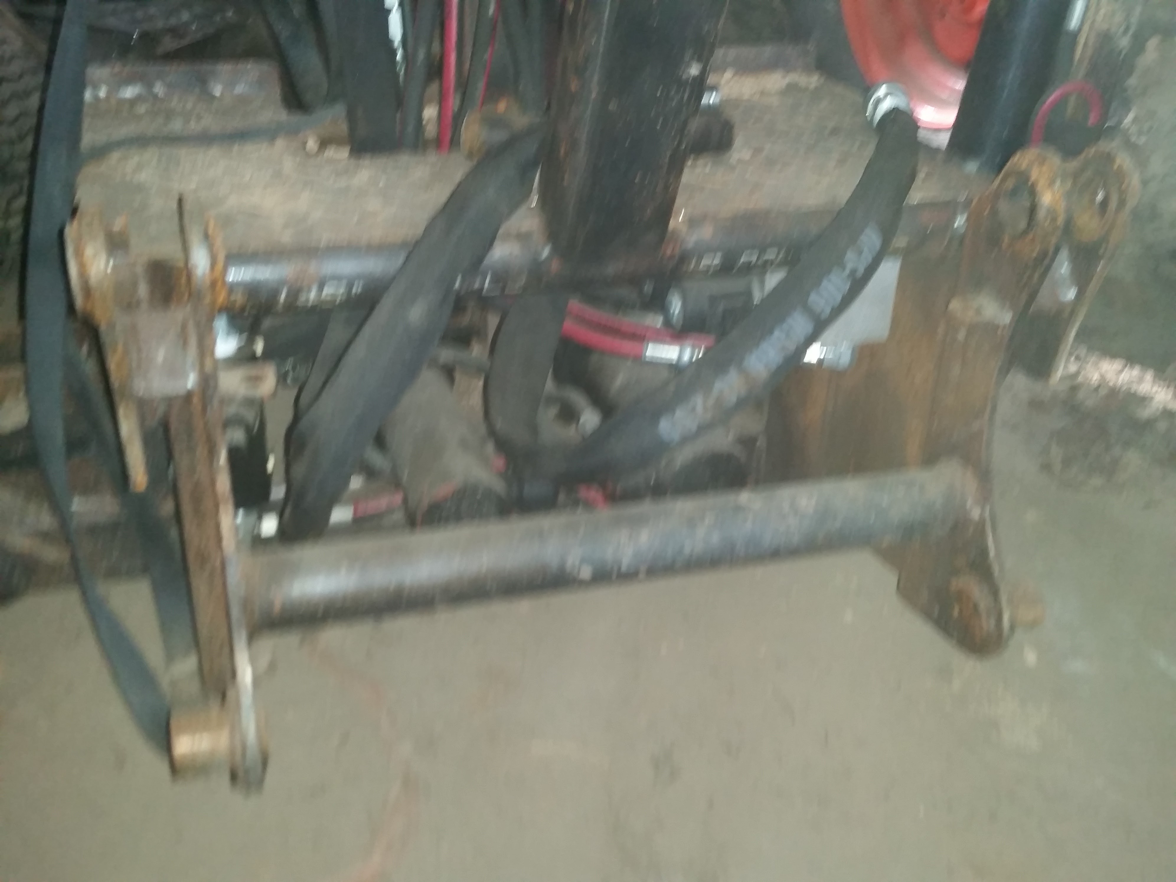

Looking good, when I built mine I kinda copied kubota and made the subframe stay with the tractor and the bh a 4pt quick attach.
Tractor side.
Backhoe side
It ties into the loader frame, ROPS mount, and rear axle. 2pins and 2 hoses, 1 electrical connector and it's off.
