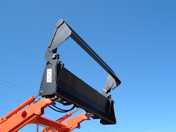

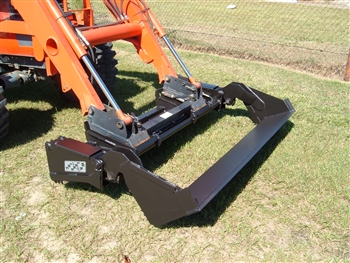

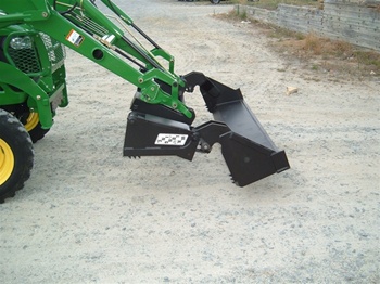

Edit: Some interesting pics of 4 in 1's:
Photo Gallery

I agree that a dozer blade would be a good start as it would have the designed strength for the "push mode" and the rest of the bucket could be built strong enough. The angular shaped cross section of a conventional bucket gives it strength in both directions but that is lost if a bucket would be cut apart to make a 4 in 1. Torsional strength comes into play also if trying to "grapple" an object at one end of the bucket.
I've noticed that the 4 in 1's on the market are at about 60" for narrowest width available. I could go to a 54" probably but a 60" is starting to get a little wide.
I agree that weight is definitely an issue especially with my little B9200 and BF350 loader. (350 kg rating) May have to build this puppy out of titanium. :D I don't have quik tatch either so a 4 in 1 would serve as a mini grapple as well as bucket.
