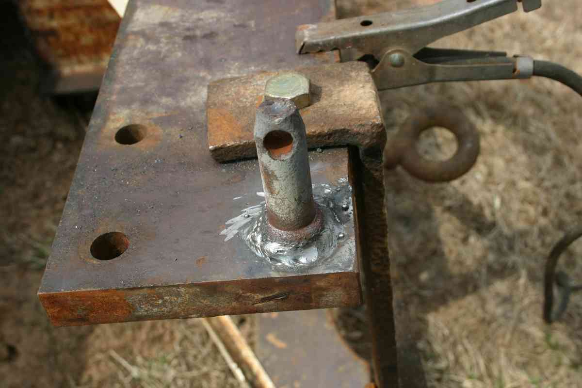

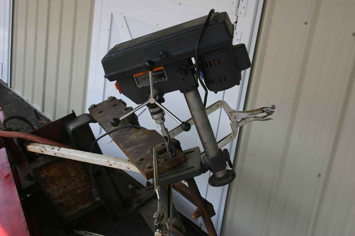

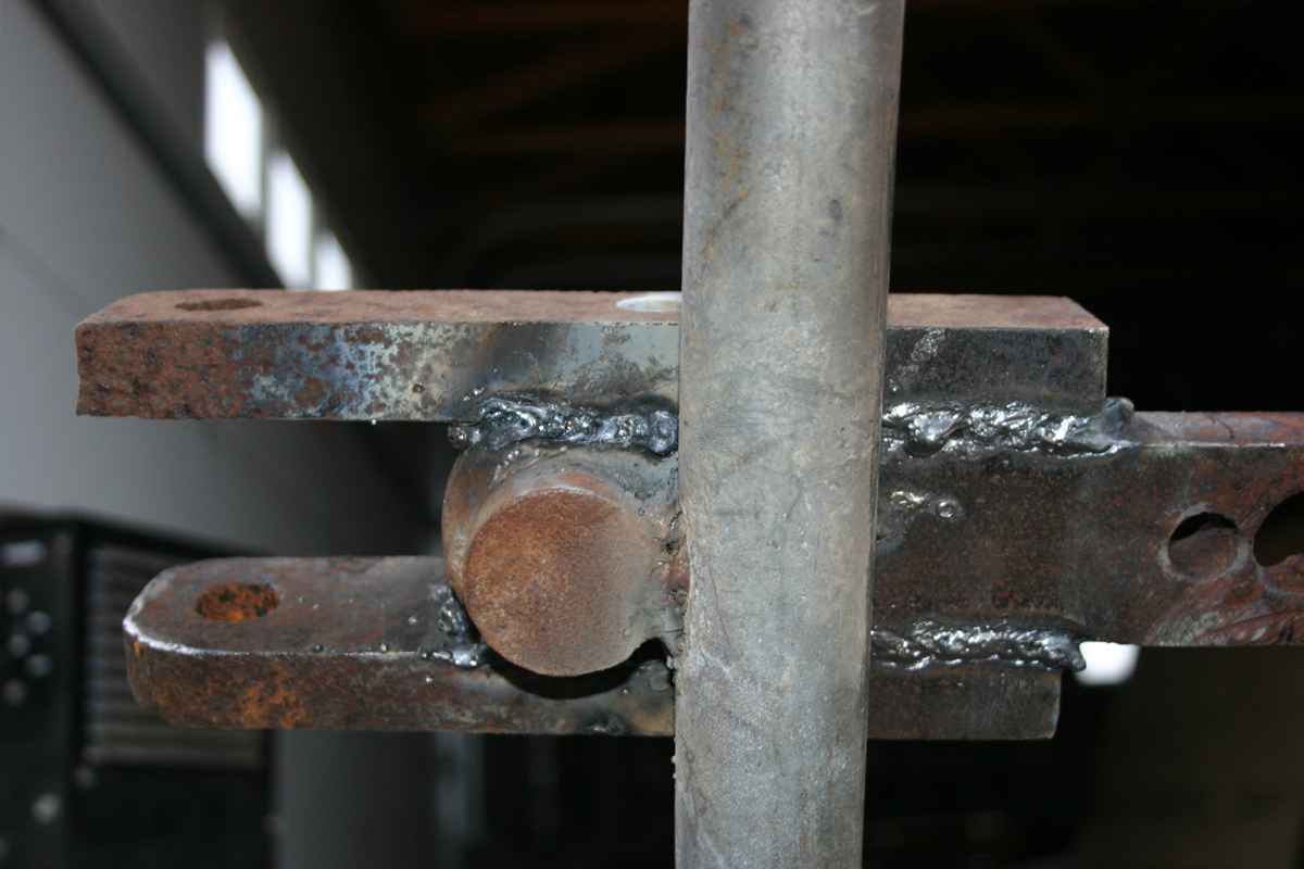

I found a reasonably priced post driver but it was setup to mount on a FEL. The guy would take the bucket off and slide a pipe though the bucket mount and the pipe on the post driver. He then had a single tilt cylinder so he had a big screw eye in the one of the holes going down the center. He could then tilt that thing any angle he wanted. Well I wanted to put it on my 3PH so some modifications were in order. First I need to mount pins. well the holes on the side plates were 3/4" not the 7/8" I needed. My first thought was to mount my benchtop drill press to the side plate and go at it. You can see how far I got before the drill press gave up.

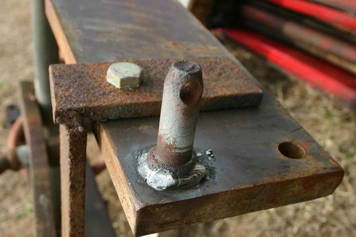

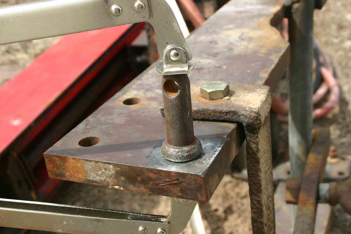

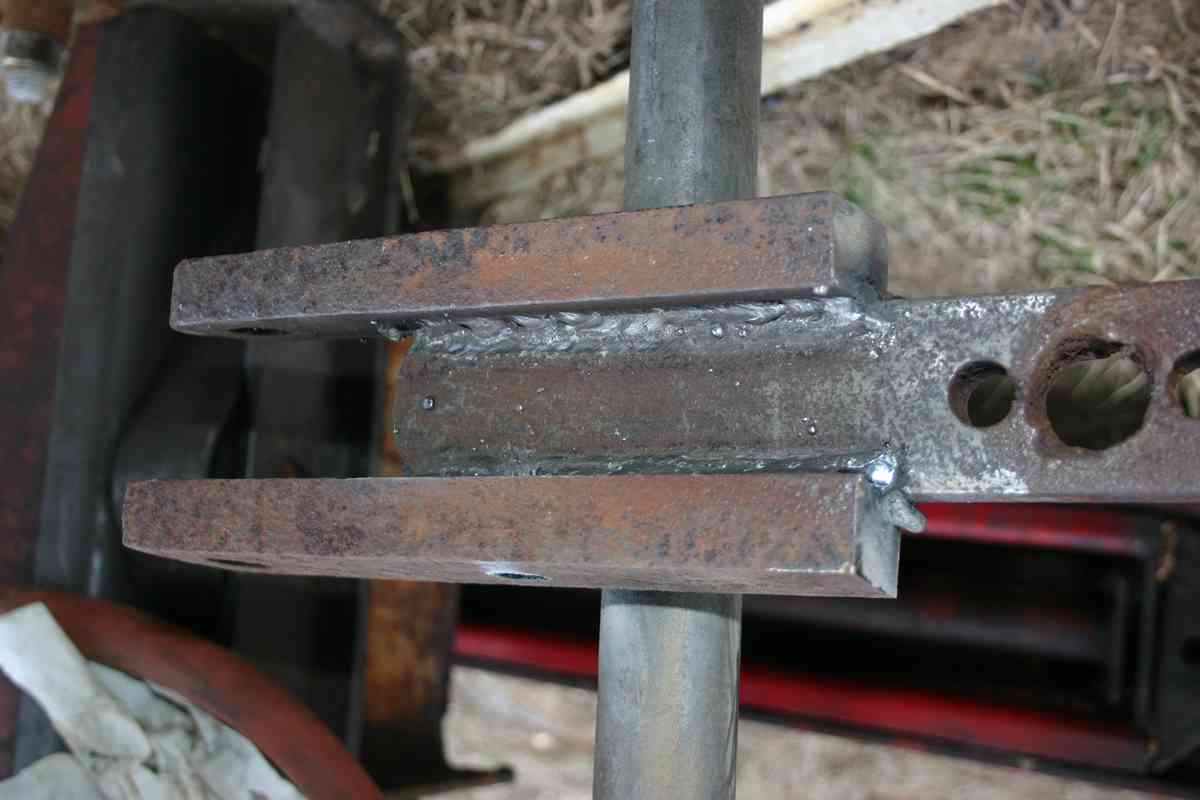

well J_J had the idea to weld the pins on. So that was the next step. I probably shouldn't be showing pictures of my welds. I will be checking them periodically when using the driver. I hope they hold.

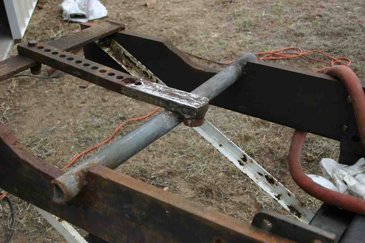

Then came the top link mount. I found an old draw bar that had just the right size holes on either end. I took a sawzall to it and a grinder to clean up the rust. I then clamped it to the center support and tacked it on. then the mistake happened. I took the clamp off pulled the pin out of the top and proceeded to finish the welds flipped it over and welded the other side. So all you welders know what happened. The pieces moved just a little with the heat and the pin would no longer go through. Fo once a dremel tool came to the rescue. I carefully ground out the holes a little and the pin fit once again.

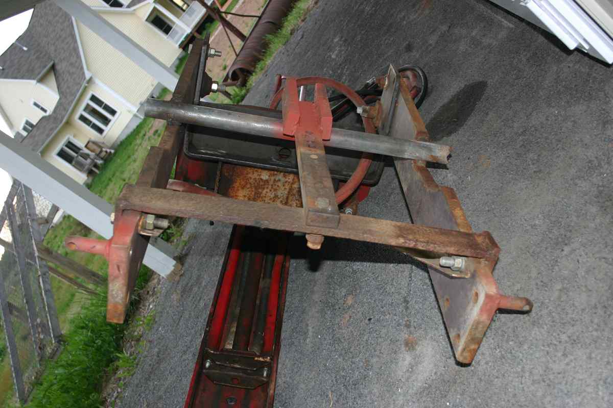

Here is a final picture on the modification. Now I just need to figure out how to stand it up so I can attach it to the tractor.
