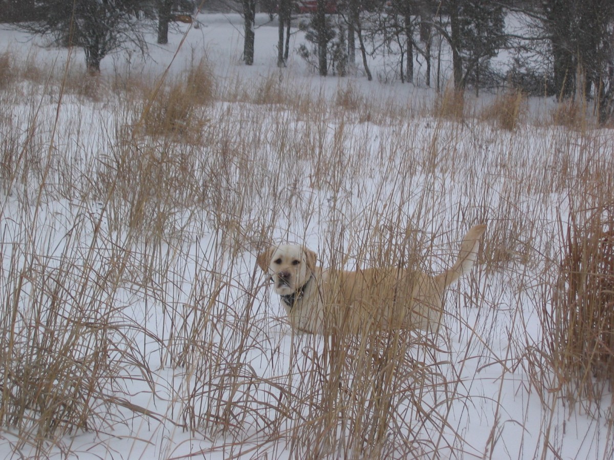

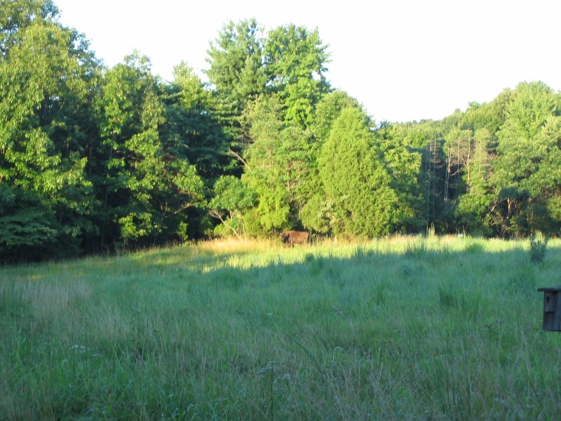

Back in 2001 (I can't believe it has been that many years!) we converted a 4 acre hay field to prairie grass, to improve wildlife habitat and to attract quail. We had released a couple of coveys of pen raised quail and they left in short order. Had the DNR out and they said the fescue had to go and to plant a native grass mix for our part of the country (central Indiana).
I mowed the field in late fall and applied Roundup as soon as the grass started to grow. I then rented a no-till planter from the DNR and planted the seed mixture from Sharp Brothers (Native grasses: Producing & Harvesting Quality Seeds since 1958). The prairie grass took off and we enjoy it summer and winter. It is simply beautiful and the birds, turkey and deer love it.
But no quail. I'm still fighting the fescue. I didn't get it killed that first year and I'm still working on it. If I were starting over, I would have been more careful in the initial stages.
So my advice would be to check with your DNR. They may have a program available to help you with the conversion.
BTW, the picture of the grass in late summer was taken when a bison wandered through one morning. He had escaped from a farm a couple of miles down the road.
