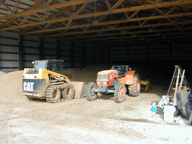

I am in the progress of restoring my lower 20 acres of pasture from weeds and foxtail to grass hay this summer. Next year I will do the upper 20. I have the lots of 4-20” rocks. Most of these rocks are in one area of the pasture. The pasture has been picked before but I wouldn’t want to run any equipment over it yet so this month I sprayed it with roundup and it is wilting away now. I don’t really want to plow it because I’m afraid it will just bring up more rock. This is what I’m thinking. First sift the larger rocks off it with my sifting bucket then use the flail mower to break up the dead grass. This is the part I need help with. Should I use a chisel plow with the spring teeth or can I just run a disk and harrow over it? I don’t have a chisel plow, disk or harrow yet. I would like to get away with buying the least amount of equipment I can. I have never plowed or ran a chisel and have little experience with a disk so I’m hoping someone that knows what the right equipment to use is can point me in the right direction. I have at my disposal the Kubota M9000, the Cat skid steer, a sifting bucket, tooth bucket, a small ripper attachment for the skid steer, and a leveler blade or as some call it a land plane.

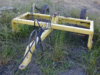

Sorry about the small picture I didn't get my resize working right but you get the idea. This is a picture of my leveler that my brother and I built about 4 years ago. It levels out my chicken barns great.

Nice looking equipment. It would also work very well on road maintenance.
Mith -- Take note!

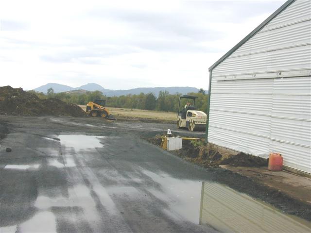

That leveler has been great. You just set the height and go. It knocks of the high spots and fills in the low spots. There isn’t any down pressure except for the weight of it but it still works really well. I built it for about $400. The next year I separated one of the wheel legs and put a hydraulic cylinder on it so now I can go up and down and side to side. I included a picture of when I was building a new road and manure barn this past fall and used it to level out the rock. We had rented a ride on compactor that we rode around after everything was leveled out. For several days we had gravel delivered, then I would level and grade it, then we would compact it.
