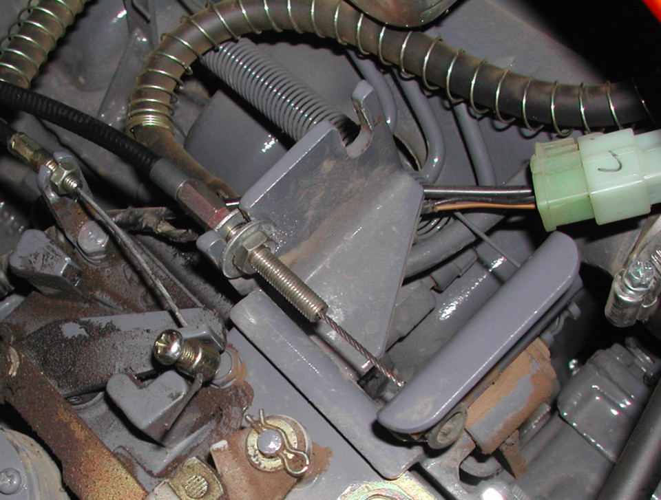

My tractor is a HST, but you still need to set the engine speed on gear
tractors when using a hoe. First photo shows where the cable acts on the
FI system. Two cable controllers can be used, retaining the dash-mounted
unit, or using a foot controller. I tossed my OEM dash-mounted unit
because I stole its friction disk.

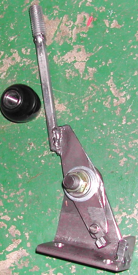

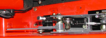

2nd photo shows the raw weld-up. This bracket will be mounted inside the
frame that supports the 3-pt lever and the AUX hyd lever(s).

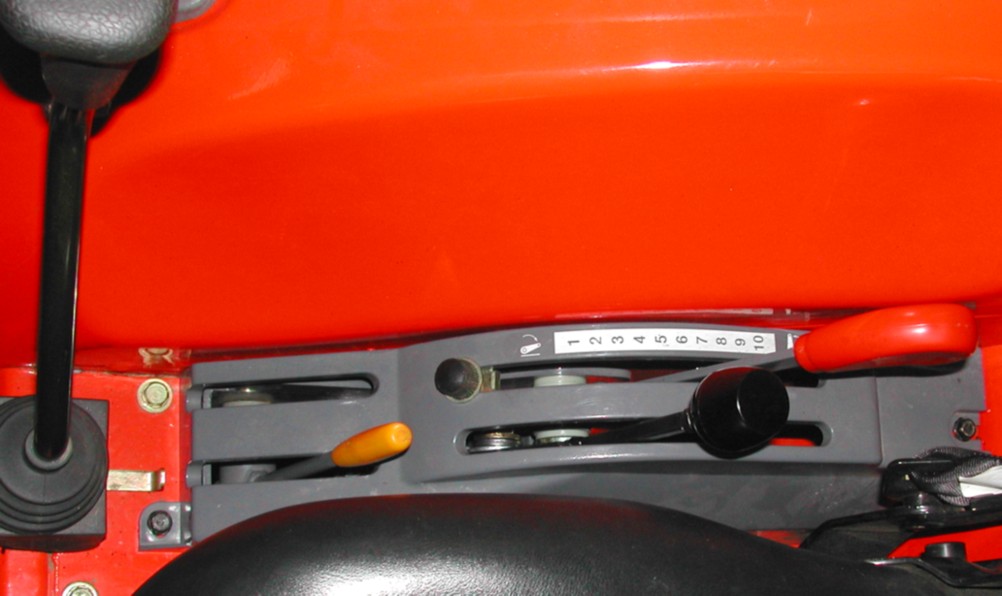

Final photo shows the finished installation. My new lever operates in the
slot reserved for the draft-control lever. Works great!
