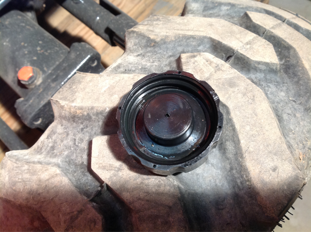

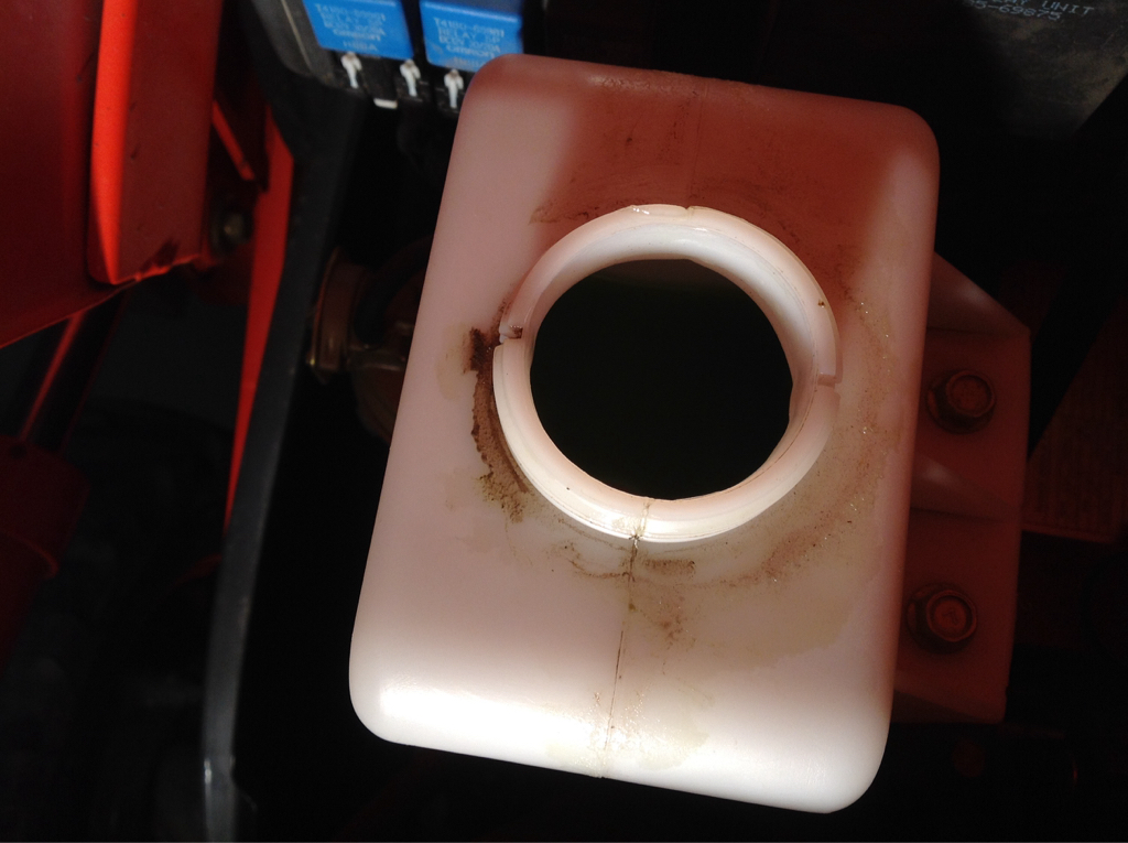

Joe, I'm not sure if you have the same coolant overflow set up as my 2012 CK35hst. I have had the same symptoms since new, anti-freeze smell and coolant level going down in the overflow tank. The anti-freeze smell was coming from coolant dripping on the injection pump. The anti-freeze was coming from the slots molded in the male threads on the overflow tank. The coolant is going through a hole in the cap gasket, into a sponge. If the sponge becomes saturated enough and will no longer breath, coolant will be forced from the sponge through a hole in a metal washer into the dome of the cap and out the slots in the tank threads dripping onto pump.
I questioned my dealer about this setup so we opened up some hoods and found 3 different ways of dealing with overflow. One with a hose coming out the center of the cap and one with a hose high on the tank, both were draining below the frame to the ground. And my setup.
I have found that the amount of coolant coming out the cap depends upon how much fluid is in the tank and how much it sloshes. It eventually reached a level low enough that no more fluid comes out the cap. This level is the LOW mark on the tank. So this is where I keep my anti-freeze filled to and just keep an eye on it as with all fluids.
