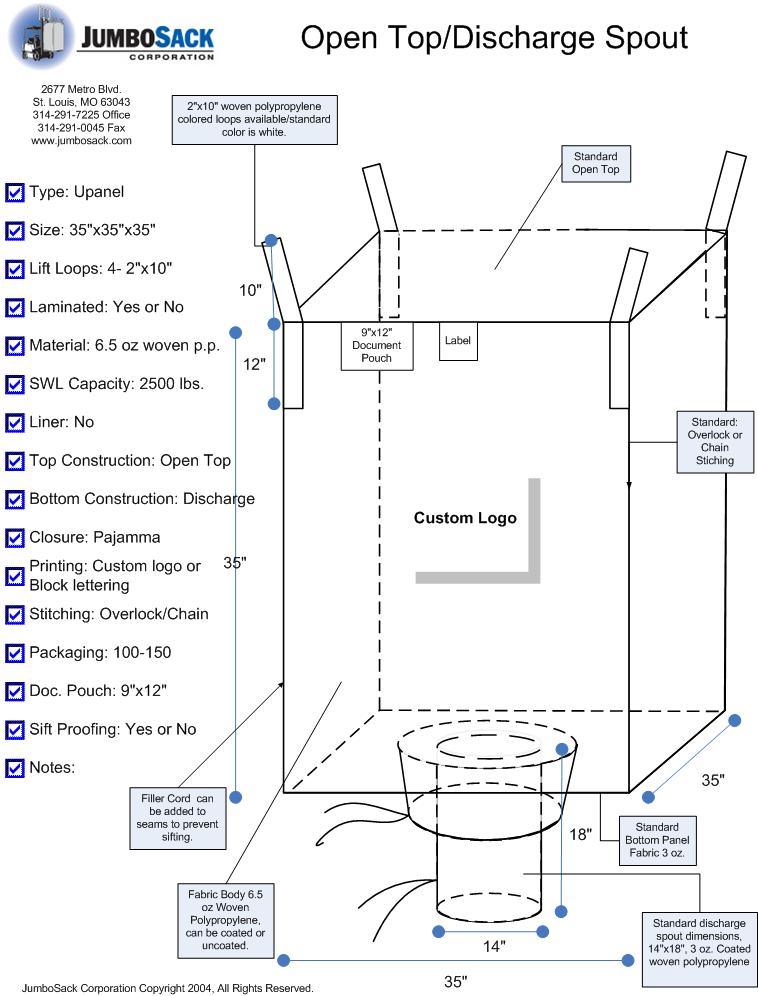

For those that haven't seen them.
Bulk_Bag.139161744_std.jpg bulk_bag_lifted__600x800_ozqj.jpg upanel_bag_otds.jpg

Those straps can and will break .. If one of four does .. It's a heck of a mess of corn all over!!!
