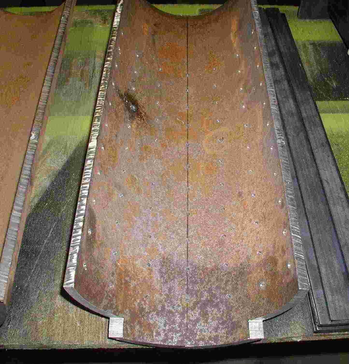

Wondering if anyone has ever come accross plans for either a forced air or boiler-type corn burning furnace?

I thinnk that would be like trying to build a 3/8 drill from scratch. The manufacturers of corn stoves know what they are doing.
   / Corn Burning Furnace #3
Gotta agree with HighBeam...you might build something and not be able to get insurance.
   / Corn Burning Furnace #4
Most insurance companies deem home built heating units as ineligible. We have to have a picture of the UL tag on wood stoves when submitting to underwriting.

I started one two weeks ago. Been planning for a year, but had other projects in the way. So here is the progress so-far. The trough is cut from 8.5" diameter 3/8" thick pipe. 3/16" diameter holes drilled for air inlet.
