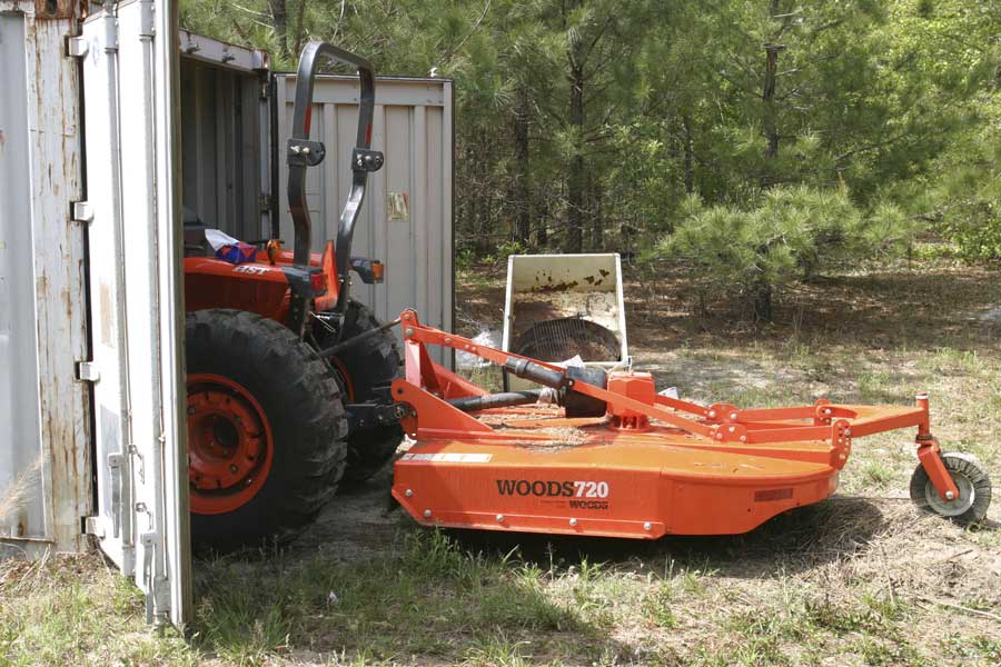

I was told by a friend that when bush hogging to run at 540 PTO rpm's (2600 engine rpms) because if I hit something the slip clutch may not actually slip at a lower rpm. I am new at this but the cutter, a Woods BB720, cuts just fine running at 300-400 rpm (1500-1800 engine rpm's).
Any advice?? Since I just have a few hours on the tractor and I was trying to vary the rpm's and not run it near wide open.

The Woods manual does not use an amount of torque but apparently tighten to a certain gap 1/16 inch as I recall. From a novice prospective I like the way the Bush Hog brand has a liftable cover vs the Woods plastic cover. I have not had time to look at it closely yet but will have some time this week to play with it. I spent the first few days moving an internal baffle so I hope the clutches are ok.
