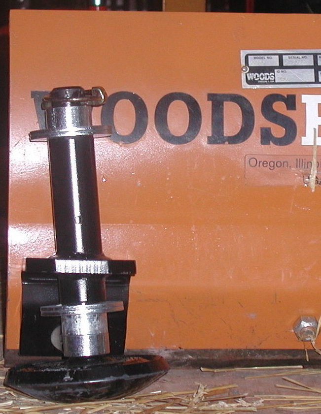

Today I installed the dealer-supplied WOODS skidshoes on my WOODS rearblade. The posts holding the shoes are angled downward toward the center of the blade. Is this the correct position or should I reverse the holders to the opposite ends so that the skidshoes angle outward near the bottom of the blade? The skimpy instruction sheet does not specify. (See photo).
Thanks in advance for your advice.

I would want them inward so they don't go past edge of blade.
When u angle blade they should be inside too.

I have the same set as you only on the 7 footer. The picture you show should be on the other side so it angles out, not in. The reason is when you are making turns you want the shoe to ride over the surface, not dig in. The way you have it it will still work but will dig down more than if it's angled outwards. You'll also find that you can make a coarse adjustment with the collars, then make really fine incremental adjustments with your top link. As you lengthen the top link it rocks the blade backwards more on to the skid shoes and increases the distance under the cutting edge. Works really well.
