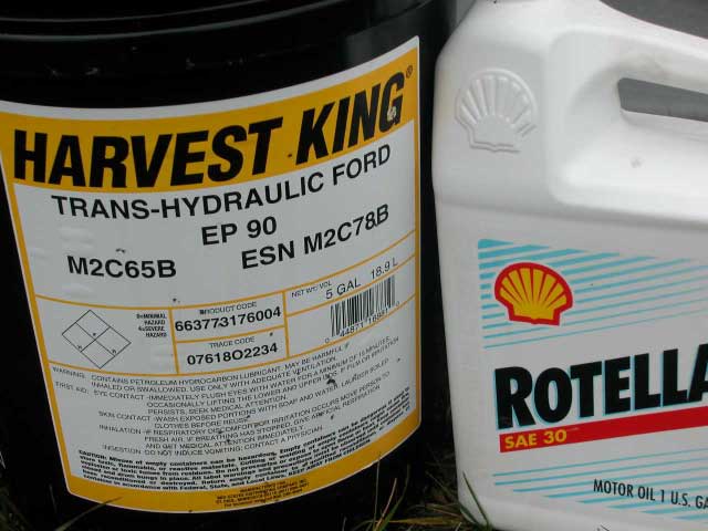

See photo of Hyd Fluid and Engine Oil I put in my 8N. I'm a beginner, so before I run the tractor much with these new fluids, I want to make sure I put in the right stuff.
Engine Oil- I put in 30W oil as most people have recommended, but am not sure if it's detergent or non-detergent from the bottle. I assumed it was detergent, but now I'm not sure. Is Rotella detergent oil?
Hyd Oil- The stuff in the photo seemed to be the closest I could find to what people recommended. Is this good stuff or should I go with something else?

What is the EP rating on that hytran oil. It looks like it is a 90wt oil.. which is about right. However, look it over.. Ideally it should be gl-1 as gl-4 and 5 may have too many sulfur compounds which may not be kind to yellow metal.
Post back.

I always use Pennzoil 30W in both of my 8N's and never had any oil consumption problems. It is a deteregent oil.
90 WT gear lube for the hydraulics, generic 5 gallon cans.
