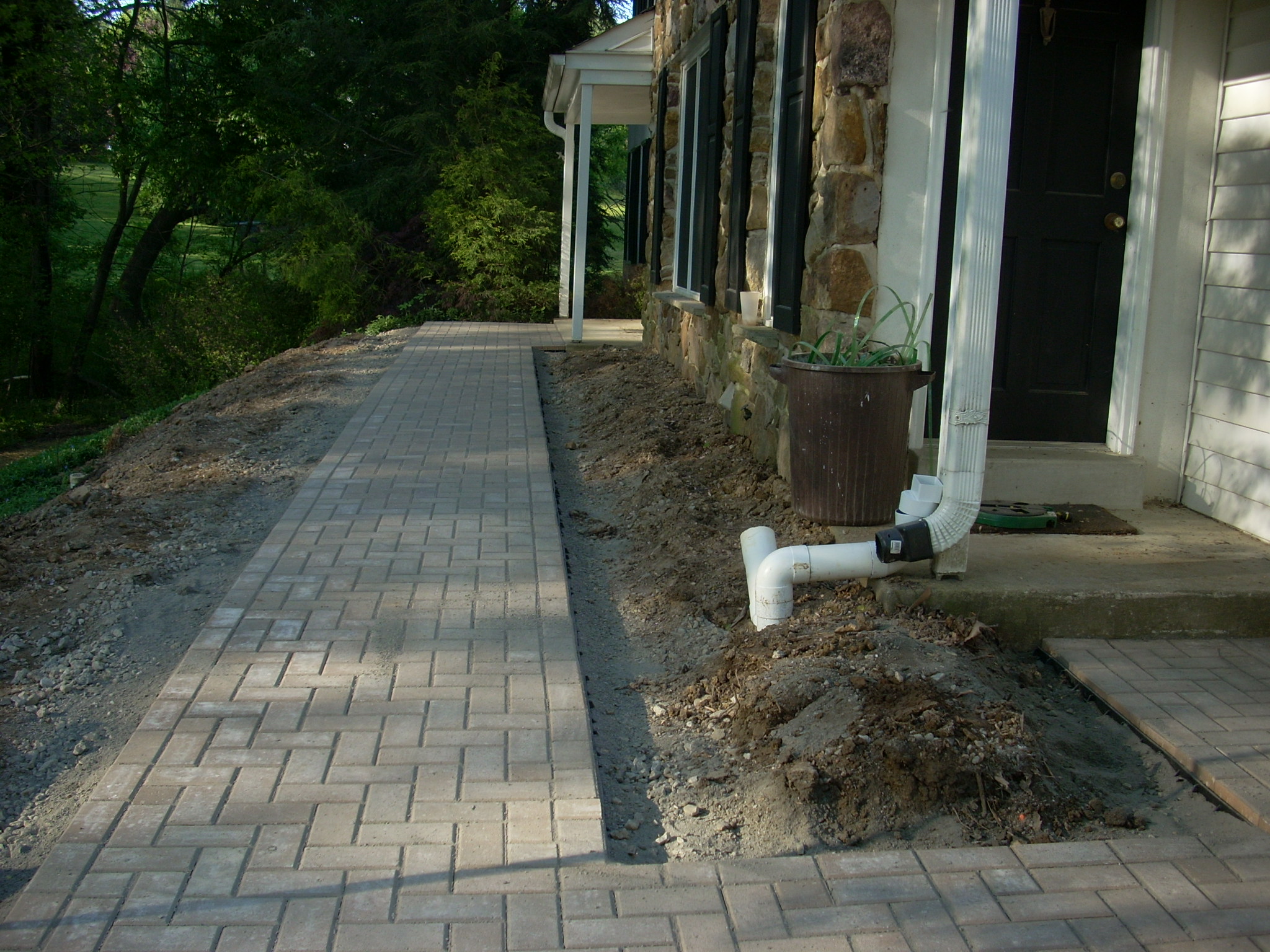

I'll go against the grain on this one (sorry). I use scedule #40 4" PVC under all compacted areas. I may be alone on this one, but I think the extra few bucks is worth it when it comes time to compact rock on top of pipe. I've dug up a lot of black flex and find it crushed down & usually clogged after years of service. Smooth pipe is also easier to unclog should it ever happen. Picture is not very good, but here's a #40 pipe going under a walkway of a house we're rebuilding for sale.
I agree, do it once.
I used schedule 35 SDR pipe from Lowe's, it's cheaper than #40 plumbing pipe and the fittings are cheaper also. It's the pale green color pipe they sell, you can also get it in 13' sections with gasket-ed collars so no glue is necessary when joining length's of pipe.
They also sell the even thinner #20 pipe that uses the same fittings as the #35 SDR pipe. Still better than the black corrugated junk.
