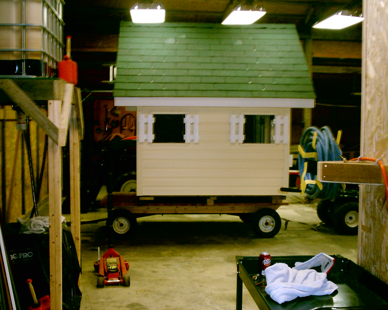

I bought a 275 gallon poly tank a few years ago and mounted it on a stand. I put a filter on it and 10' hose with fuel nozzle all from Tractor Supply. It has worked great. I had $50 in the tank, another $75 in the rest of the set up. It lives in the corner of my barn so its out of the weather. I get the local co-op to fill it twice a year and its very convenient.
As for metering the fuel, I really don't worry about it but the tank is marked in 25 gallon units and is transparent.
I like the simplicity of gravity so this is the route I went. I don't have a good pic but you can see it in this pic of a play house I made for my little ones.
