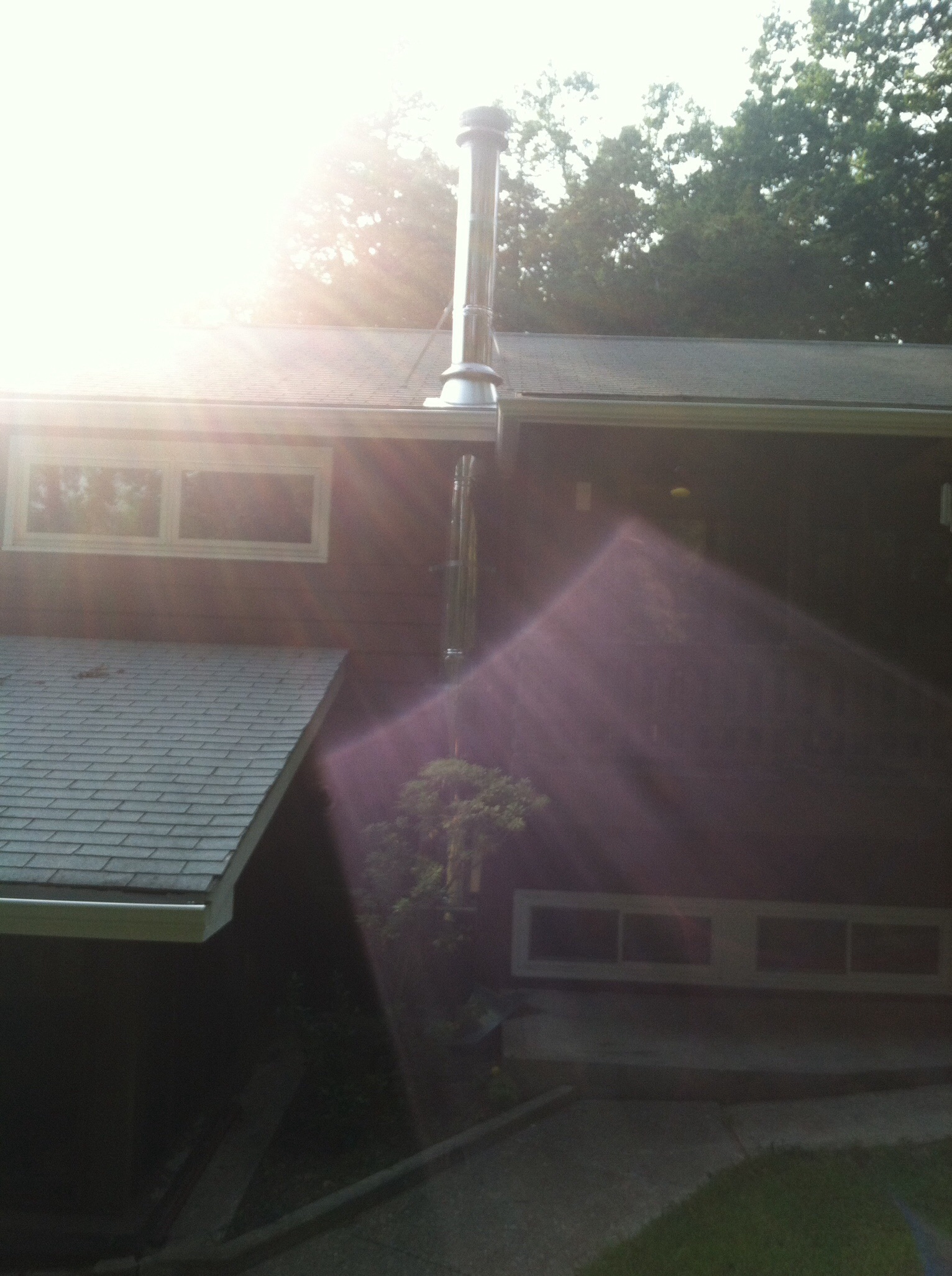

Hello,
Hey, don't feel bad.....I just got my woodstove installed in my workshop (by me) and spent a little over a $1000.00
dollars for the stove pipe. Inside the shop it is black, double wall with an air space with a 6" stainless steel liner.....the part that is in the attic is galvanized on the outside and has insulation in it (can be as close as 2" to burnable materials) and then the part that sticks out through the roof is stainless steel on the outside and insulated.
Since my shop is on the second floor and not around any vehicles (with gas in them) my insurance man says the building is covered. Even though the pipe cost me an arm and a leg, I feel that it is a very safe installation. Don't skimp on the pipe...you don't want anything burning down !!!!!! Good luck with the job !!!!!
