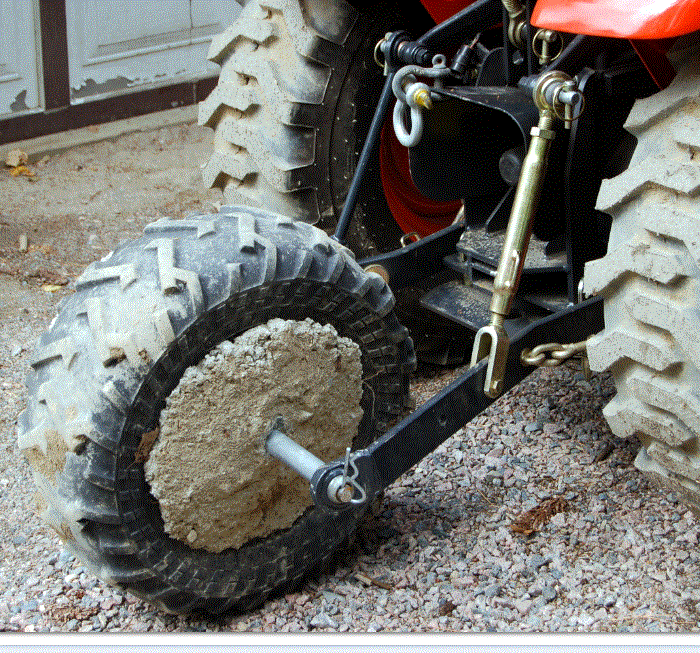

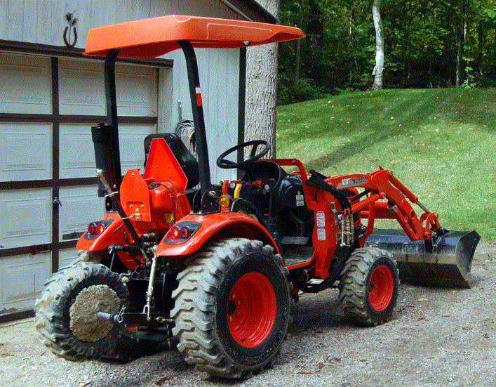

I made a counter weight from an old quad tire and an axel from my former quad. Works well and serves as a wheelie bar when on steep terrain, which I have in abundance. recently purchased a box blade which also works well when attached. Nice part of the Quad tire is it does not stick out to far thus easier to manouver in close quarters.

/ Counter Weight Suggestions #14
There is no down pressure on the 3pt. I was just wondering how it works like a weelie bar?
/ Counter Weight Suggestions #15
Dosen't actually work as a weelie bar, but it does roll if it touches down rather than digging in like a weight box would.
