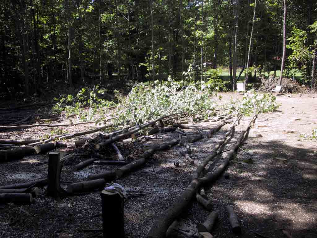

I have the tandem trailer and have found the ease with which I can back up with it to be a real advantage. I'm currently using it to haul cut firewood from a clearing in the woods I'm making for a polebarn. It's a big advantage to me to be able to back into areas to load cut wood and easily manuver in a confined space. FWIW .... YMMV.

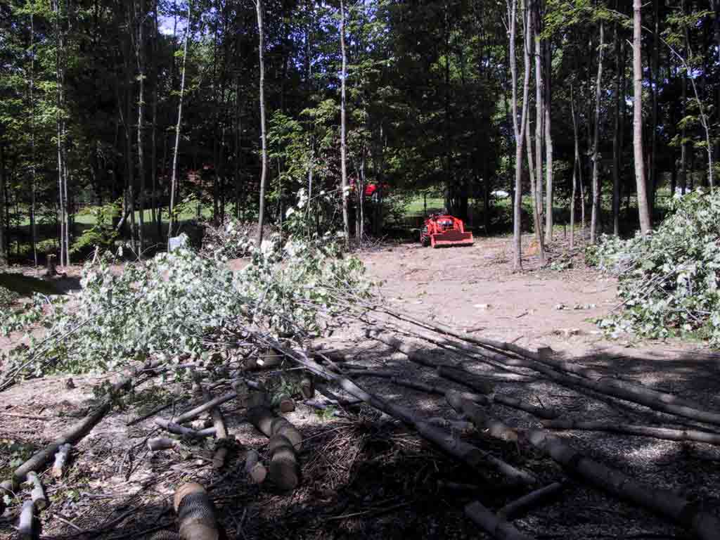

Looking back.

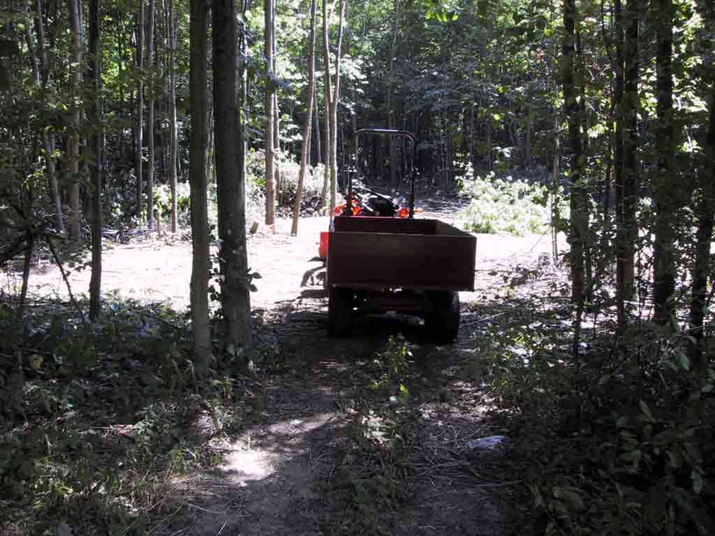

Looking southwest.
