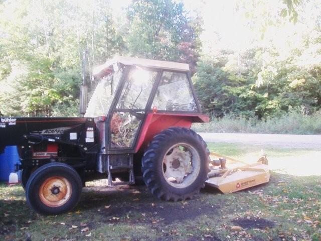

I have the six foot version made by Tarter. I use it to mow fields for my pastured poultry operation. The shell gets dinged up a bit when hitting rocks or old fence posts, however it only appears to be superficial.
