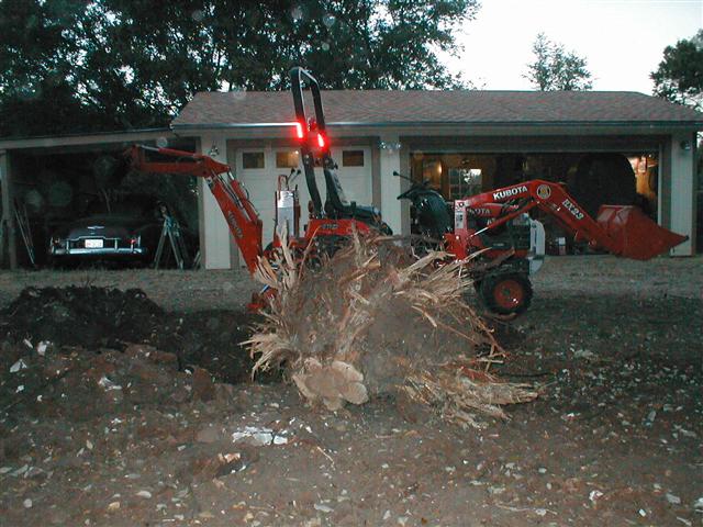

Hey bubba howdy. (buncha Tejanos here)
Jim, I can't tell what machine you have from your profile. I have dug a few Texas cedars (actually blue juniper), attached is photo of a 10" stump. I'm on creek bottom (red clay) and they tend to come up with as much rock as wood.
Pardon me, but I may use one word you don't wanna hear.
Backhoe. /forums/images/graemlins/wink.gif

   / Couple of newbie questions on stumps and rakes #7
Well, I think that rdsaustintx has given you a wonderful example of the size of the problem you are facing. A few inches across above ground and a few feet across below!
